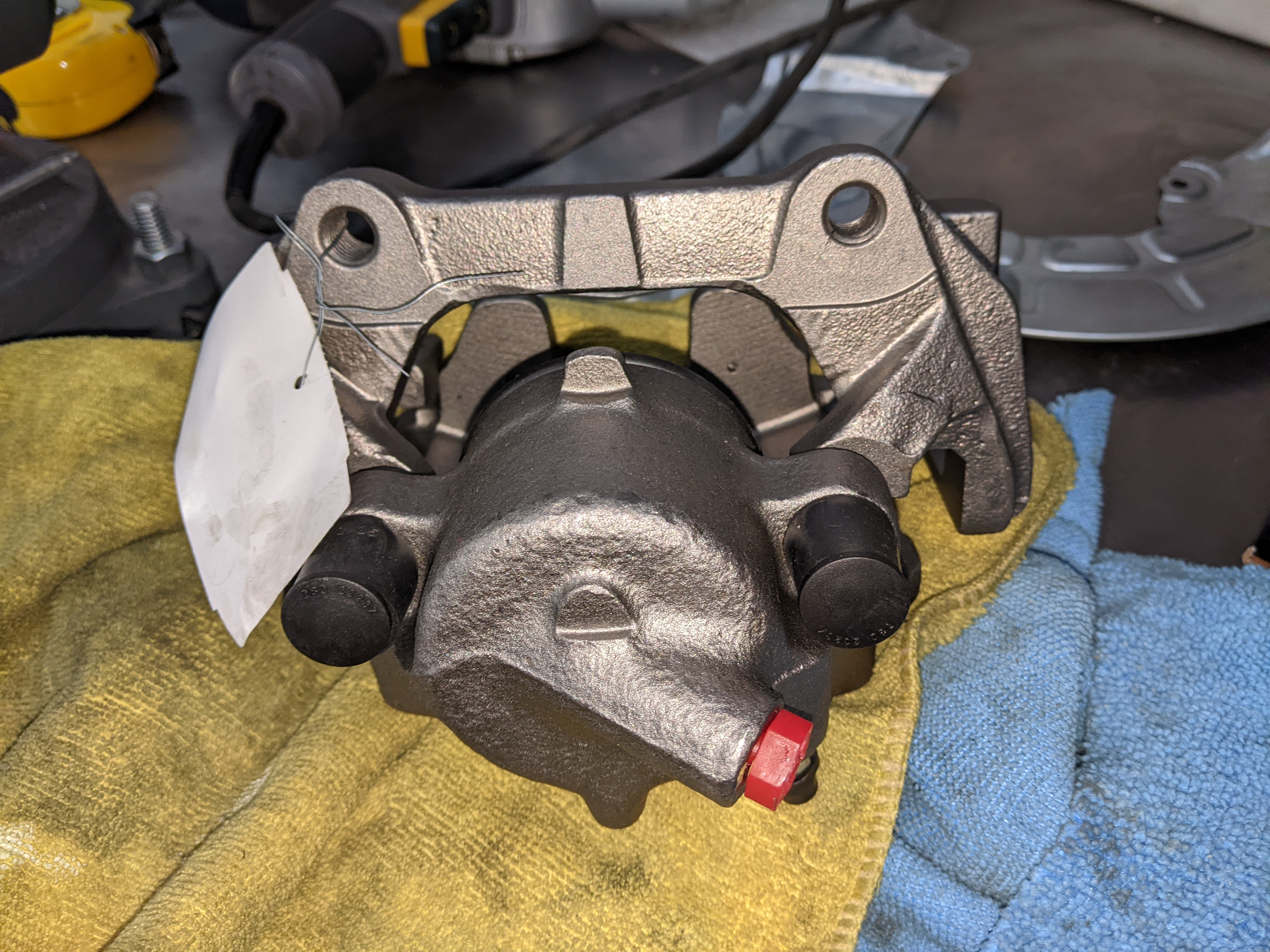

Started prep for the front caliper bracket and brake dust shield swap on the 'R'. Calipers finally arrived at NAPA from the US. On first look over they are typical re-built units. These came with the refurbished 302mm caliper brackets which I needed.
The calipers themselves are going into the 'stash' as the current ones are still good. I will seal them in bags with some desiccant bags to try to prevent rusting in storage and degradation of the rubber parts.

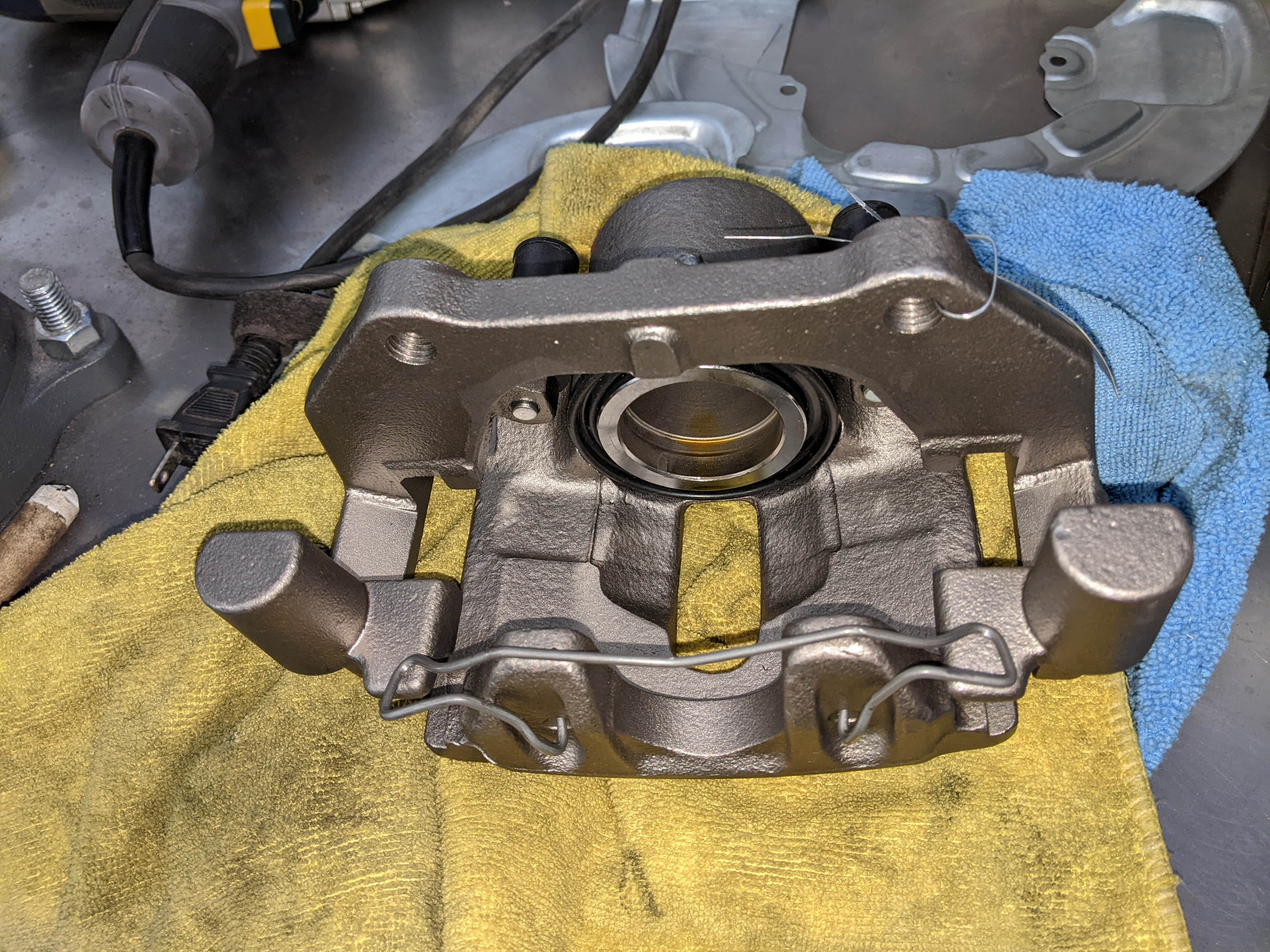

I looked the calipers and bracket over and would say this. The slider pins are typical cheap aftermarket items and will be returned with the cores. I'll keep the still good OE parts.
Pistons look like new steel items, but hard to tell how they will last. I would call them 'builder grade' parts, and not high end. Rubber caliper slider covers are the typical aftermarket cheap rubber units with plastic caps. They are functional but not sure how they will hold up. I do have some good OE items in the stash so may swap them over in the future if/when I need to install the calipers.
The brake pad retainer looks fairly 'beefy' so add those to the stash. I don't normally return those with the cores. Should you?
The parts look like the usual cleaned and painted re-built items. Not sure if the coating is powder coating or paint of some sort. I guess use will tell on that point. I will see how the brackets hold up next year. If they start to rust I will remove and paint them again. RH caliper shown below. LH has a '1' on the end of the part number instead of the '2'.

That caliper looks identical to the Cardone ones I got from FCP for Geronimo. Same box (but with NAPA/Cardone label), white plastic tag with metal wire, red fitting cap, black retained bleeder cap (which gets in the way). I think mine are simply painted. I didn't see rust breaking through like on two of the four Volvo brand ones I bought, but those were powder and clear coated.
For rust prevention, I had my new calipers professionally stripped of coating in rust in a chemical bath, sand blasted, powder coated, and clear coated. The Volvo calipers were so terribly coated with rust breaking through and they have been for the last six or seven calipers I've bought, all failing due to rust. I'm trying the break that cycle.
Are you going to pay the core charge to not return your still good calipers and presumably bad brackets? If the brackets are the right shape but just rusty, consider professional stripping, blasting, and coating so you know they're perfect. May require filing the pad ear grooves first to ensure there flat.
