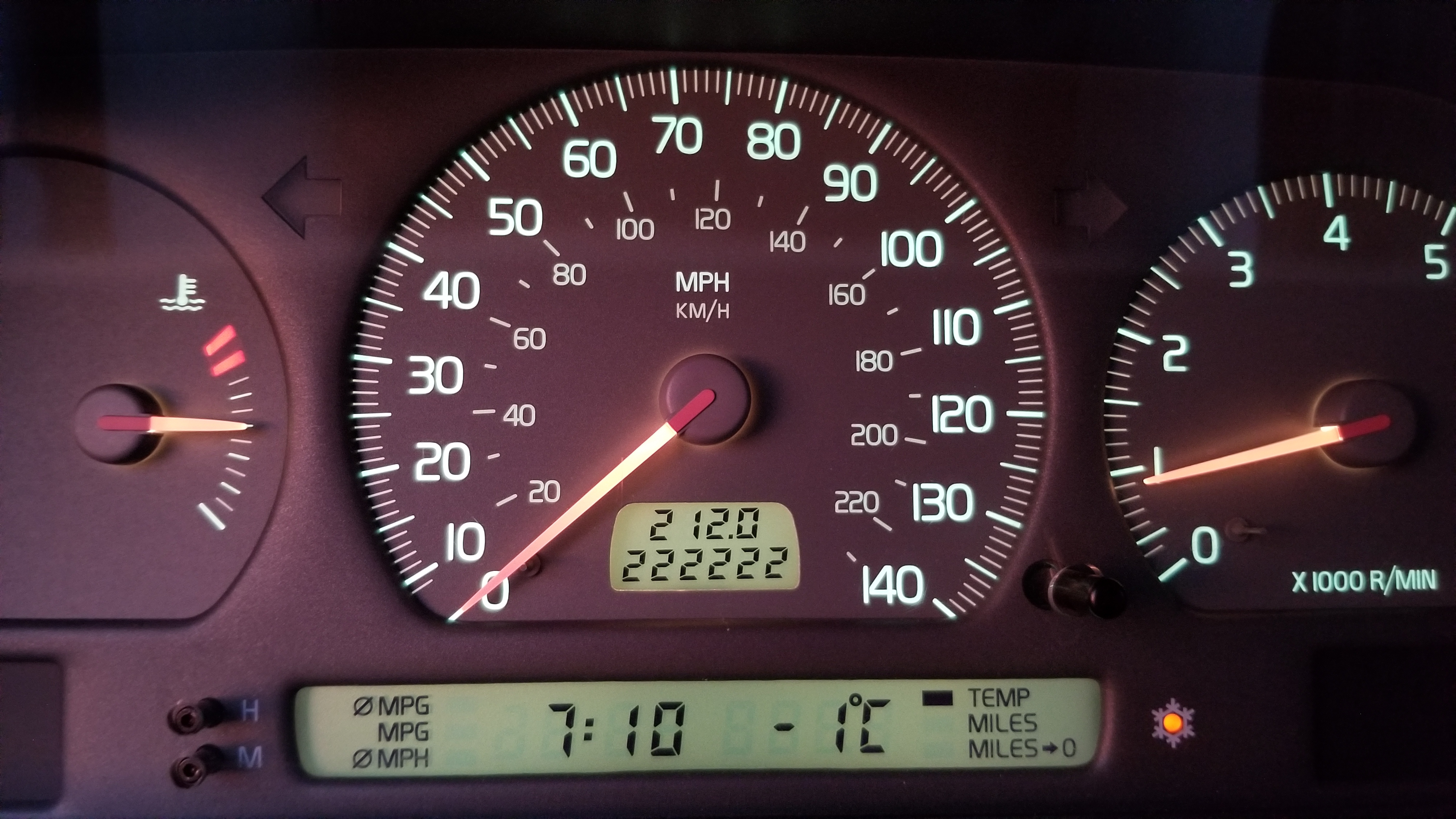

I made a new wiring harness for the driving lights in my daughters 850 to replace the cheap components that came with the lights. One of the connectors inside one light had shorted and melted and caused the fuse to blow. Also installed a brand new Interstate battery.
This is all in preparation for her upcoming road trip to PA and then her final semester in Boston where she needs the car for commuting.
This morning I had a fun commute to work with a beautiful sunrise and an odometer "milestone" moment.

How did you get your US DIM to dispay in Celsius??850 LPT wrote: ↑27 Dec 2021, 06:57 I made a new wiring harness for the driving lights in my daughters 850 to replace the cheap components that came with the lights. One of the connectors inside one light had shorted and melted and caused the fuse to blow. Also installed a brand new Interstate battery.

Hi Steve, when you press the two clock buttons you get to choose between four settings/ combinations for clock and temp display. You can change the clock to 12 hour to 24 hour format and temp in Fahrenheit or Celsius. This works for all P80. You have to press the buttons at the same time for a second or two and it's a little finicky, but you can cycle through the options that way.abscate wrote: ↑27 Dec 2021, 10:57How did you get your US DIM to dispay in Celsius??850 LPT wrote: ↑27 Dec 2021, 06:57 I made a new wiring harness for the driving lights in my daughters 850 to replace the cheap components that came with the lights. One of the connectors inside one light had shorted and melted and caused the fuse to blow. Also installed a brand new Interstate battery.
