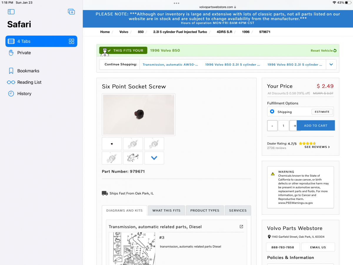

Well even though I'm soooo close to having this engine rebuild / install wrapped up, I've decided to take a little bit longer and replace the transaxle seal at the trans while I have everything jacked up and sitting there. It looks pretty straight forward - should be able to keep everything together as a unit and pull it out. I'm also going to go ahead and replace the torque converter torx bolts; I don't feel that I can get the proper torque with the old ones ( maybe I got 25ftlbs, plus loctite, instead of 30 ), and if I did, then they might strip whenever they might need to be removed in the future. But I haven't found those bolts on Volvopartsweb, FCP or IPD. Any idea where I can get them ? Part number ? I thought they'd be readily available since I think they are meant to be replaced anyway.

They were well hidden on Volvo web store , I remember. I think they are in the transmission section
Do you want flex plate to crank bolts
Or
Flex plate to torque converter bolts ?

979671 above.
