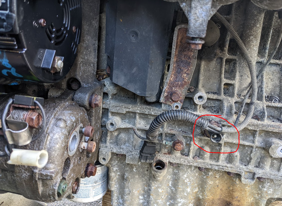

Post by wizechatmgr »
The one thick power connector with the gray end looked like it was to an aux. air pump for cold starts. That also has a vac purge line I think that hooks under the battery tray if I am remembering correctly. I've got a 98 base NA as one of my cars so, may or may not be the same on the 850. The other possibility is that's to the radiator fan, but I don't think it would go that far down from where it should be without some cutting of the harness. The round one I believe is for the oil pressure sensor, but don't quote me on it. @Abscate may have pictures from when I had my engine out. I'll look though mine.
Oil pressure sensor:
