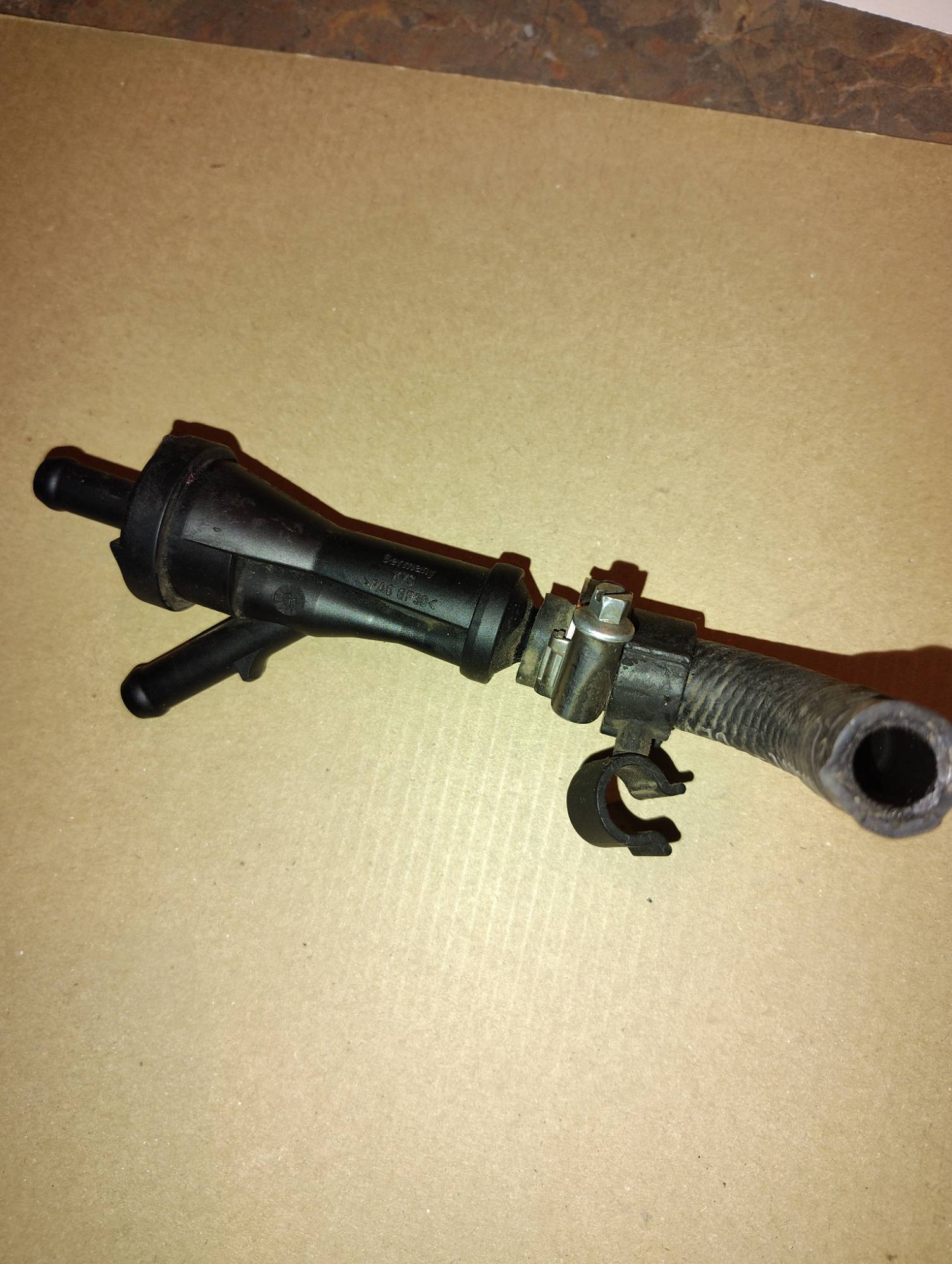

I'm trying to find a home for this piece. Does it maybe connect to the nipple on the end of the intake ? What connects to it ?
1999 V70 GLT
1999 V70 GLT
- Posts: 36171
- Has thanked: 1613 times
- Been thanked: 4077 times

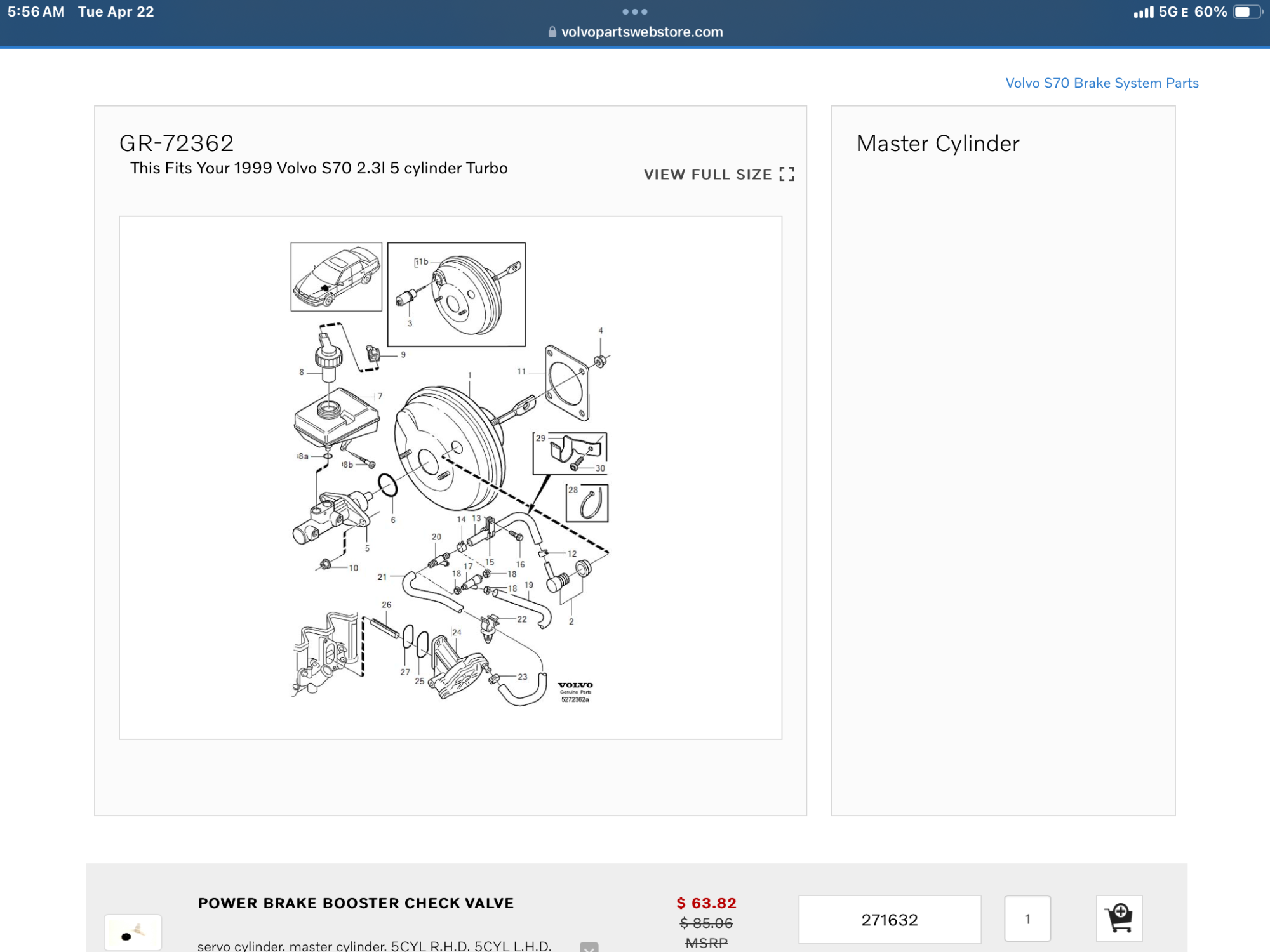

Can’t remember the Volvo name for it, “ ejector” I think, but it’s a Brake vacuum booster.
Fat end onto the fat nipple on the driver side of intake manifold. The other nipple goes back to the brake booster
There is a smaller 8 mm or so thick hose that plugs into the angled part and ??? I can’t remember ( it’s not on the T5, only the LPT )
It’s part 17 in this diagram
*** warning , this diagram isn’t right on the other end connector, not sure what’s going on there. Looks like a diesel application ***
