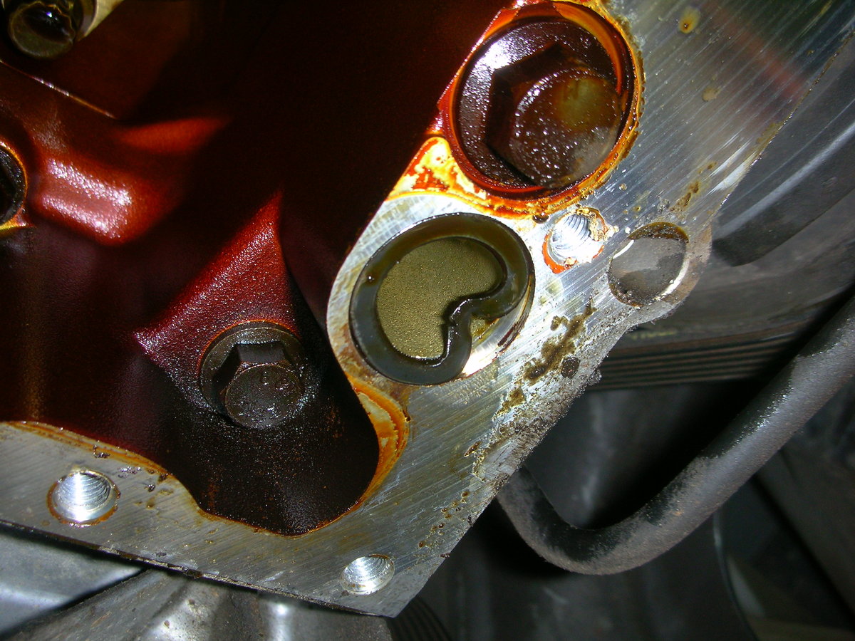

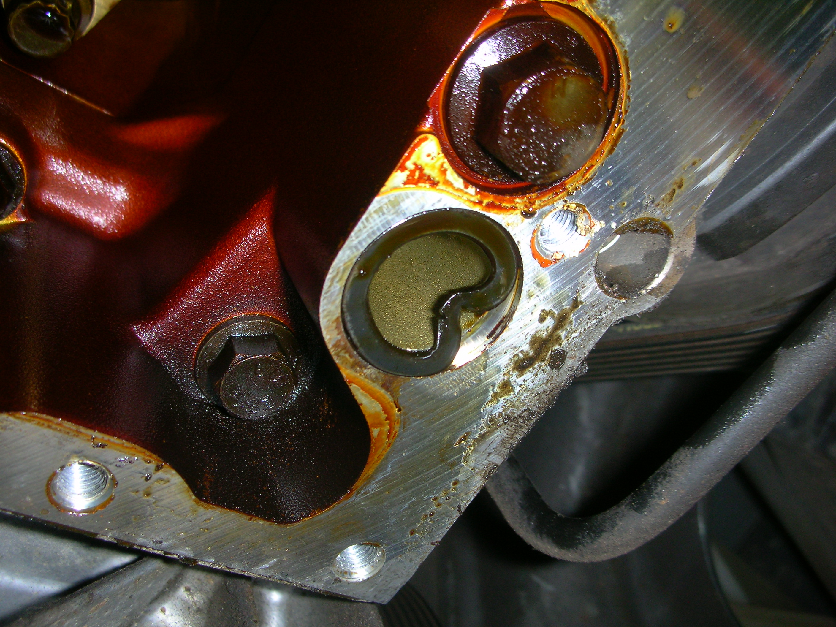

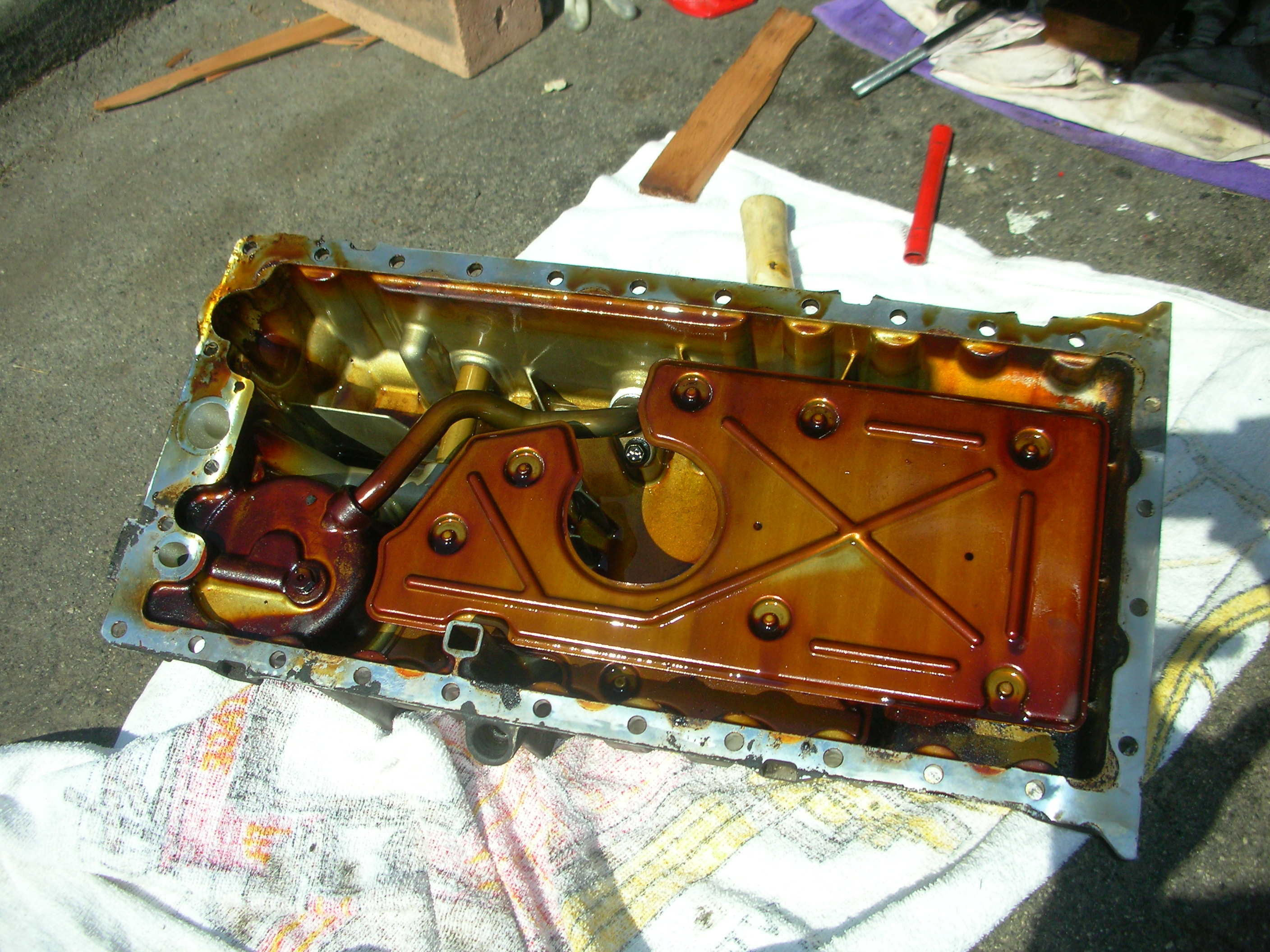

Doesn't look bad! Pretty clean for nearly 150K.

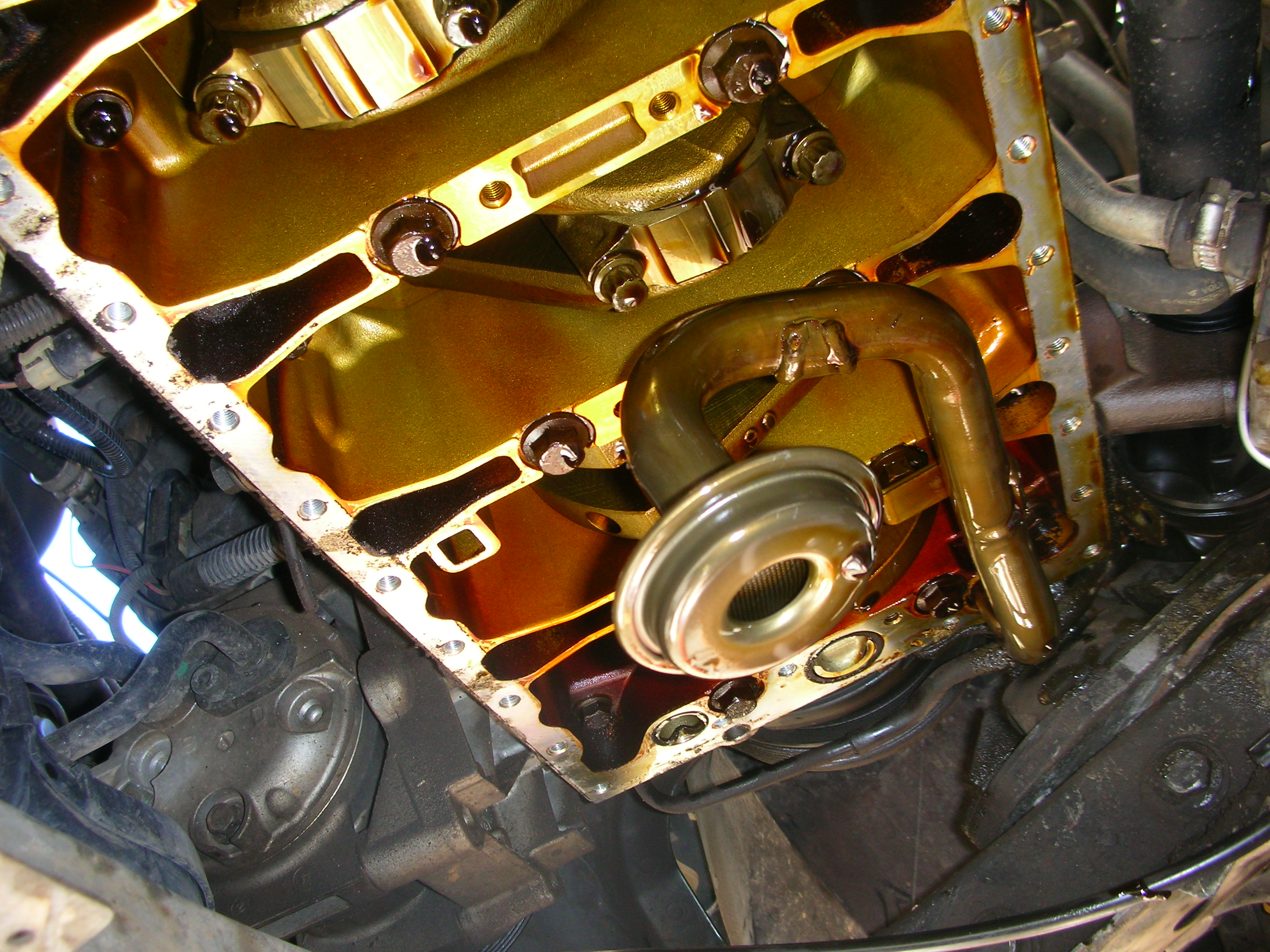

The block:
And this sure looks like trouble! Am I right?

You are right !!!!!!!!!!!
Congratulations !!!!!!!!!!!!!!!!!!!!!!!!
Can you please post lots of pics Please include the mount and how you supported the engine.
