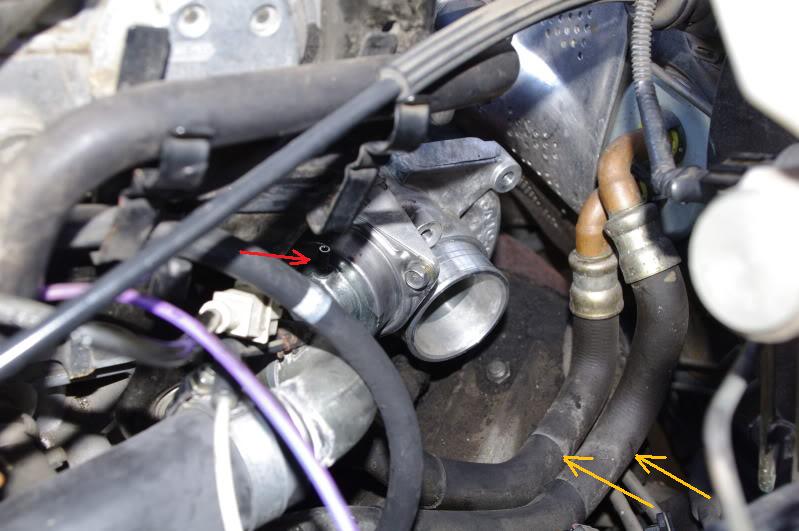

I found a good photo of a 98 S70 GLT turbo on this forum.
The red arrow identifies the port with the broken off vacuum hose with clamp. The yellow arrows identify the heater hoses that contain extensions that coil around the turbo. I'm afraid that heat from the turbo will melt the hoses in contact with it. I don't remember having the copper pipes in the photo that connect at the firewall.

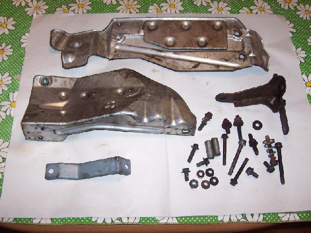

I layed out what I think are heat shield related parts on the breakfast table.

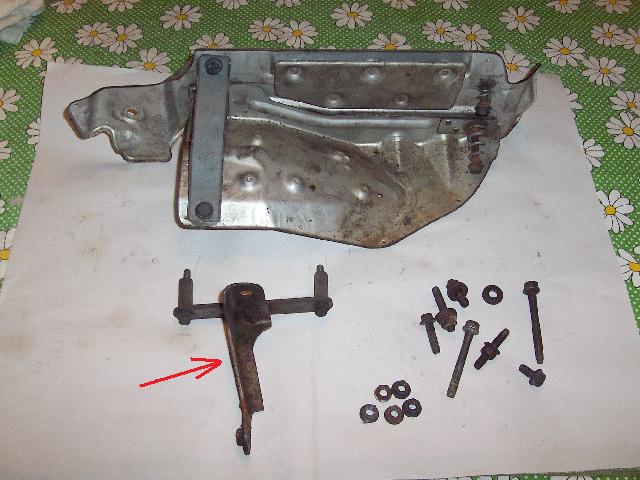

Using VADIS I was able to practice assemble the heat shields.
According to VADIS the bracket identified with the red arrow appears to mount to the exhaust manifold below the heat shields. However, I don't remember anything near the firewall for the aft end of the bracket to connect to. I haven't been able to find a photo of the installed bracket on the forum for reference.
