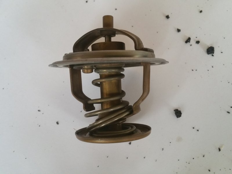

I had heard rumours of Wahler quality slipping only to find out for myself that this is the case.
The photo below shows a new thermostat that had covered the measly distance of about 250kms on my T5 2001 V70. The result was a blown head gasket.

That is definitely infant mortality failure, I would be mad! I thought they fail safe?precopster wrote:I had heard rumours of Wahler quality slipping only to find out for myself that this is the case.

I religiously use and recommend Wahler for Volvo. I've pulled many Wahlers from service without spotting breakage and replaced them with new to be safe.
That particular break point seizes the assembly in a closed position; no fail safe.

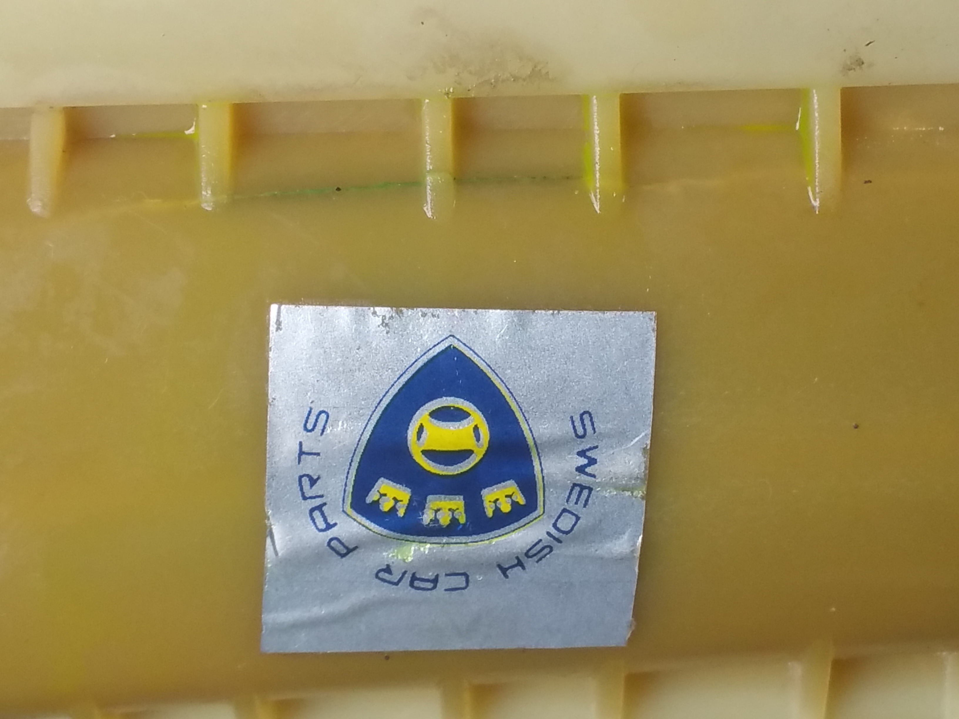

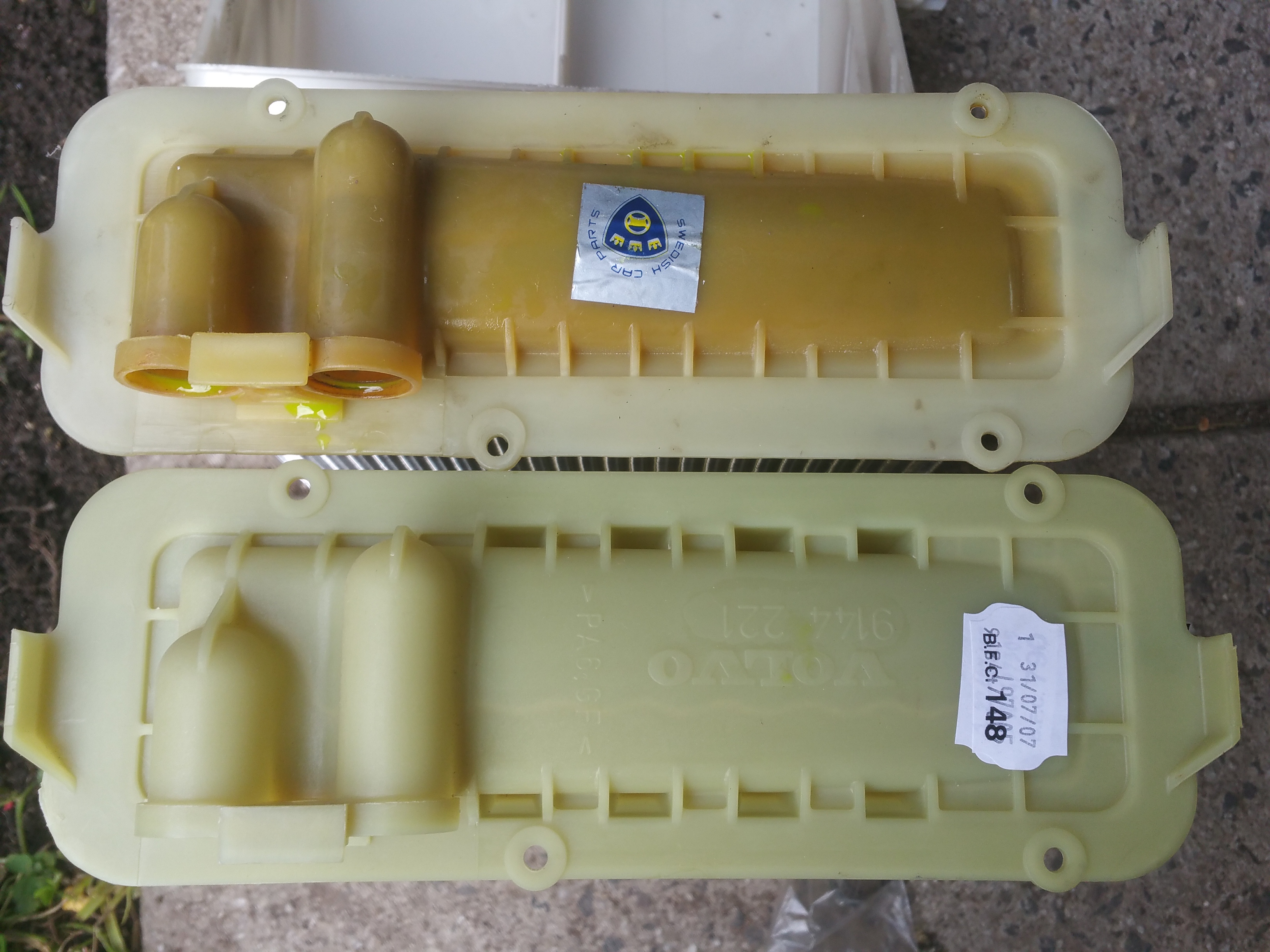

And yet another out of the norm breakage of a Swedish Car Parts heater core in my 2000 V70 after only around 60,000kms and only 2.5 years, .
The base of the heater core cracked just like a cheap aftermarket unit.
Here's a Genuine Volvo core to compare:
