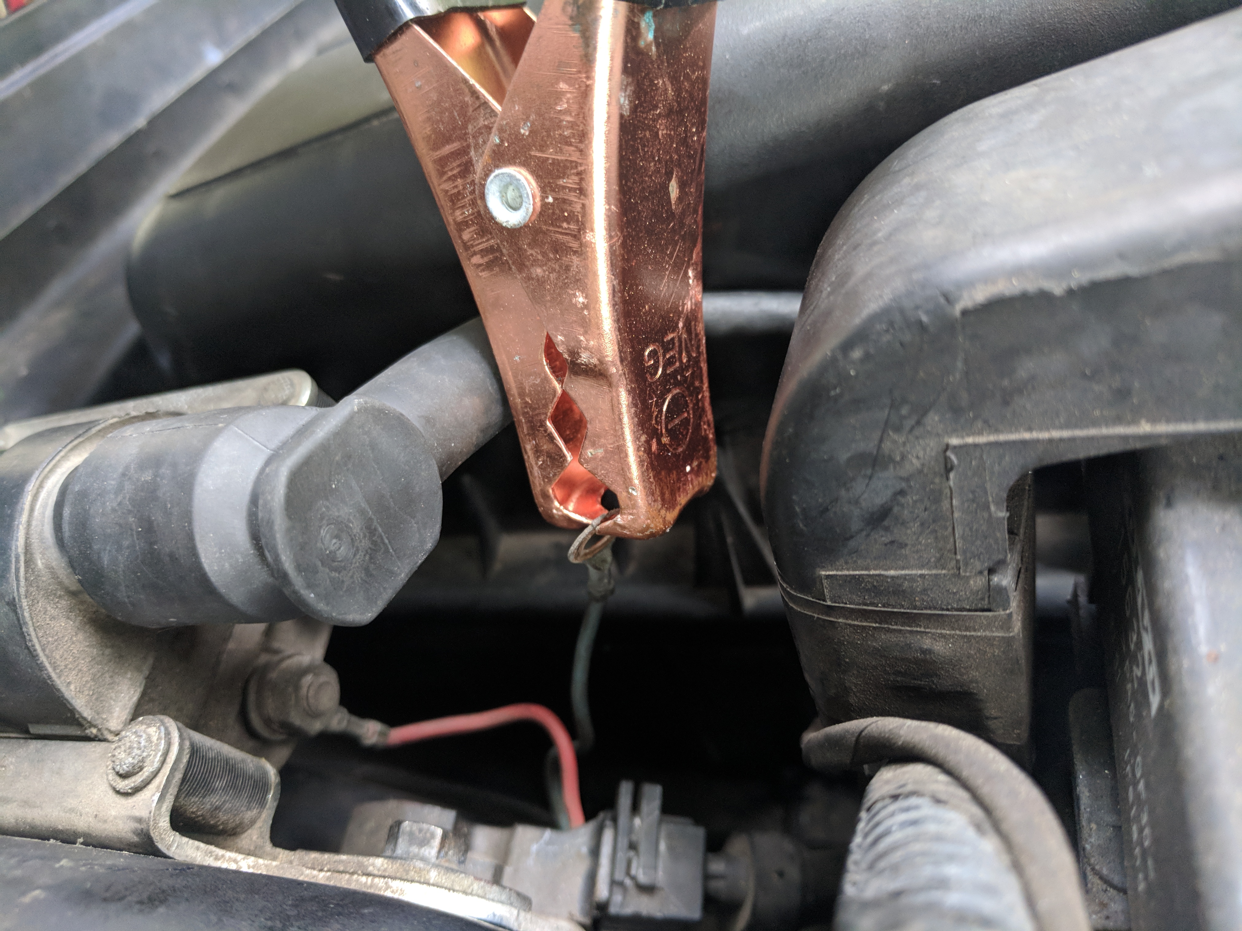

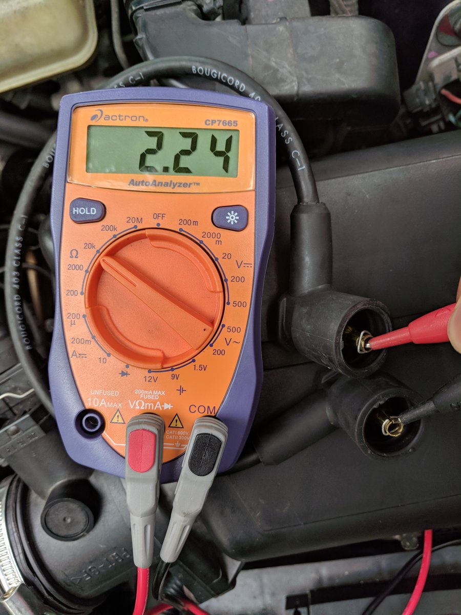

dj_v70 wrote: 13 Jul 2018, 18:31
Take any wire and connect negative side of coil to ground. Just touch it quickly, don't leave it there. Leaving it there for a long time could kill your coil.
Did you check resistance of the wire between spark plug and coil? It should be < 10kohms.

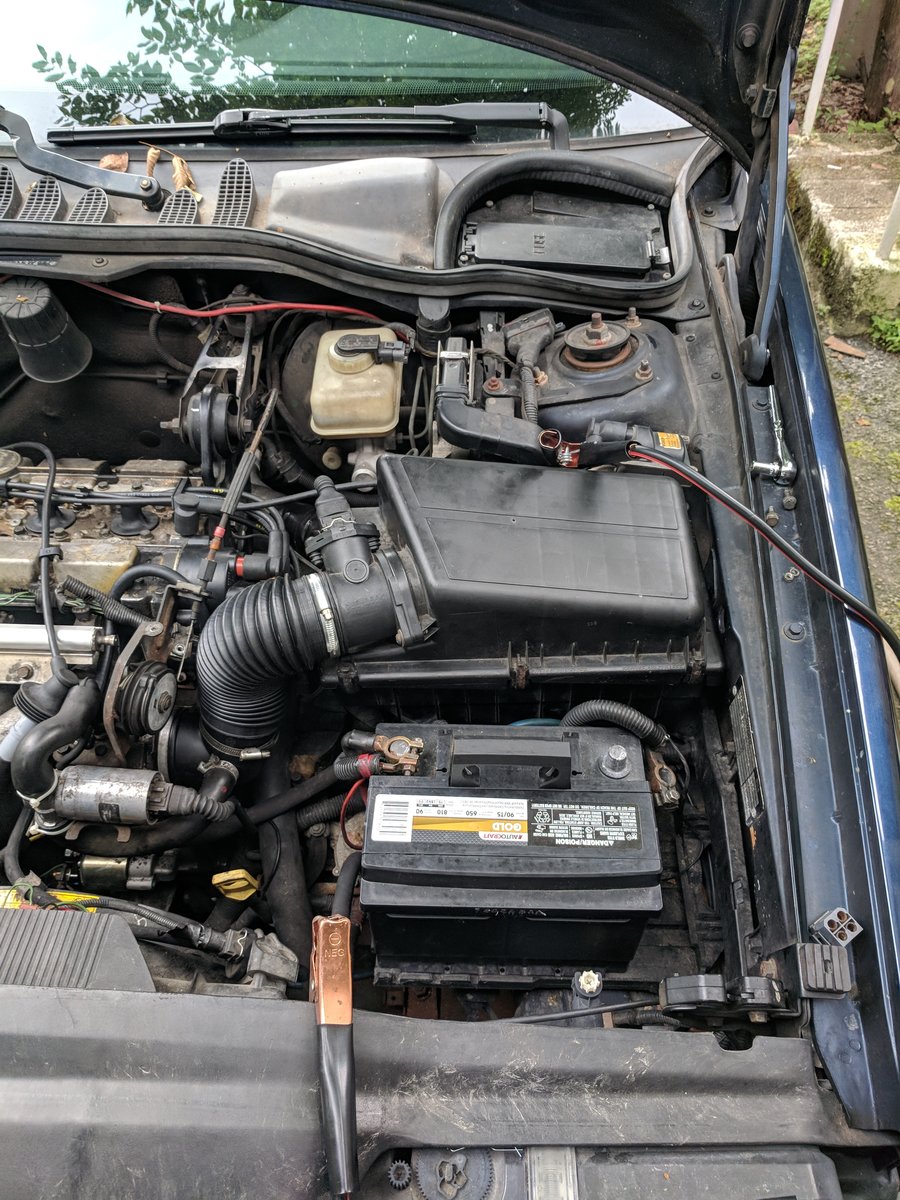

I tried it, but got no sounds or sparks of any sort. Here's some pics from the setup.
I grounded it hovering about less than a centimeter from the engine block, and then used the other end of the jumper cable to tap the negative and then positive end of the battery...
Yes, I did check the resistance of the wires. I also took pictures of that... Safe to assume that's not the issue...
