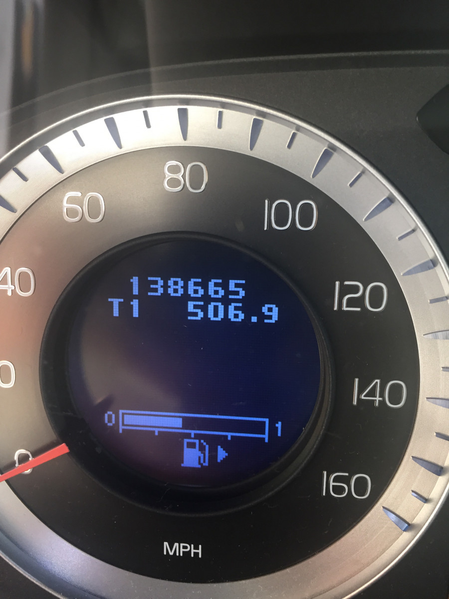

Here is the Odometer reading
My S80 is running extremely well

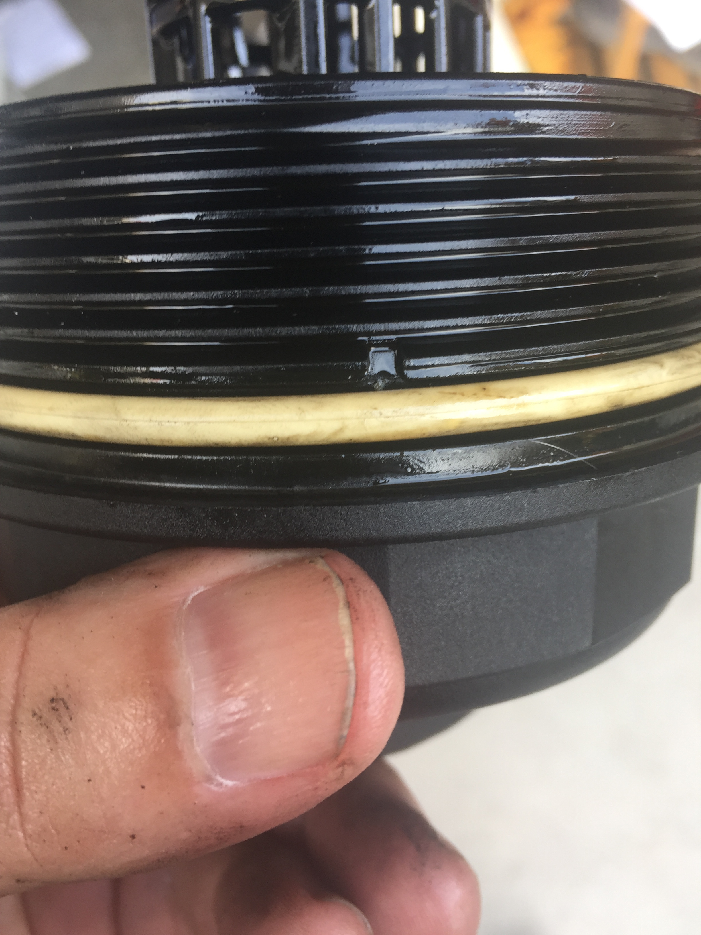

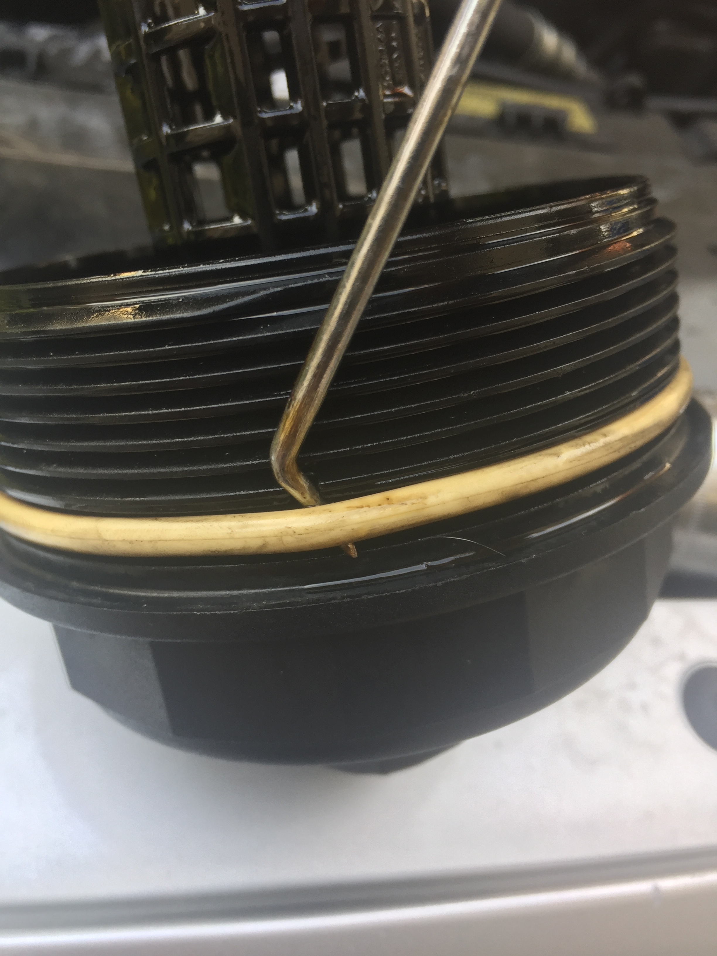

I also noticed that Volvo included a notch in the plastic cap for the oil filter. The notch is there to make removing the O-ring easier (I assume).
Here is a picture showing how I used the notch
Thanks
Paul
