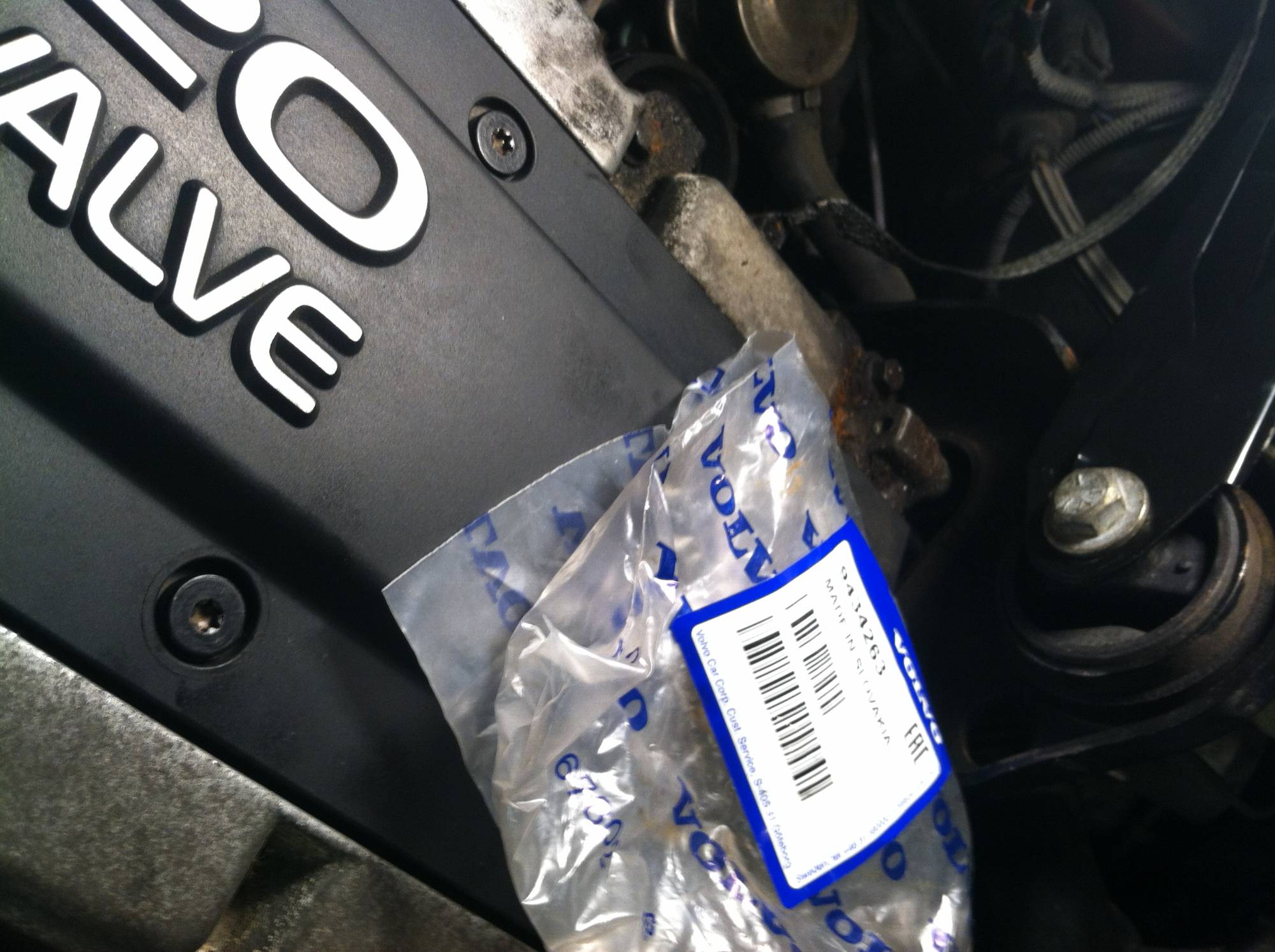

Did combat with the torque rod bushing, 9434263. After intense negotiations, and finishing with the Large Hammer, it yielded.
And the warning Robert sent out some time ago still holds true; the Meyle bushing is too small, and rattles around in the bracket.
