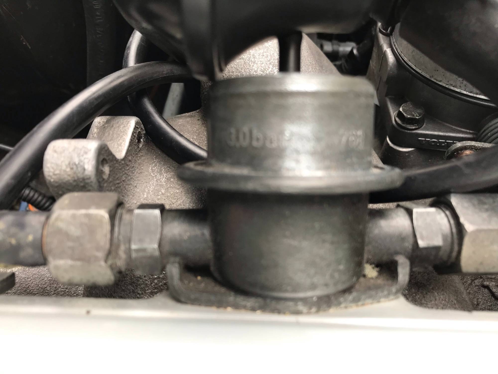

I have been searching for a fuel pump regulator (that does work) for the B6304f white block.
Apparently the OEM regulator is unavailable now. I'm skeptical of buying one from eBay, as I haven't had good results with some parts I have bought from there.
Photo of regulator:
this is the original- it has 274K miles of usage. about time to be replaced, I think.??

Crazy that isn’t more of a generic universal part.

I suspect, but do not know for sure, that the failure of the fuel pressure regulator happens when the rubber diaphragm leaks. You could test with hand vacuum pump. If it leaks down after pulling vacuum, it would be bad.
With this test, you could easily test one before you buy at salvage yard.
