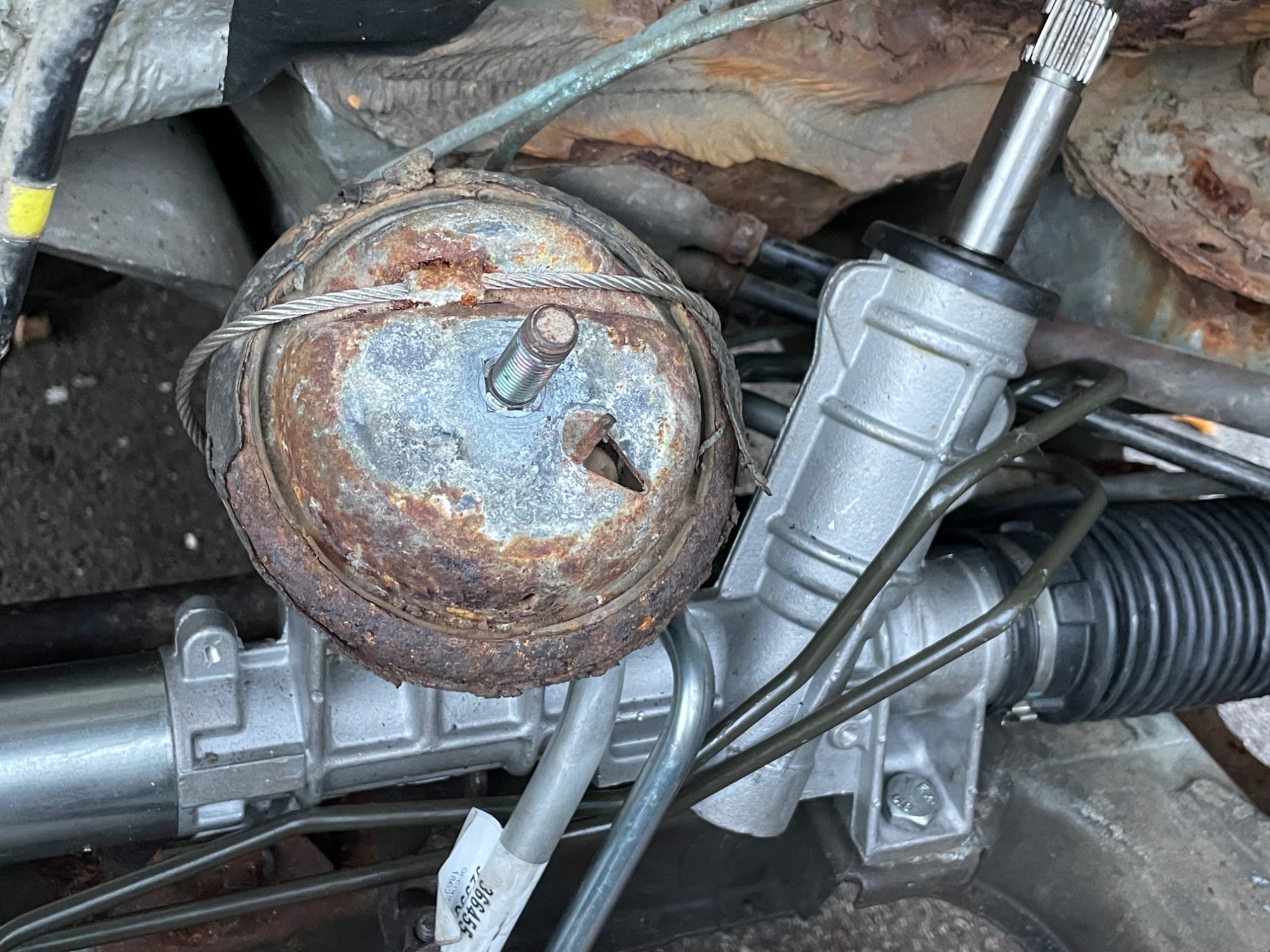

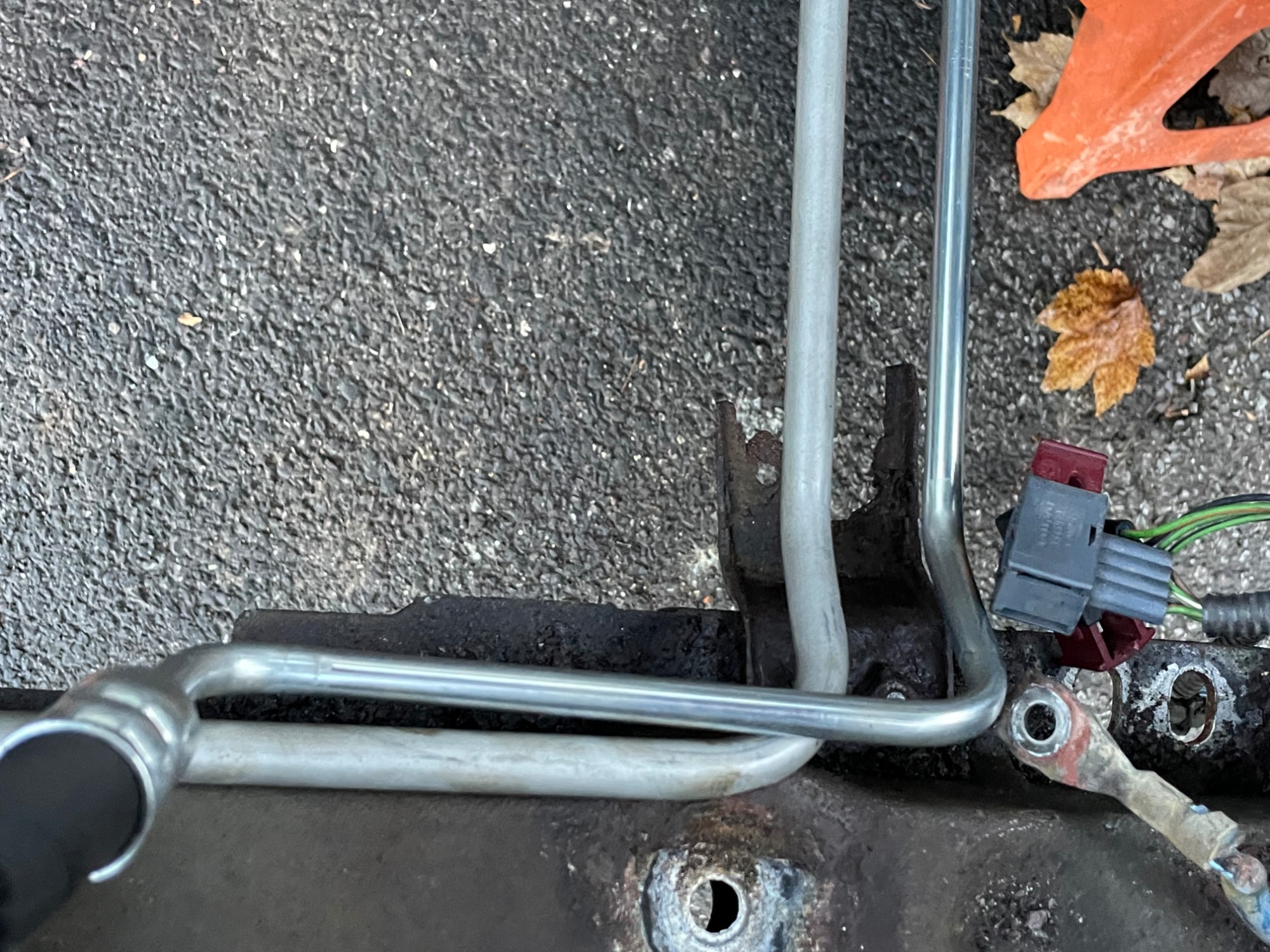

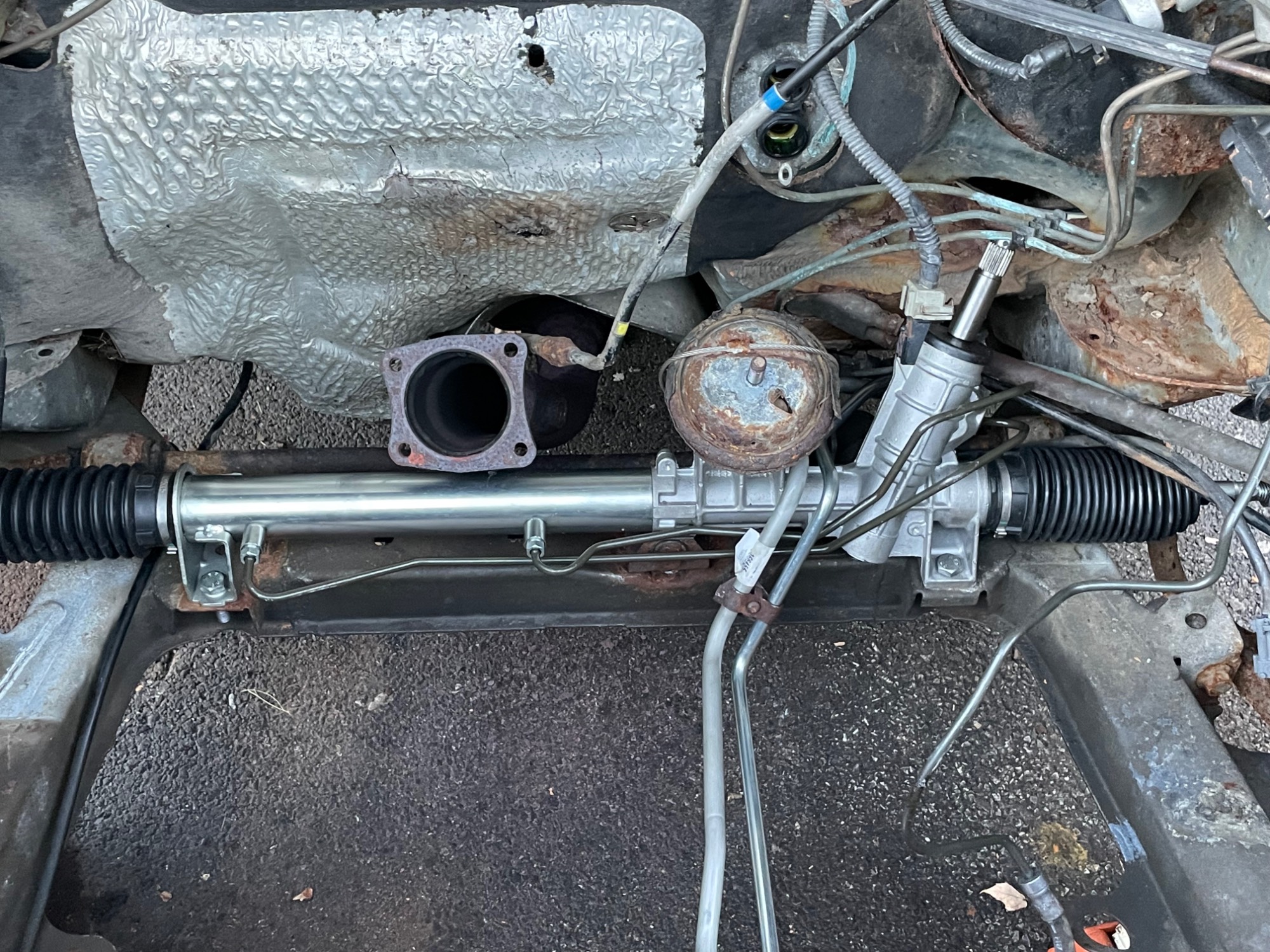

We fought and slayed the dragon of transfer of PS rack parts…
Aluminum heat plate
Center mount
Left plate mount
Installed , mounted, then tightened the ps lines with engine out. I needed crows feet to do this , even with the engine out.

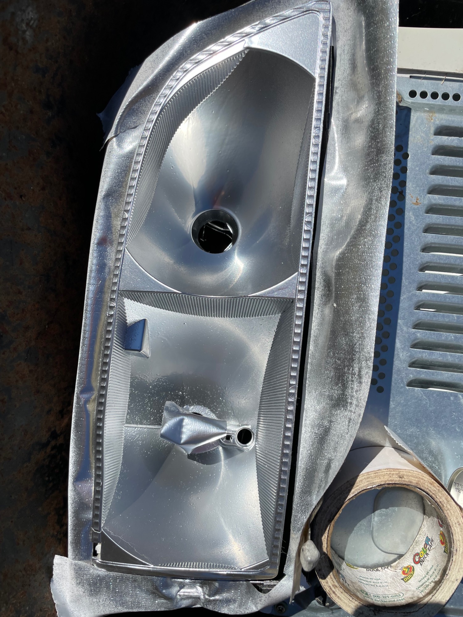

Also managed to coat a headlight reflector with rustoleum silver, at least visible success.

Well well.. is that reflector usable how now?abscate wrote: ↑04 Nov 2022, 02:17 We fought and slayed the dragon of transfer of PS rack parts…

I mean i have similar project ahead as last time inspector did scare me buy new headlight assemblies which i want prevent as Volvo made these super good easy work on.
And been looking out that chrome paint is nah.. only good would be aluminium coating on there like form the factory(?) but this is kinda hard in home to do.. then been looking alternatives and silver too is been one.. if any good result ones out there i am listening. Plus i am cheapskate.. but i rather still go in quality. Having bank account just under 20 bucks right now its too one reason

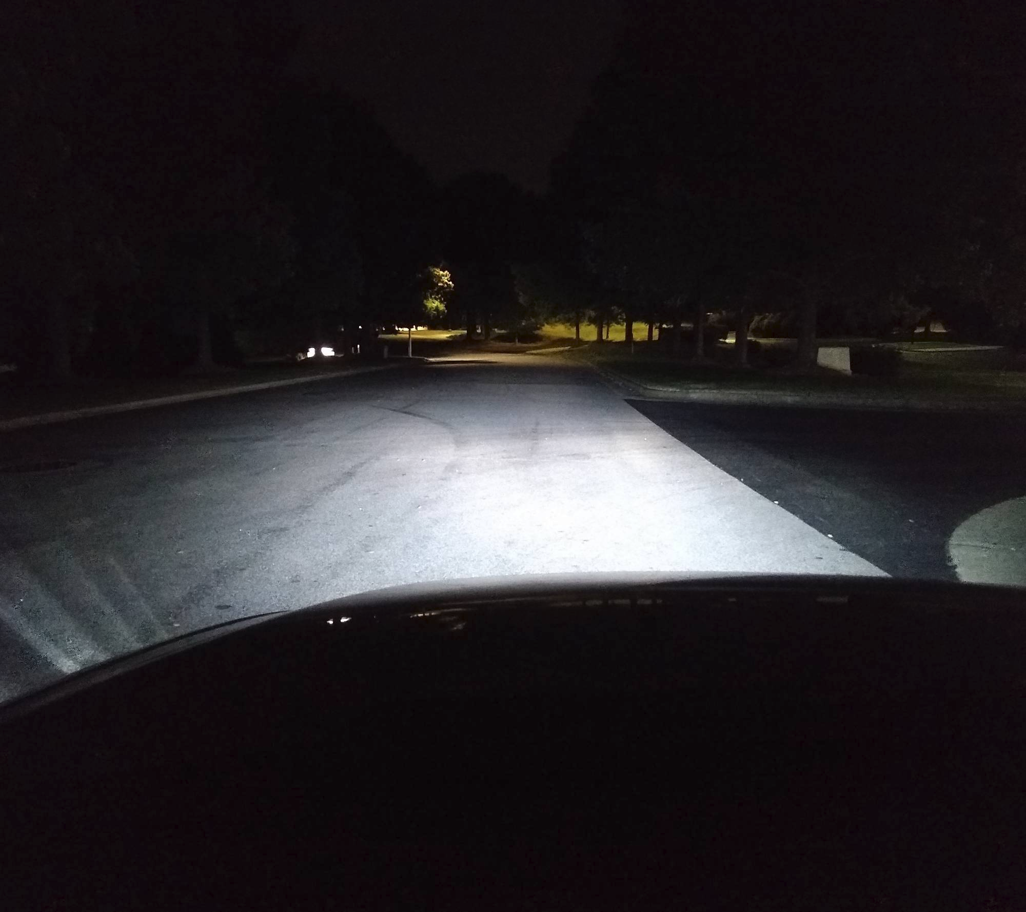

It worked well enough with some inexpensive LEDS but not sure about Halogens. Much better than I had hope seeing I did this in 2012 with an 98 S70 T5 and the results were just nah for sure, though a different paint. You can also remove that center piece in the low beam if using LEDS.

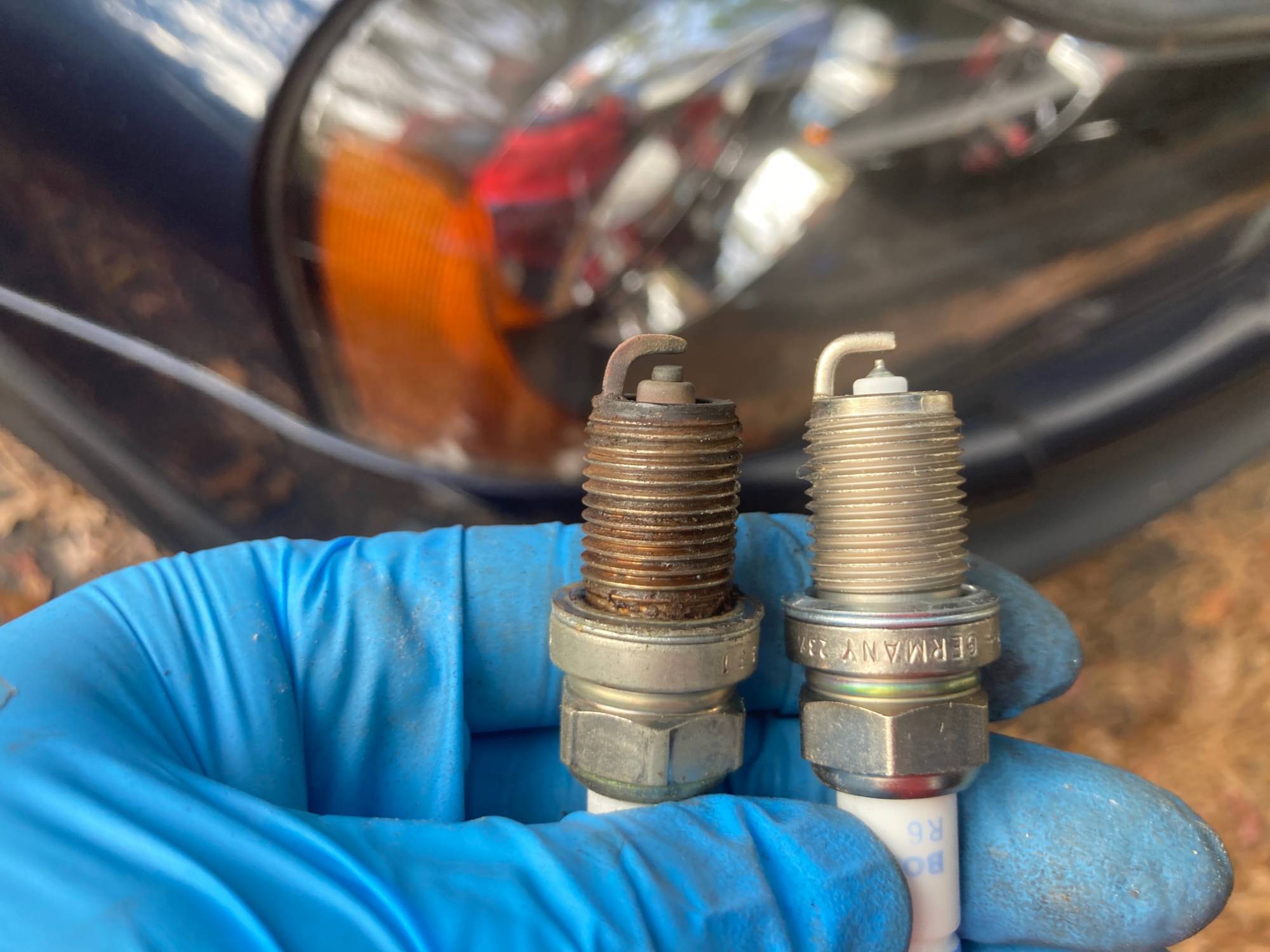

Swapped some Gates fuel tank caps (from FCP) on the T5 and Blue Steel for OE ones with cracked gaskets. I had thought about replacing just the seals (from iPD) to keep the Volvo-branded caps, but with shipping it would cost more.
I also replaced coils and plugs to fix the misfire on cylinder 5 and sometimes 3. Noticed the original Bosch coils were made in Germany, while the new ones came from Slovenia. The new plugs were platinum. The old ones smelled foul, as if the fuel hadn't completely burned off, and were surprisingly dirty.

Looking at the photo, the old plug gap appears twice the size of new gap. That could cause the misfires.

Good eye! I hadn't even thought of measuring the gap on the old plugs. I'll check them when I get a chance.

That’s a turbo , Bruno, so they need to be down at 0,7mm. That’s 028 “ for Yemen and other Fourth World Nations
