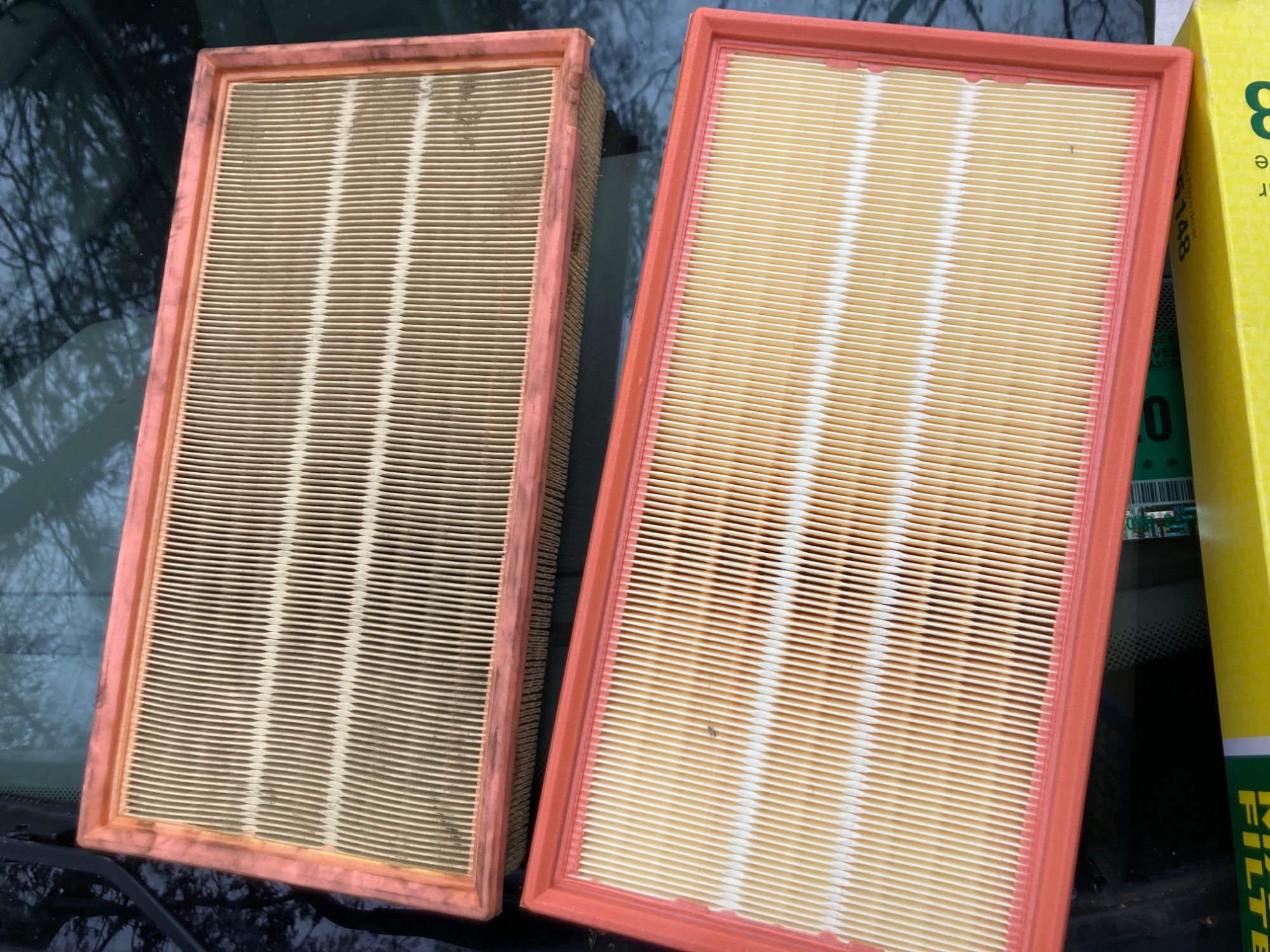

Replaced the spark plugs in Blue Steel with the tri-prong Bosch sold by FCP. Air filter, too!
