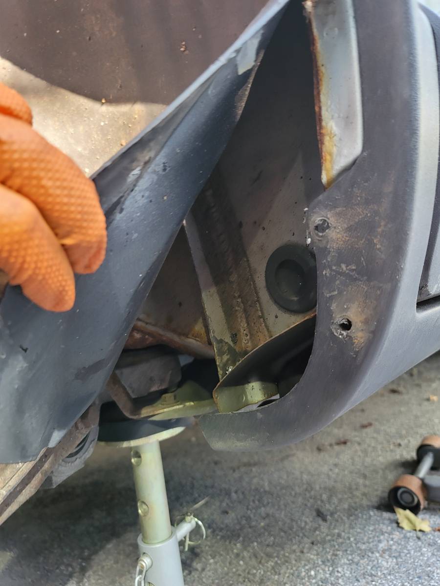

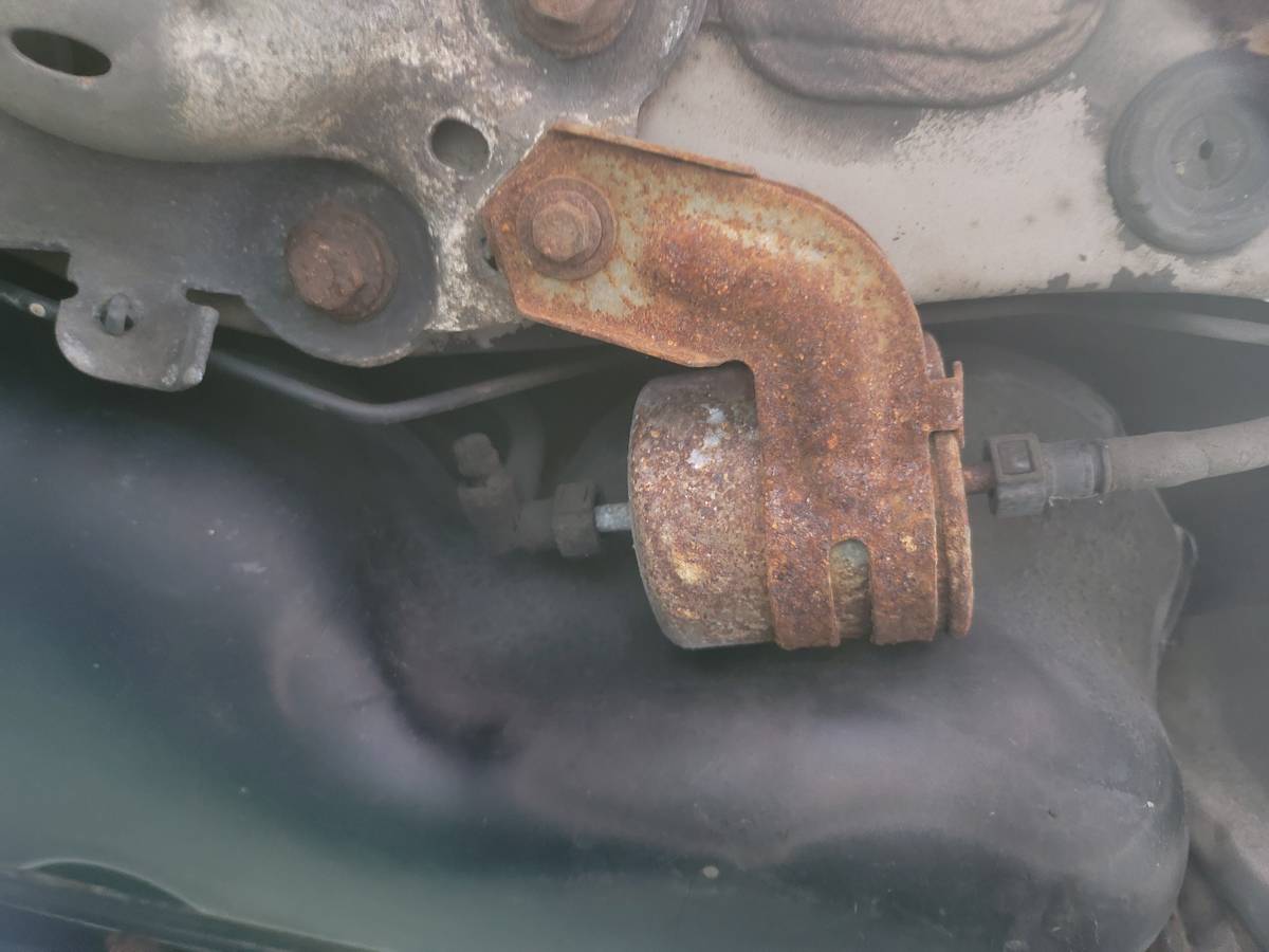

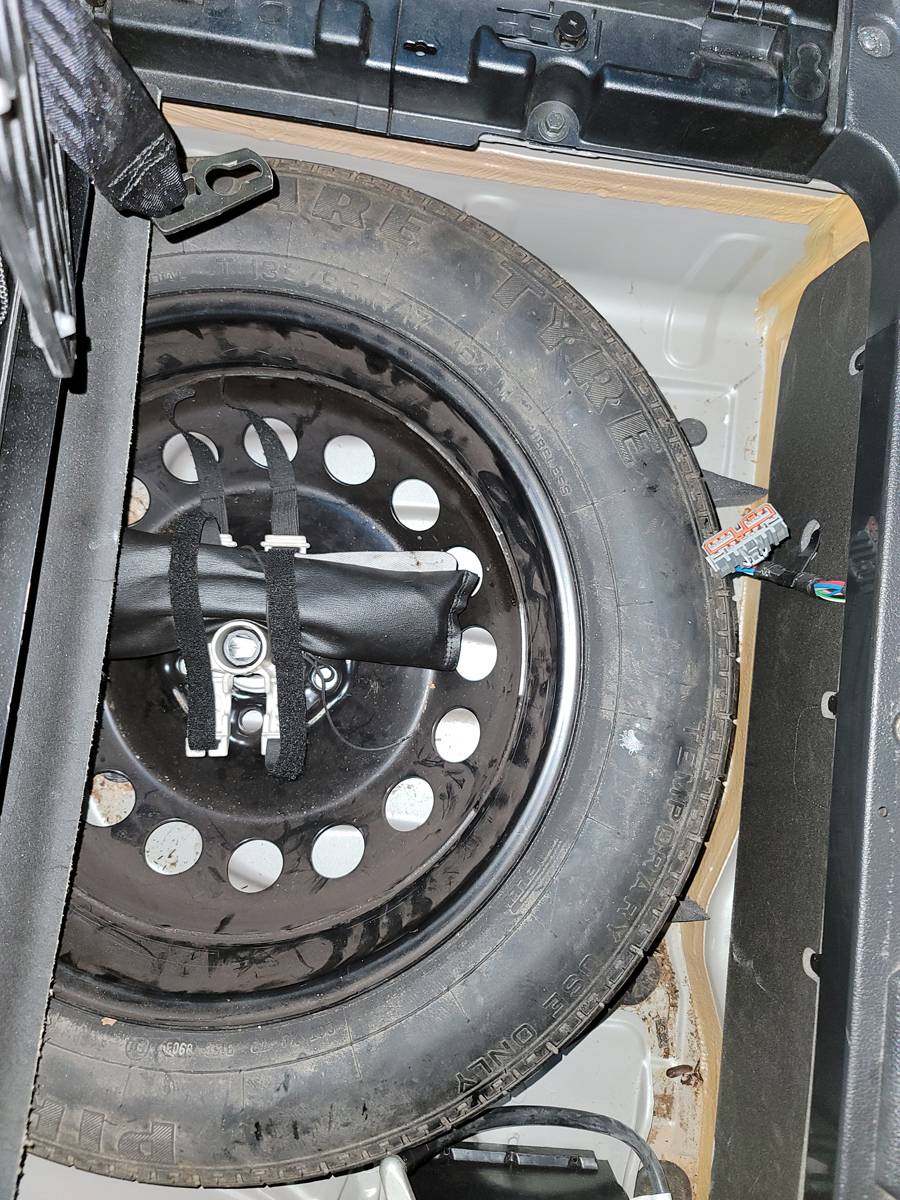

Have not been able to locate the PEM on top of gas tank next to fuel filter, in spare tire well or behind the anterior portion of the right rear wheel well liner. See photos. I checked top of the tank looking from several directions, using endoscope, etc.

- top of gas tank next to fuel filter
- 2021-09-06 17.35.58_1200px.jpg (91.65 KiB) Viewed 2213 times
- spare tire well
- 2021-09-06 19.02.11_1200px.jpg (225.33 KiB) Viewed 2213 times
- behind right rear wheel well line
- 2021-09-11 17.07.42_1200px.jpg (111.12 KiB) Viewed 2213 times

For gas tank, search the web but you need a flash light to look for PEM. It is easy to miss it.
Please post a photo of gas tank closeup...

04 was a split yr, some have some don't.cn90 wrote: 22 Sep 2023, 13:05 For gas tank, search the web but you need a flash light to look for PEM. It is easy to miss it.

Read the post - OP looked above and around the tank with an endoscope, and pretty clearly knows where to look. It seems there’s no PEM on this one.cn90 wrote: 22 Sep 2023, 13:05 For gas tank, search the web but you need a flash light to look for PEM. It is easy to miss it.
- Posts: 36149
I think it is a metal vs plastic parts split for the PEM on the early P2s
