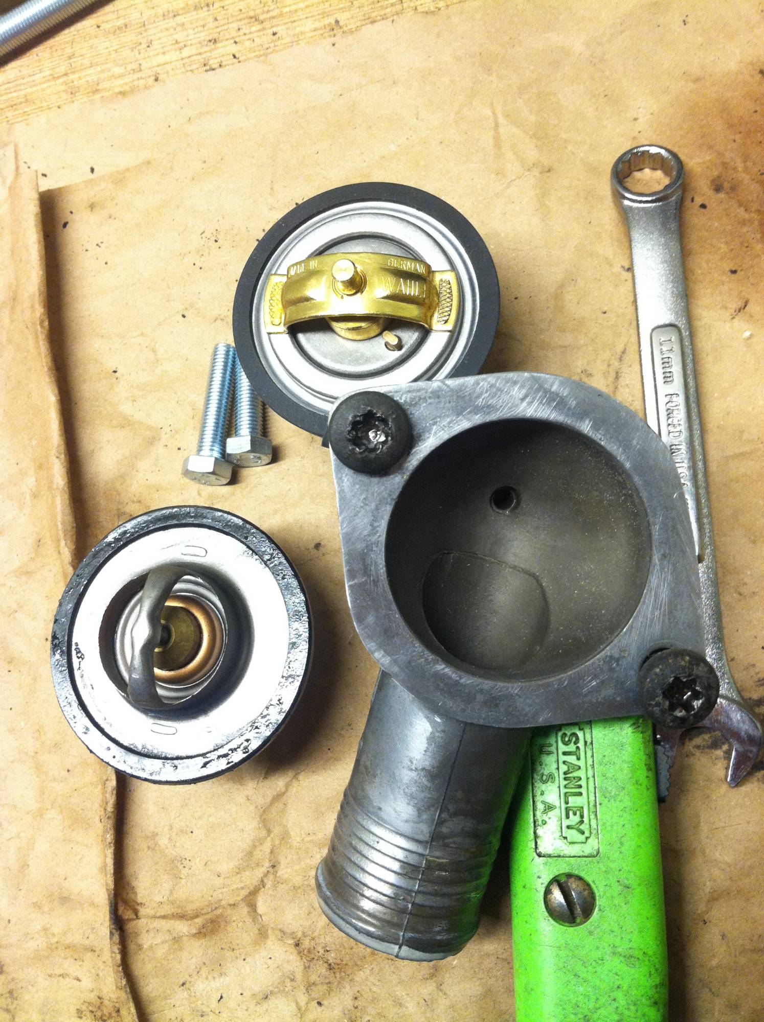

Finally back in Delaware, and reluctantly tackled a long-delayed chore.
But on the positive side of the equation, my luck held again, I still haven't had to drill one out - but this one was a near thing.
All the usual tricks at first, days went by, and finally an emulsion of acetone/ATF and it yielded.

I believe intake manifold bolts are good replacements for those torx ( if you wanted to stay Volvo ) :)
I seem to have quite a few, due to junkyard visits.

Sveedy wrote: 15 Feb 2023, 19:11 I believe intake manifold bolts are good replacements for those torx ( if you wanted to stay Volvo ) :)
If you buy the Volvo thermostat you get two new ones. I’m not sure if they are m6,7, or 8
Intake bolts are m7
986228 FCP shows this for -1998 ? Is this another bastard?
Sveedy is correct
Mounts the Housing cover the thermostat outlet, will require 2 for housing cover and 3 for thermostat outlet. M7x1.00x30mm
