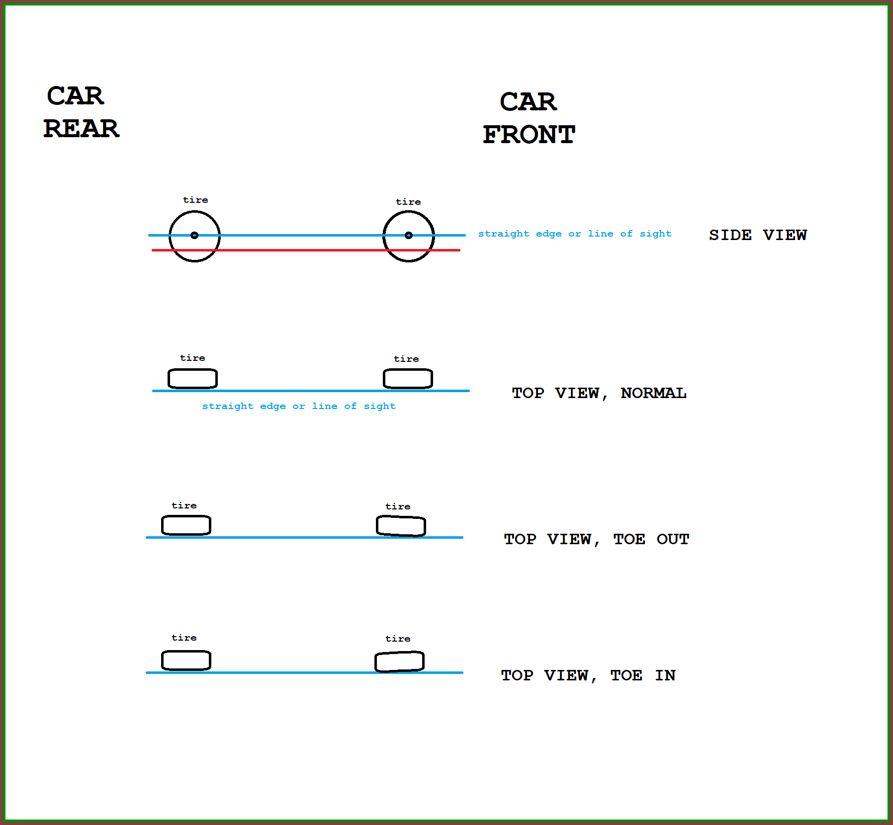

Hi,
I've done my own alignment for years.
Toe in/out you can tell by standing in front of the car and looking down along the sides of the front and back tires. You can easily see if the front wheel points in or out. It's as if you had a 10 foot straight edge against both the front and back wheels on each side at a height of the wheel centers. If a wheel points in or out it wouldnt sit flat against the straight edge.

MrAl,
What do you do when the car body does not allow the straight edge to reach the center of both front and rear wheels (the body bulges out)?

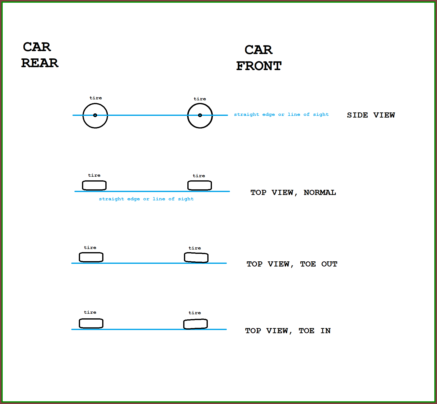

Hi,volvolugnut wrote: ↑28 Feb 2023, 10:40 MrAl,
Get a acetylene cutter, cut that part of the body off then weld it back on later, or move the "straight edge" (line of sight) down closer to the ground
I may have drawn the straight edge too high in that drawing. Even lower you can still judge the alignment.

This is one of several reasons I take it to Mr Alignment Man (or Woman) to get it all set...with LASERS!volvolugnut wrote: ↑28 Feb 2023, 10:40 MrAl,

Read the reply to that post.BlackBart wrote: ↑28 Feb 2023, 19:12This is one of several reasons I take it to Mr Alignment Man (or Woman) to get it all set...with LASERS!volvolugnut wrote: ↑28 Feb 2023, 10:40 MrAl,
Never needed an alignment job with any cars i ever had and i replaced tie rod ends.
You can use a laser if you like no problem.
