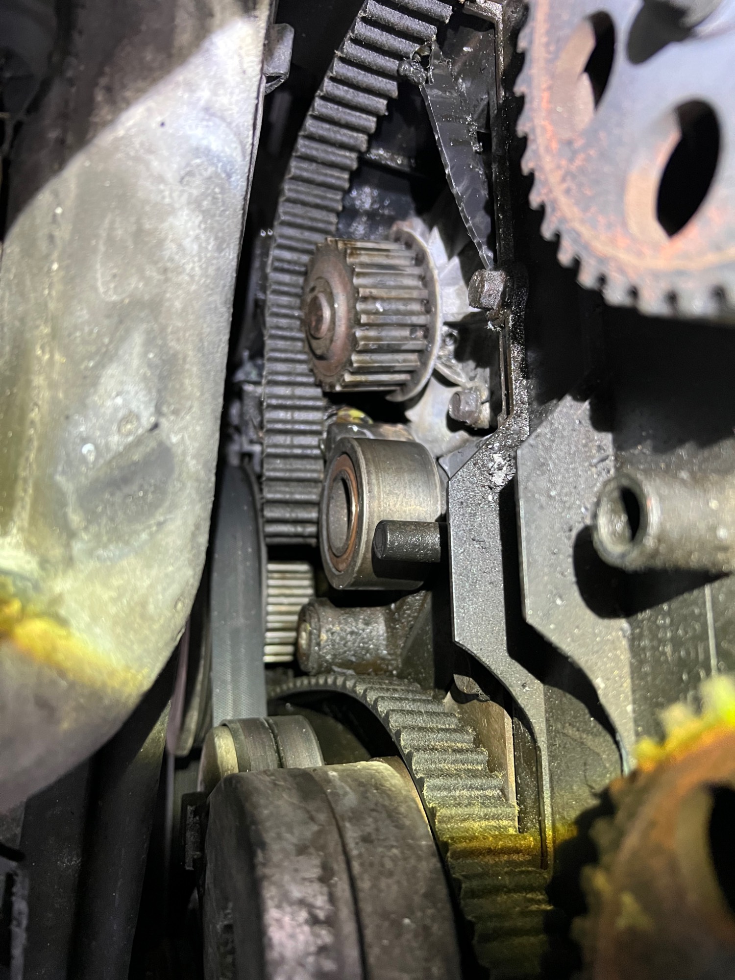

So as a final update I was wrong, took the belt cover off and the belt was in good condition. No stripped or shredded belt. What was odd is my water pump gear had thrusted outward and was bent at a 30 degree ish angle inwards. No idea how or why that happened on a newer pump. Guess the leak was coming from the water pump bearing?? Added a picture of it.
Popped the plugs out and the cylinders don’t have holes in them when looking from the top. Don’t have a camera on me but could tell atleast that.

Yep, this is exactly what I was expecting to see. It certainly jumped timing and more than likely bent most of the valves. Bottom end damage is highly unlikely. Might want to price out a cylinder head job versus a replacement engine, but it sounds like your mechanic doesn't want to take on more major jobs like this, especially if he'd rather just swap the engine instead.
Abscate would have good input here.

Water pump shaft looks well bent. It may be one of the pumps where the shaft has come loose from the impeller or the bearing have failed. I think that may well be the reason for the failure. Bmdubya's advice is worth considering. Pistons don't often get damaged but vales to get damaged as Abscate can attest to.
A used engine may be cheaper, but unless you can hear it running how do you know it is good? The labor time to swap an engine is large.

scot850 wrote: 20 Mar 2023, 23:30 Water pump shaft looks well bent. It may be one of the pumps where the shaft has come loose from the impeller or the bearing have failed. I think that may well be the reason for the failure. Bmdubya's advice is worth considering. Pistons don't often get damaged but vales to get damaged as Abscate can attest to.
Thanks Neil.
I know my mechanic pretty well they said sub 2k for it all. I am thinking I may pasteurize this car until the summer. In the summer I will complete a head rebuild on the crashed cad and do a head swap or borrow an engine hoist and do the same. I’ll have a bit more time then and hopefully a bit more cash. I might resurrect this car as a project to make it look nicer and not have a daily that I also constantly work on. I don’t think this is the end of the car at all and will do as abscate did and treat this as a learning opportunity.

I don't see how the water pump pulley is at an angle. I've attached a picture of my 2000 V70 timing belt area. Can someone help me understand this failure?
yanga001, we hope you do choose to rebuild the engine as a learning exercise. It's nice to have you here so we hope that you stay. Good luck with your studies.

The bearing likely failed, causing it to fall down at an angle like that.
