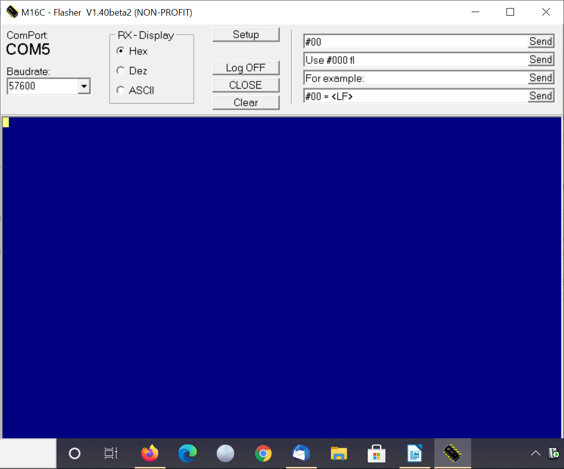

Looked at the first cracker proto (the one that worked with Renesas directly) - it was connecting the chip super-reliably, so here's the boot sequence:
1. Click "Settings", select your port and 57600 baud
2. Click "Terminal" and select 57600 baud
3. Click "Send" against any #00 byte, do it until the CEM replies "B0"
4. Click "Close"
5. Click "Connect"

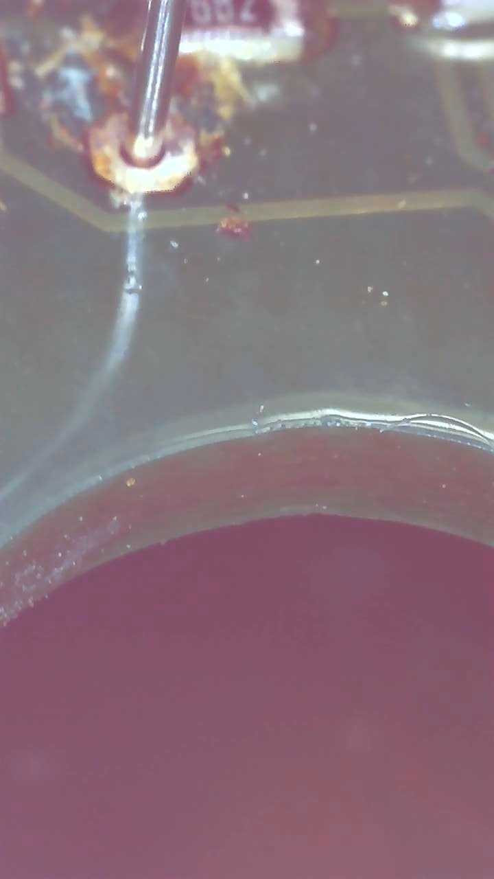

Digital calipers decided to start working again. Looks like the holes are 0.40 mm (Drill #78, #11 Beading needle. AWG 26 or 27 ). Have not confirmed that it feeds all the way through.
Went all over town looking for Solder Wick or a Solder Vac to clean up the board. Nobody had any.

I'm using 8W 5V/USB soldering iron with variable heat control. Cut the end of one of the USB cords in the parts box and direct wired it to my power supply. I think what lifted the pad was bumping the soldered on pin not the heat. Was using the pins from a disassembled header.vtl wrote: 28 May 2021, 16:47 I use these wires to avoid any problems with PCB: https://www.amazon.com/gp/product/B07G2SWB19 Also solder with a Chinese 852D+ clone, it's not good, not bad in soldering stations world, but still much safer than a straight 40w iron.

Could you clarify that. Lot of options in terminal mode.vtl wrote: 28 May 2021, 15:33 3. Click "Send" against any #00 byte, do it until the CEM replies "B0"

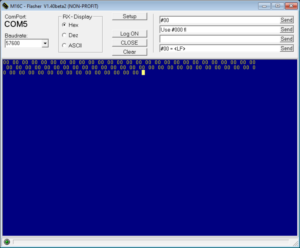

Displays the sends every second time I click send.
