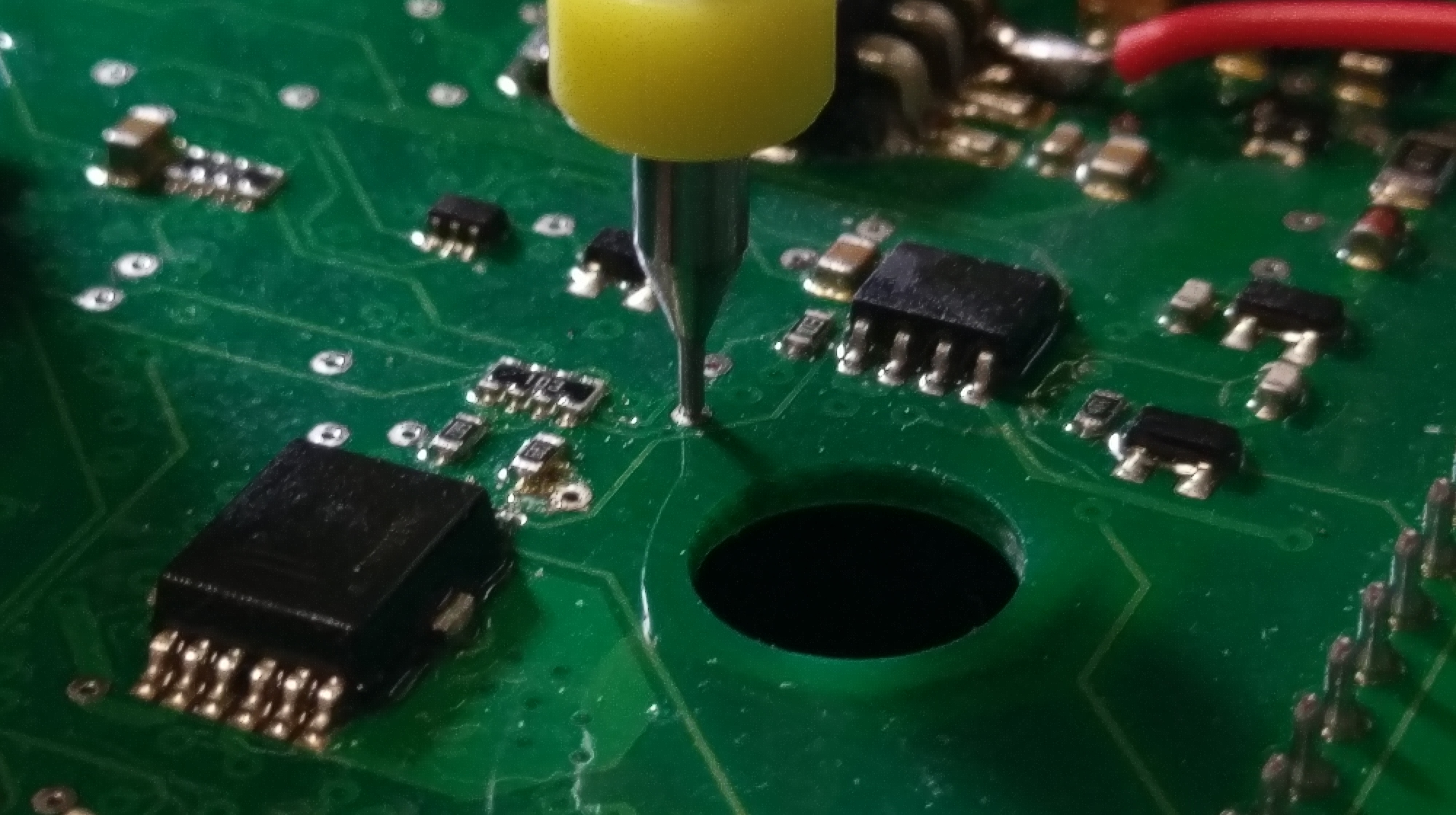

Today I verified that the holes on the pads are through holes. Here is the proof. That is a PCB/CNC drill bit.
A little twist with my fingers and the conformal coating cleared out.
