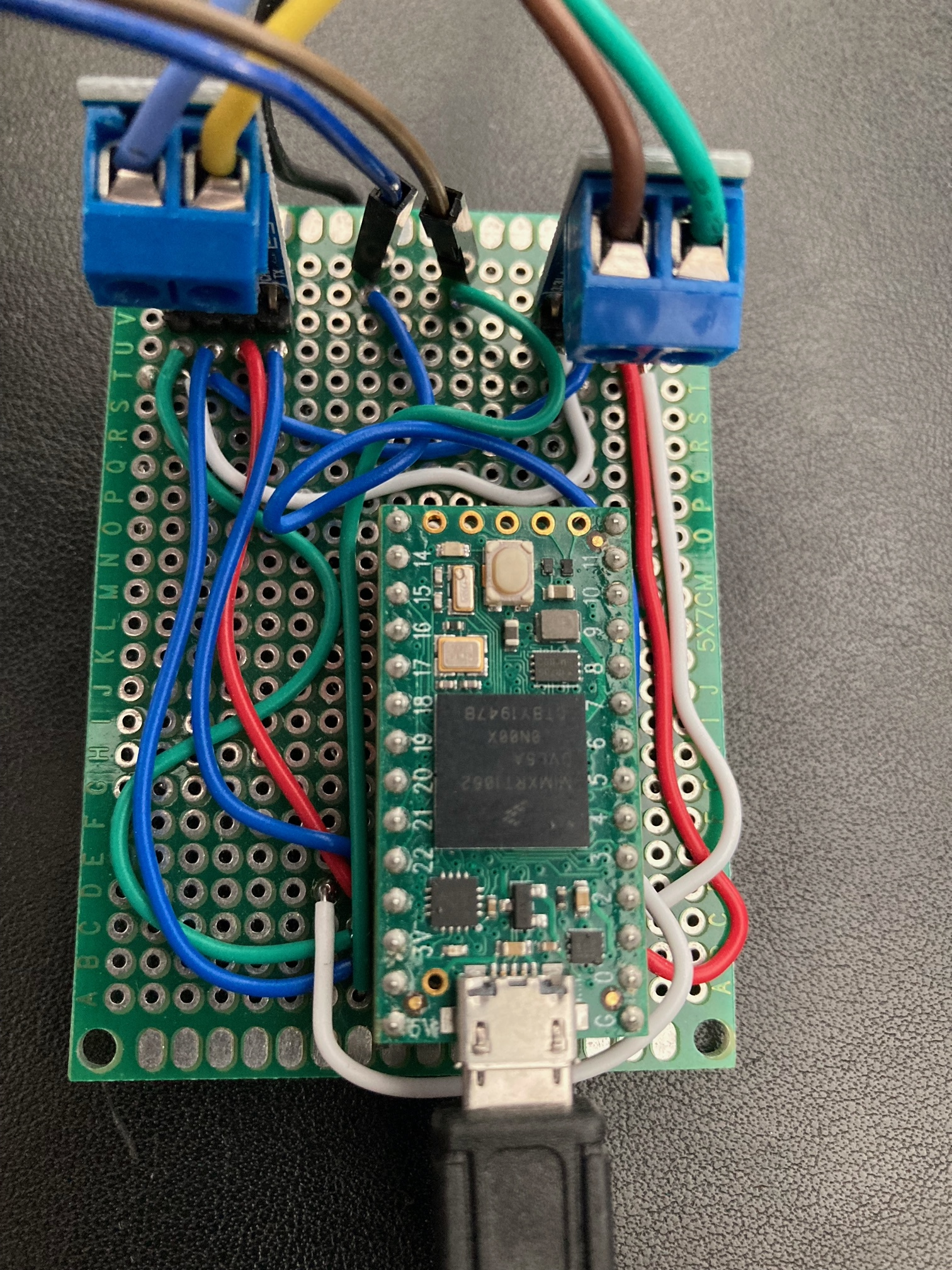

PowerMatz wrote: 14 Jun 2021, 14:04 Has anyone another clue for me now? I don't know what to do next because I tried all,
From your Archiv.zip...
First log:
Code: Select all
11:14:01.522 -> 1000 pins in 573 ms, 1745 pins/s, average response: 20 us, histogram 10 to 30 us
20 us is too low, something is not right. Won't work.
Second log:
Code: Select all
12:59:03.981 -> 1000 pins in 639 ms, 1564 pins/s, average response: 86 us, histogram 43 to 129 u
Latency is good for CEM-L.
Can you rerun the second test (when the latency is in 80 us range)? Don't bother waiting till the very end, just capture logs for the first pin position. Do it a few times. It will show us whether the discrepancy is there, but the cracker sw takes the wrong decision.

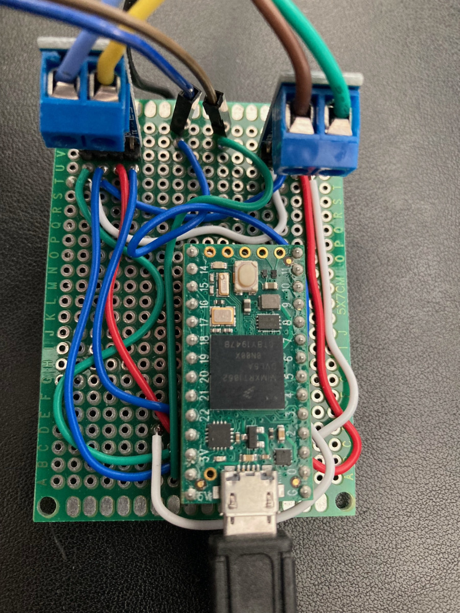

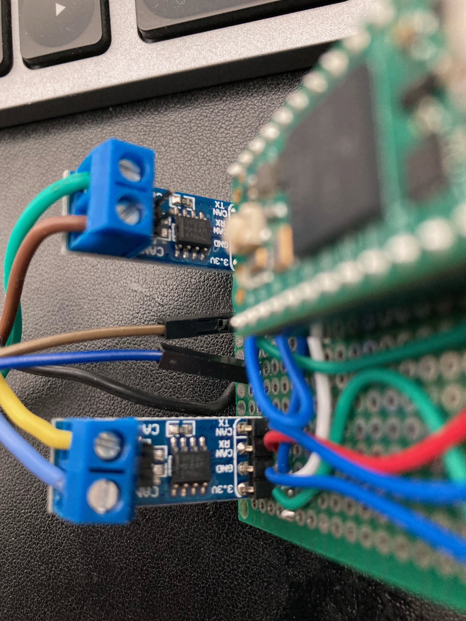

PowerMatz
Posts: 7
Joined: 09 Jun 2021, 10:41
Year and Model: 2009 XC 90 3.2l AWD
Location: Germany
Has thanked: 1 time
Post by PowerMatz »
RickHaleParker wrote: 14 Jun 2021, 14:45
PowerMatz wrote: 14 Jun 2021, 14:04 I don't know what to do next because I tried all,
If your Cracker is still bread boarded. Check the connections. I made heavier gauge jumpers out of Paper Clips. It made a difference. You could use solid copper wire to make heavier gauge jumpers.
Which CAN transceivers are you using? Some people had trouble with the 3.3V CAN transceivers.
Do you have the Latency detect jumper installed? Some missed that because VTL forgot to include it in the original schematic.
The Red jumper is the Latency detector ( PIN #2 to #23, Both fourth from the end ).
Hi,
it is not bread boarded. I soldered it on a circuit board. I have the bridge for latency soldered and I used 1,5mm2 wires. I thin they are heavy enough.
I use the Waveshare CAN interfaces and cut the resistors for termination. Please see my photos. Should I try some other CAN interface?
