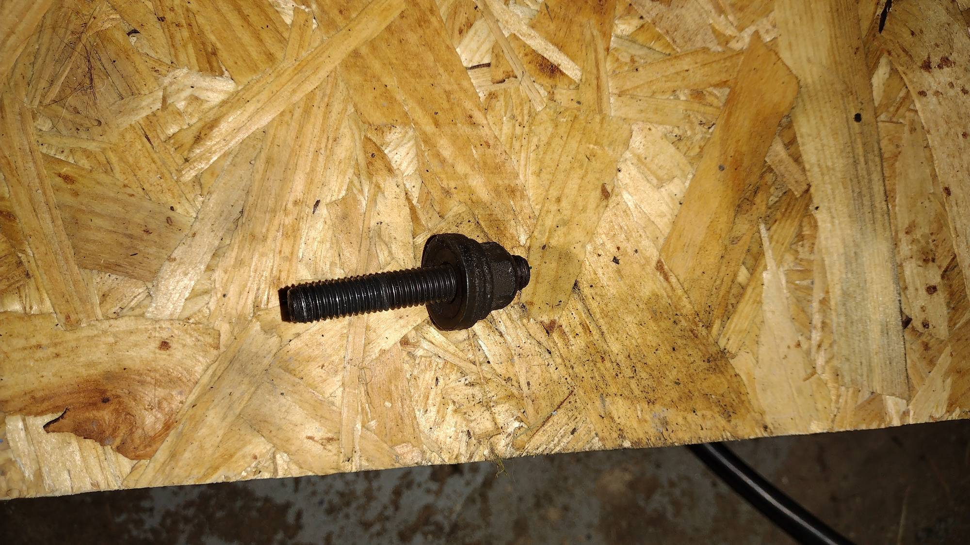

Found this little guy hanging out under the turbo while searching for a coolant leak. Pretty sure it's an exhaust stud. But I don't have any exhaust leaks and can't find an empty hole.

Heatshield bolt, or downpipe flange? Or is that the one you lost last time you were working on it.............?

Having just removed all the exhaust bolts, that is most certainly an exhaust stud. There may be enough tension across the exhaust manifold to prevent a leak. You would need to move the exhaust shield to see. Could also send a bore scope camera to visualize the studs.

ZionXIX wrote: ↑26 Jul 2023, 20:58 Having just removed all the exhaust bolts, that is most certainly an exhaust stud. There may be enough tension across the exhaust manifold to prevent a leak. You would need to move the exhaust shield to see. Could also send a bore scope camera to visualize the studs.
I figured it was an exhaust stud. I'll send my cheap borescope in to investigate. Definitely wasn't one I lost. Which means it's been bouncing around down there for potentially over 5k miles.

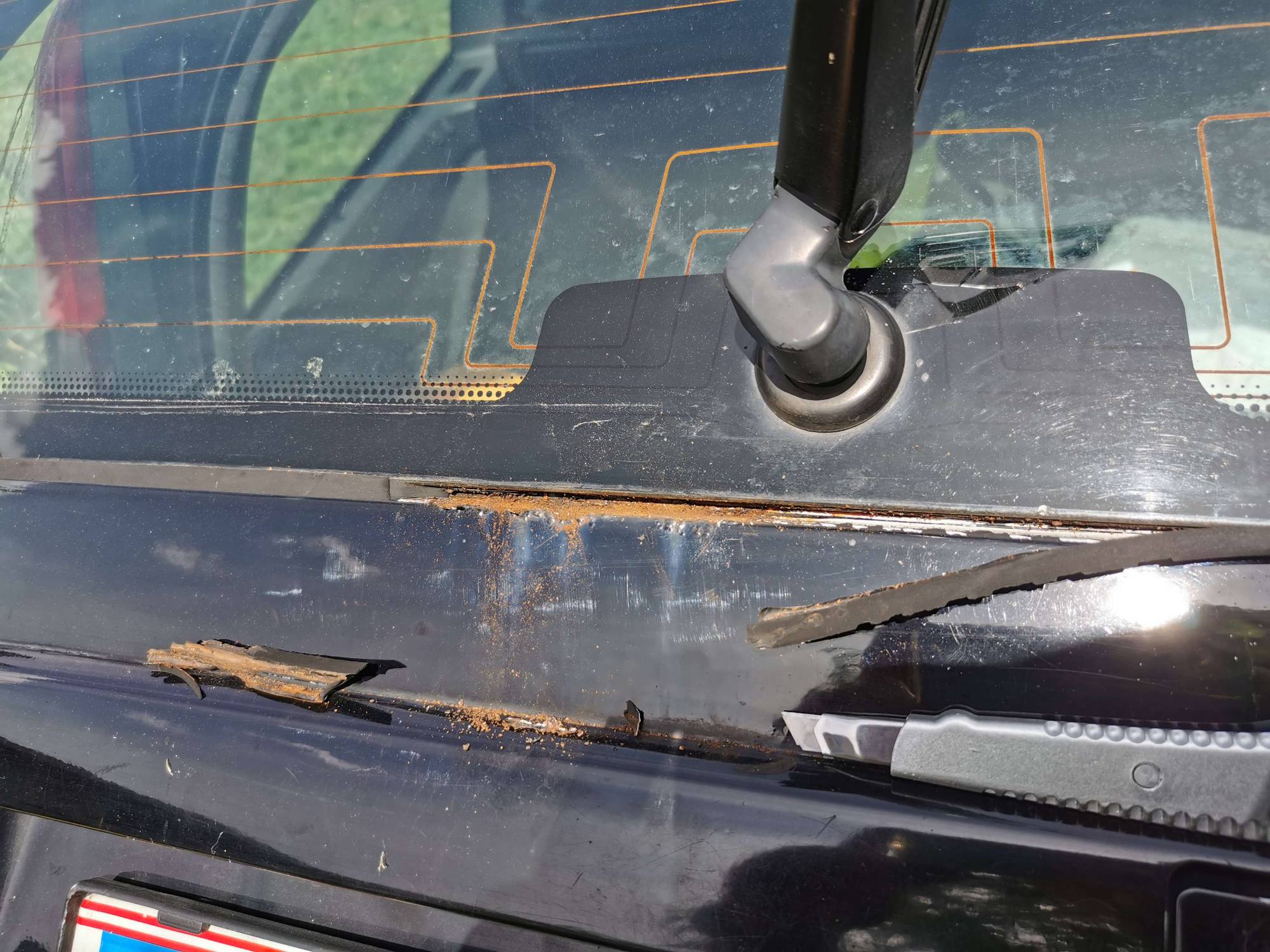

Worked on cleaning up some Rust...
Pulled out the whole line of glue and after some rust converter will slap on some paint. Probably not going to look too pretty, but at least will not rust any more. Taking out the window is too much to ask for now, also the rust does seem to only be below it.
