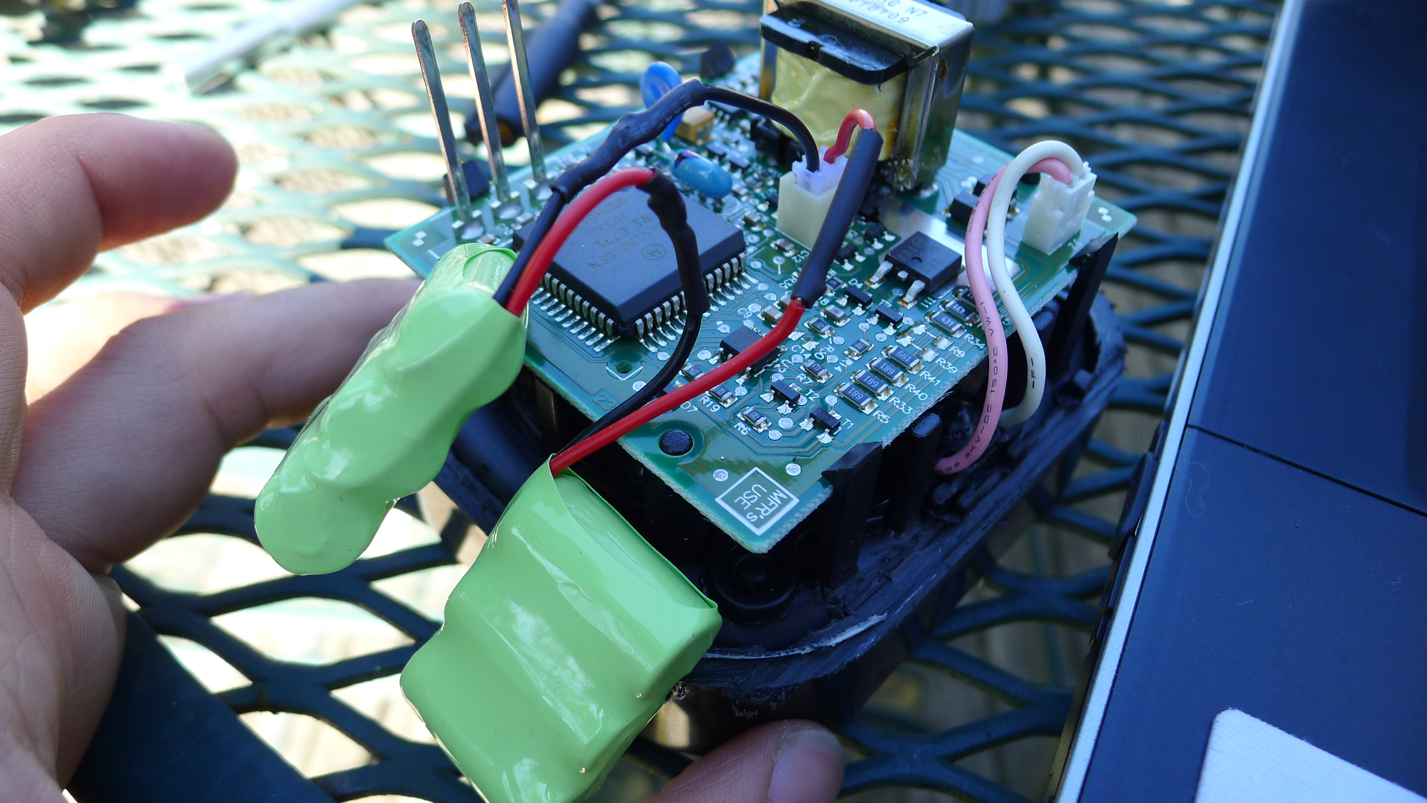

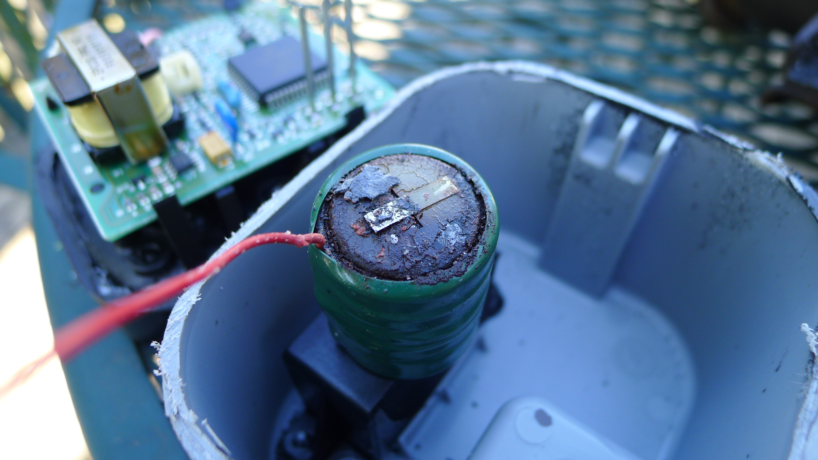

Did this today - a few notes. As mentioned before I used 2x these batteries: http://dx.com/p/qoop-gd-303-3-6v-210mah ... een-197921 .
Was able to get the security bolt off using only a needle-nose vice grips, so for once things went better than expected. Didn't need to bother drilling bolt etc out.
My siren was not bad, but based on the age of my car (2002) thought I should do this before winter. Well here is a shot of the battery: As you can see it was starting to leak, so it's well worth the effort even if you don't yet see signs of the errors! The old battery cable/connector was corroded internally, I think some battery acid was starting to leak down the wires. The batteries in the link given have separate +/- connectors, so you can make them fit easily. Just be sure to mark which pin is +/- on the original module! Here is final wiring: For cutting siren open just use a hacksaw, I found that much easier than dremel actually. Just make a straight cut into the plastic where black/grey meet. Don't need to go too deep, just keep going around until it pops apart.
I DID NOT disconnect battery when doing it, seems fine. Note the instructions of VIDA simply say to 'disarm alarm' before doing this work (e.g.: unlock car).
