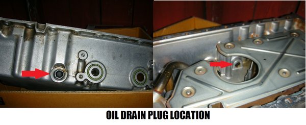

Hey - while you have it off and clean. Can you post a pic of how low the oil drain plug sits from the inside of the pan. Everybody always asks me for that pic and I always forget to take it.
Thanks

I lightly scrubbed the surface with my sponge, no hard pressing though. I'm going to take a razor to it and see if I can carefully get some of it off. Is B-12 available at most stores?
Also, your wish is my command... :mrgreen:

JDS60R
Posts: 3532
Joined: 21 February 2009
Year and Model: 2007 S60R 2016 XC70
Location: Mount Juliet, TN
Been thanked: 3 times
Post by JDS60R »
Thanks for the pics

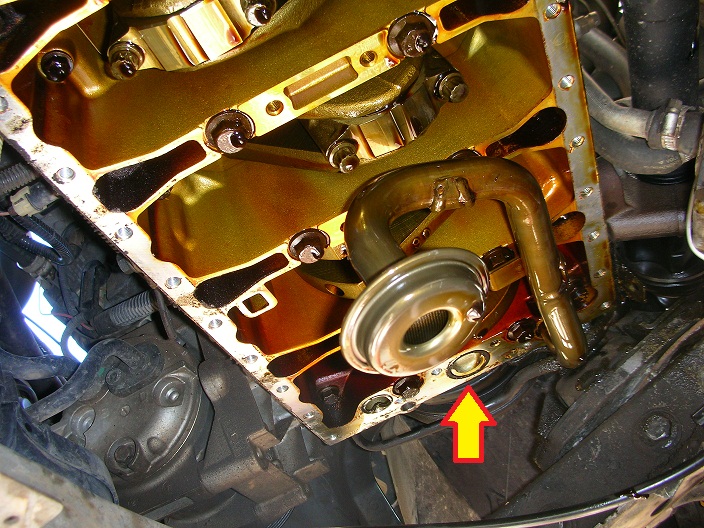

Alrighty, now time to replace those o-rings.
1. I got the oil dipstick tube o-ring taken care of.
2. I got the replacement for the o-ring that I took a picture of, the one that had failed with the deformation.
3. Now, to the right of the bad one, there is this guy:
I don't seem to have a replacement that matches in my o-ring kit, however the ring is not in bad shape. I tried a couple of the larger o-rings that I have, but none fit exactly well as the old one does.
4. I took off the oil pickup tube and got the o-ring on there, and it wasn't in terrible shape.
So are there only these 3 o-rings that need replacing? I noticed there are also o-rings around the oil cooler ports, but I don't have replacements for those either. They are in good shape though.

JDS60R
Posts: 3532
Post by JDS60R »
Replace them all. No question - don't even think about not replacing them.
During training they would put the water hose on us while doing push ups when we even mentioned bad thoughts like not replacing them as"they look ok". Do you have a hose?
Keep in mind:-
1.They are all partially degraded and damaged due to compression and heat
2. You can never align them back where they were perfectly so a surface mismatch is guaranteed.
3.This "is" your chance to replace them - having to do something twice is not as much fun.
4. You are going from no liquid gasket to a substantial one and the distances between critical gasket surfaces will change.
5. Common sense and good engineering practices dictate any failing material in service for a reasonable time should be replaced if accessible.
6. If you get an oil system leak or too many bubbles in the system you may have to replace the engine at great personal expense .
7. You have been advised of how bad an idea it would be to stick with the old o rings.
Retired
