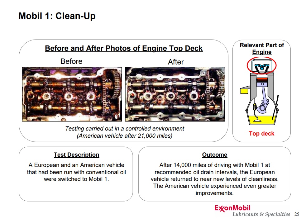

Additionally I use this oil because it claims to clean up the engine that has deposits due to the engine being run on conventional motor oil.
And it minimizes the formation of future deposits

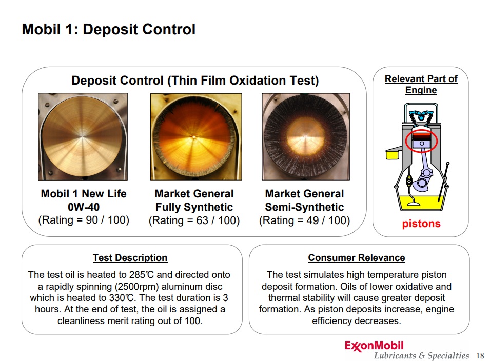

And finally here is a comparison of three different Synthetic oils
Note: ESSO is now owned by Exxon Mobil
The interesting thing is how much better the 0W-40 Mobil 1 is as compared to the synthetic ESSO
And for this test the "New" 0w40 is actually slightly worst than the "Old" 0w40. This is due to trade offs, the New is superior in other areas but very slightly inferior in this test.
This test is focused on simulating deposits on the piston rings. And if you watched the Toyota video you can see that the deposits on the oil control ring result in the engine burning oil and if the engine burs oil for too long then the catalyst efficiency code can be set and eventually the catalytic converter can be damaged.

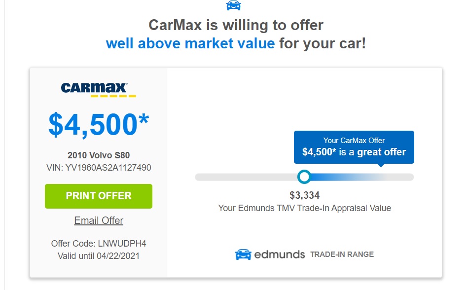

Back to the Challenge,
I decide to modify the first line item in the cost to show the depreciation of my S80 instead of using the full purchase price.
To do this I got a price quote from Edmunds/Carmax
Total Vehicle Cost (excluding, wheels, tires, fluids and filters)
$2900 --- Depreciation (Purchase price $7400 - Present value $4500)
$62.53 --- (31401556) --- Booster O-rings
$40.35 --- (DENSO 5344) --- Sparkplugs
$58.28 --- (LR006071) --- Thermostat
$00.66 --- (LR001505) O-ring for 30713530
$24.29 --- (30713530) --- Coolant hose
$68.85 --- (31272677) --- Oil Filter housing
$18.92 --- (LR006076) --- Idler pulley
$18.92 --- (LR006076) --- Tensioner Pulley
$08.97 --- (PK060473 CONTITECH) --- Aux Belt
$112.70 --- (LR021634) --- Motor Mount
$23.24 --- (30680474) --- Torq Mount
$15.76 --- (UD1306) --- Front Brake Pads (Amazon close out price, typical price is ~$75)
$523.23 --- AC repair
$43.37 --- Overdrive pulley ProParts Sweden 28436803
$323 ---- Radiator (Prem Air type)
$281 --- Radiator Fan (Siemens / VDO)
Total $4591
Note: I wouldn't sell it for this price
Here is the quote that I got
S80 Value.jpg (89.62 KiB) Viewed 2344 times

xHeart,
That is a great way to think about it.
The cost that you identified is equivalent to the car payment for a new or used car with a small down payment.
This is exactly what I was getting at with the challenge, to put into the terms that you identified.
What is the safest and most reliable used car that you can purchase for under $100 / month?
My actual target is about $90 / month
The present value of my S80 can be thought of as the
Total investment - (target monthly cost * # of months) = Present Value
$10,000 - ($90 * 28) = $7480 (4/15/2021)
(4/15/2022) = $6400
(4/15/2023) = $5320
(4/15/2024) = $4240
To answer your question in three years I would accept the four thousand and five hundred quoted. But in three years the quote will be lower.
But my expectation is that my S80 will never actually be worth equal to or more than the calculated present value.
