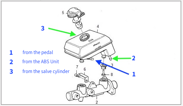

Okay. Let's consider that the fork is okay, also its internal clip and pin.
Chuck W wrote: 11 Nov 2020, 07:26 Air wouldn't cause the piston to pop out. It's going to compress more than the fluid, and result in reduced clutch actuation, not more, or add side-to-side movement.
Okay : so the last possibility is a hose which in bad plugged.
Capture d’écran 2020-11-11 à 16.03.06.png (101.72 KiB) Viewed 872 times
My Volvo dealer says :
N°1 come from the pedal. In fact, if the clutch fails, the brakes circuit stays full, which sounds correct to me.
Shall i reverse N°2 & N° 3 ?

There should be no connection at the reservoir to the clutch slave. The clutch slave is only connected to the master. The master is connected to the reservoir and fed via gravity.
The slave should only have the port for the connection to the clutch master and the bleeder screw. How are you connecting an additional hose to it?

I thank you to follow my history...
When I press the slave cylinder via its piston using the clutch fork, the pressure sends fluide to the reservoir. Otherwise, how could I make air bubble get out ?

manovlov wrote: 11 Nov 2020, 08:39 I thank you to follow my history...
Those air bubbles travel back through the line to the clutch master cylinder (at the pedal) and from there travel up to the reservoir.
There is no direct connection from clutch slave to the reservoir. The clutch system has only 1 connection to the reservoir, and that is at the clutch master. If you have 2 connections at the reservoir, there is something wrong.
Also, pushing on the clutch slave isn't the way to bleed the system (at least not well). The reverse bleed method I posted earlier in your thread (using a syringe and NOT the pushing on the slave cylinder piston) forces all of the air in the slave back out through the master and out into the reservoir.

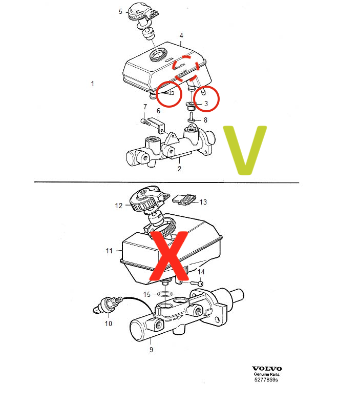

Chuck W wrote: 11 Nov 2020, 09:27 [If you have 2 connections at the reservoir, there is something wrong.
Does it help to understand the circuit ?

Yes, I understand how the circuit is supposed to work, and that diagram isn't it.
How are you attaching 2 hoses to that slave cylinder? It's no different than any of the others, and it has a connection from the clutch master (at the pedal) and a bleeder nipple. That's it. Where are you connecting that other hose from the reservoir?
Here is the clutch slave in my car. The only connection is from the clutch master.
It works like any other hydraulic pressure circuit, like your brakes. There is a fixed "column" of fluid between the master and the slave. When the piston in the master is pushed/released, it moves the column of fluid and moves the slave piston in/out.
The diagram you show doesn't make any sense, as the slave cylinder doesn't need a reservoir connected to it. That would just cause problems.
