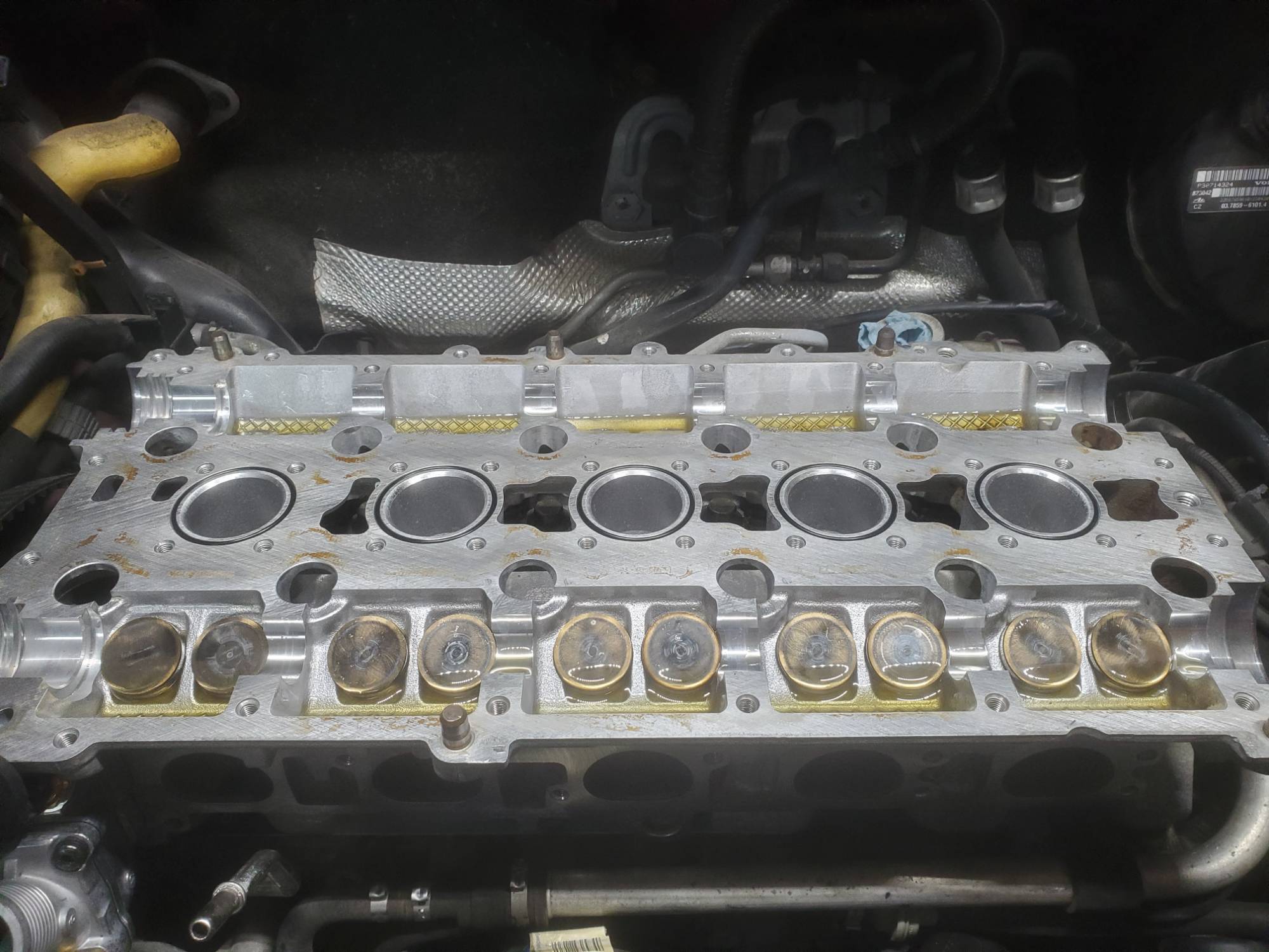

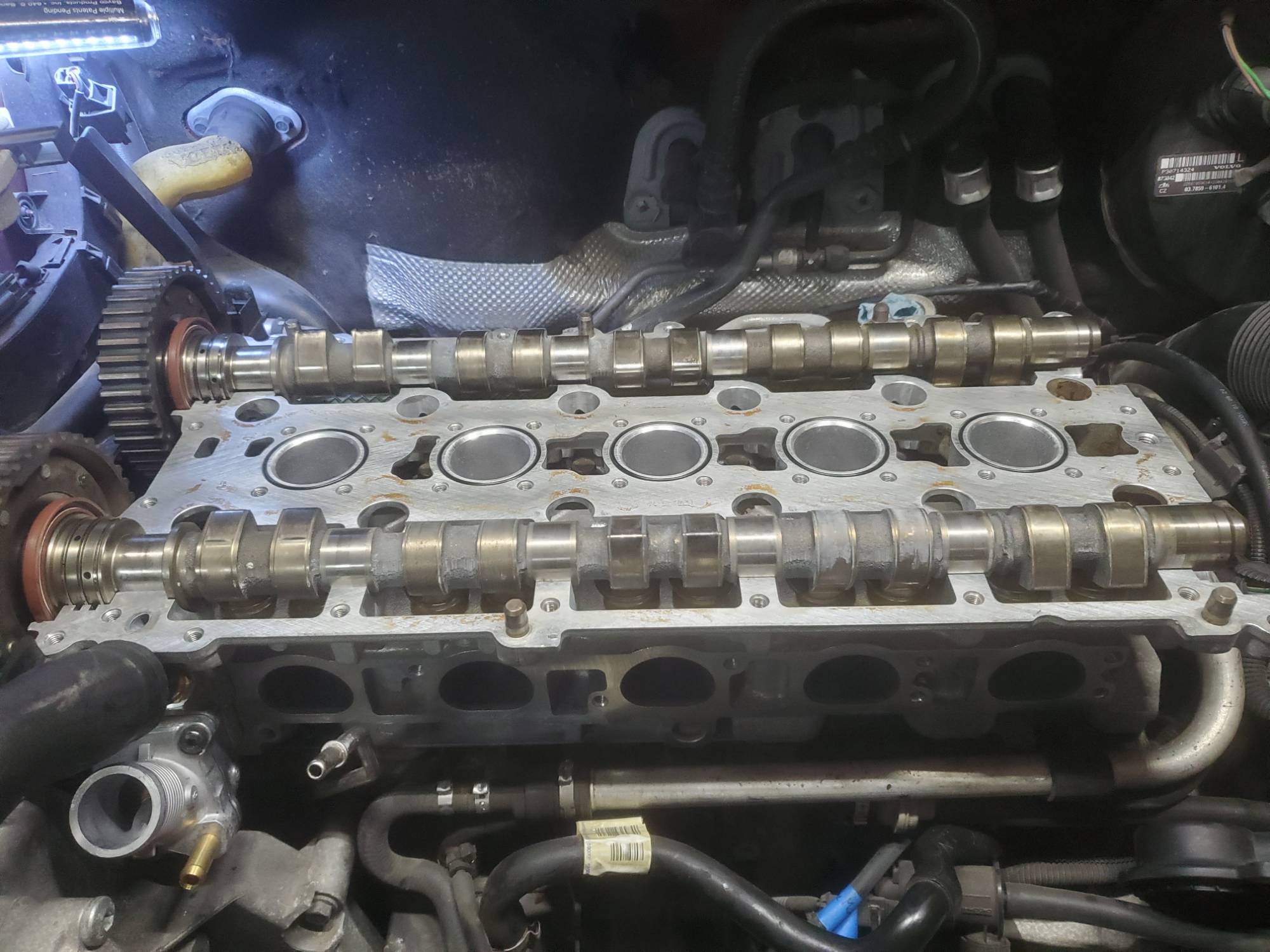

Finally making progress today. Cams went in, cover is glued down, timing is on. Engine passed the rotation test. The cam locking tool is super helpful, worth the money in my opinion. Abscate, I'm putting your aviation gasket maker to use. Timing the dual VVT was not nearly as bad as I thought it was going to be. I did find moving the exhaust 1 tooth was much easier than on my 850. With any luck I'll have assembly done today and may even get to fire her up.

After yesterday's cam, cover and timing belt install. This morning was productive. I spent way too much time blindly threading a banjo bolt underneath the xc90 intake. Then got spent even more time getting the serpentine belt on. Even with the tensioner fully open its a nightmare. Then re installed the fuel rail, about 200 electrical connectors, airbox and intercooler piping. Finally she started up and completed a 10 second run. Haven't put coolant in so kept it short.
