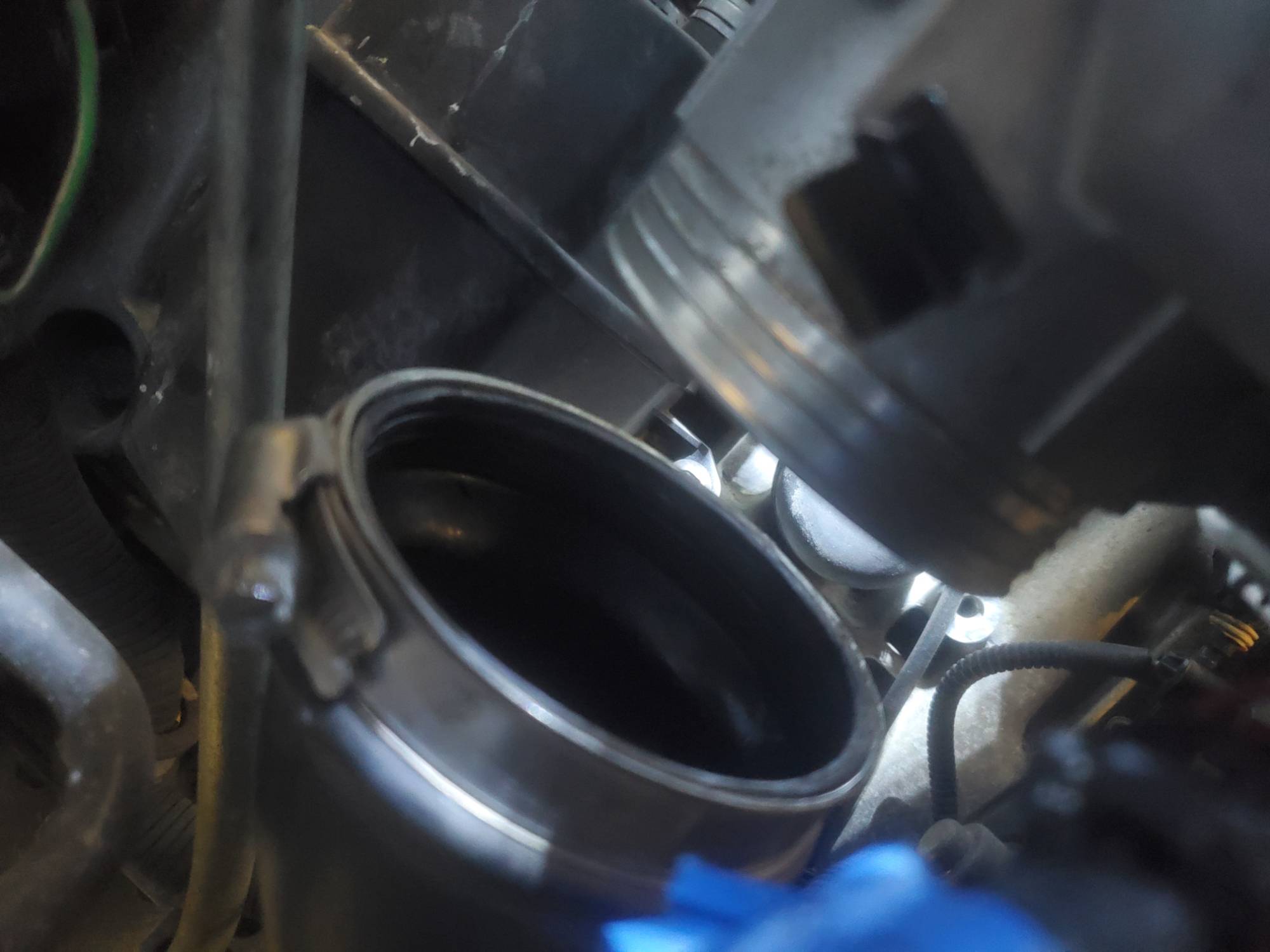

Ok I figured out the mystery *pop* from the maiden voyage. The intake from the turbo blew off at the throttle body. This morning I drove the xc90 on a Sunday morning donut run and she was running loud with sluggish power. I thought I was hearing an exhaust leak.
I can't believe it drove as well as it did. After I got home she would just stall at every startup.
Also gave the MAF its first cleaning in 18 years. Now I'm currently installing one of the retrofit android tablets.

Yep, that'll do it! I've had that happen, it will kill power pretty quick. I'm surprised it took that long to want to stall.

Elizabeth test drive , lumpy and crappy. Found loose ground on 1/2 coil pack
Those turbo induction clamps Volvo uses are , special, with a spring band in the middle. Designed for purpose, I bet.

Well, you know, if you cut them in half they don't work too well

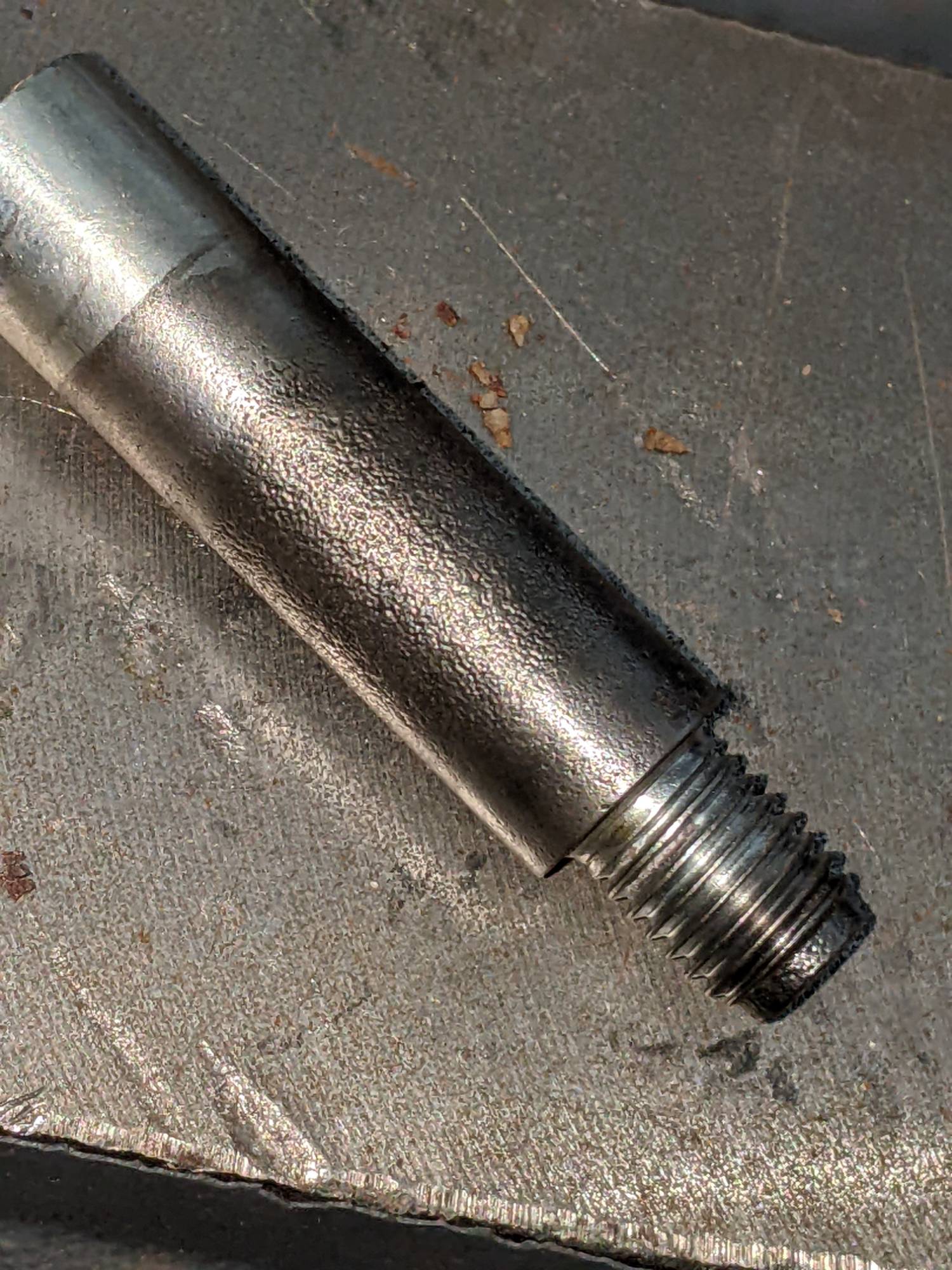

With the pending 98 V70 suspension refresh on the near horizon, I have to get my main workbench cleared to work on the parts.
First was tackling the pair of rusty but good front P80 brake calipers and big brake caliper brackets they were mounted to.
What amazed me was the condition of the aftermarket (awful) slider pins. How/if these brakes worked amazed me!!
Even after cleaning it is not worth keeping due to the surface damage. This will in turn damage the slider boots.
I still have a bunch of used OE pins that are in way better condition than these. The other issue I did not show is the damage to the 7mm hex heads. I have received these on reman'd calipers that were so bad I was unable to undo then from new without then rounding!
