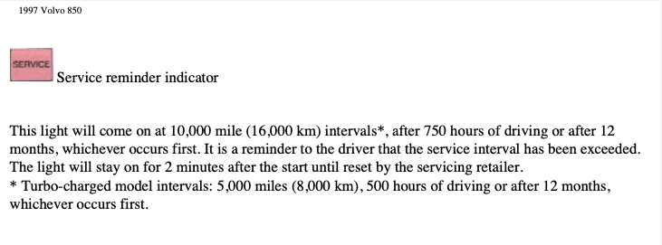

Filled up the gas tank, and checked the oil on the 850. Oil is low, and the service light just started coming on a day or two ago. I'm surprised the service light came on, as it's low miles since the last change, but maybe time factors in it too.

Oil service light is time based. Not too clever, but just a basic reminder every 6 months.

You can change the service light interval and reset it using the "850 OBD-II" app made by xiaotec, and a compatible ELM327 OBD-II reader.454cid wrote: 24 Sep 2023, 18:33 Filled up the gas tank, and checked the oil on the 850. Oil is low, and the service light just started coming on a day or two ago. I'm surprised the service light came on, as it's low miles since the last change, but maybe time factors in it too.

Yes, I actually have that. I've used it to reset the light, but don't recall what the interval was. I haven't really explored that feature.ZionXIX wrote: 24 Sep 2023, 19:30You can change the service light interval and reset it using the "850 OBD-II" app made by xiaotec, and a compatible ELM327 OBD-II reader.454cid wrote: 24 Sep 2023, 18:33 Filled up the gas tank, and checked the oil on the 850. Oil is low, and the service light just started coming on a day or two ago. I'm surprised the service light came on, as it's low miles since the last change, but maybe time factors in it too.
