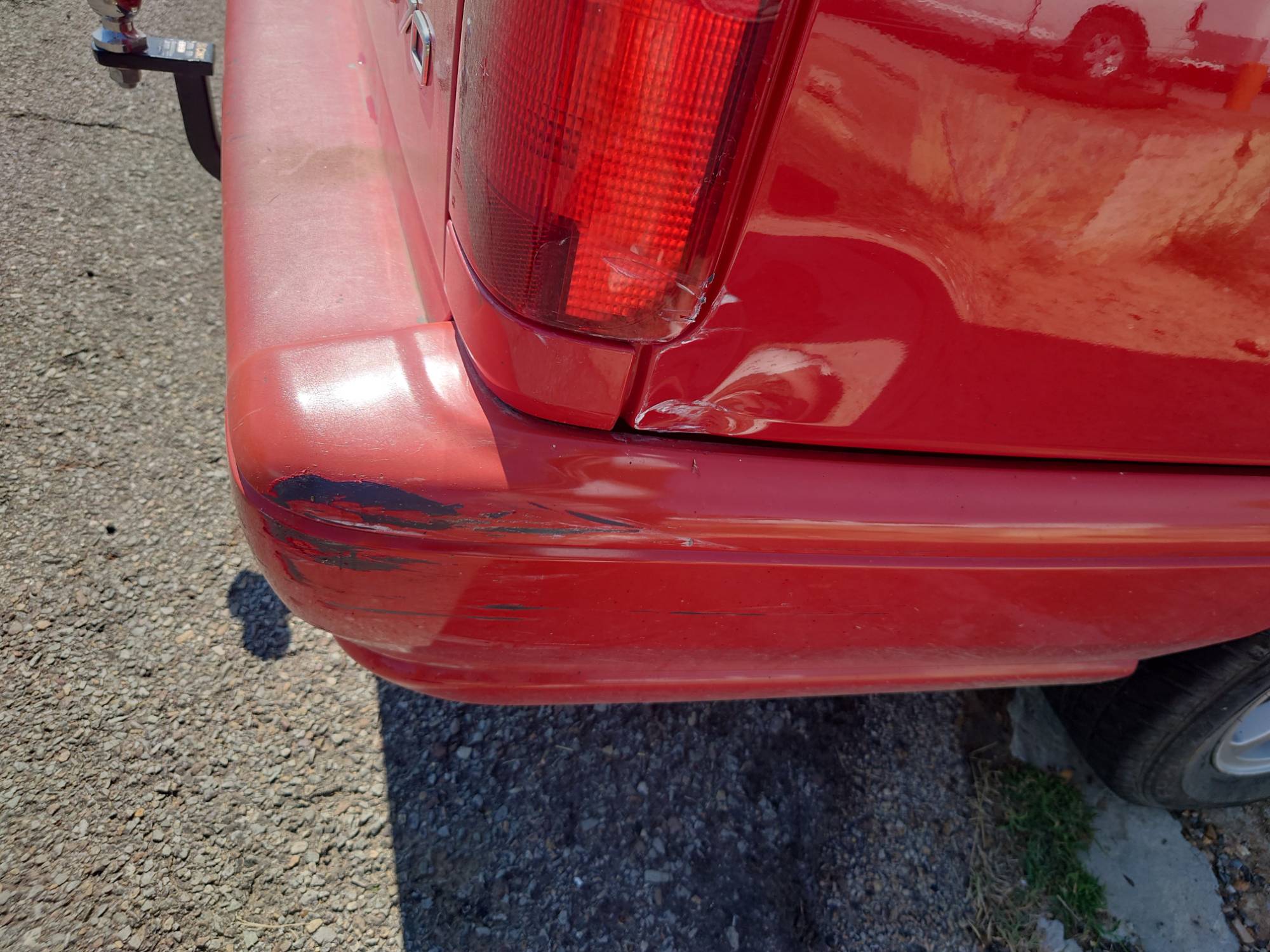

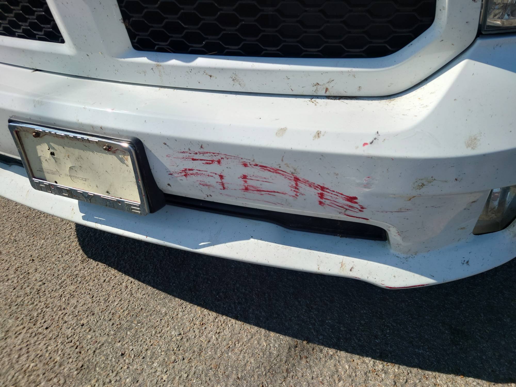

First update: Yesterday, I got a minor hit by a Choctaw Nation white dodge ram 1500.

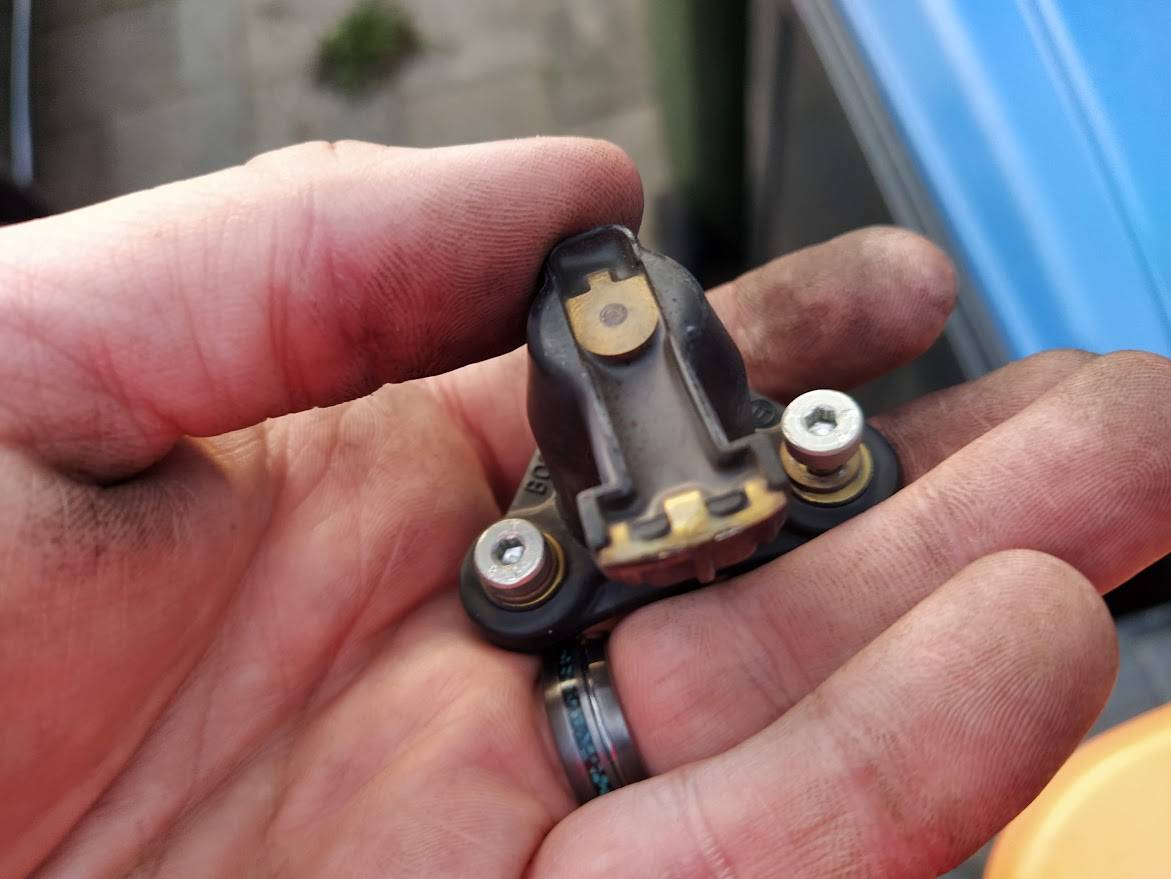

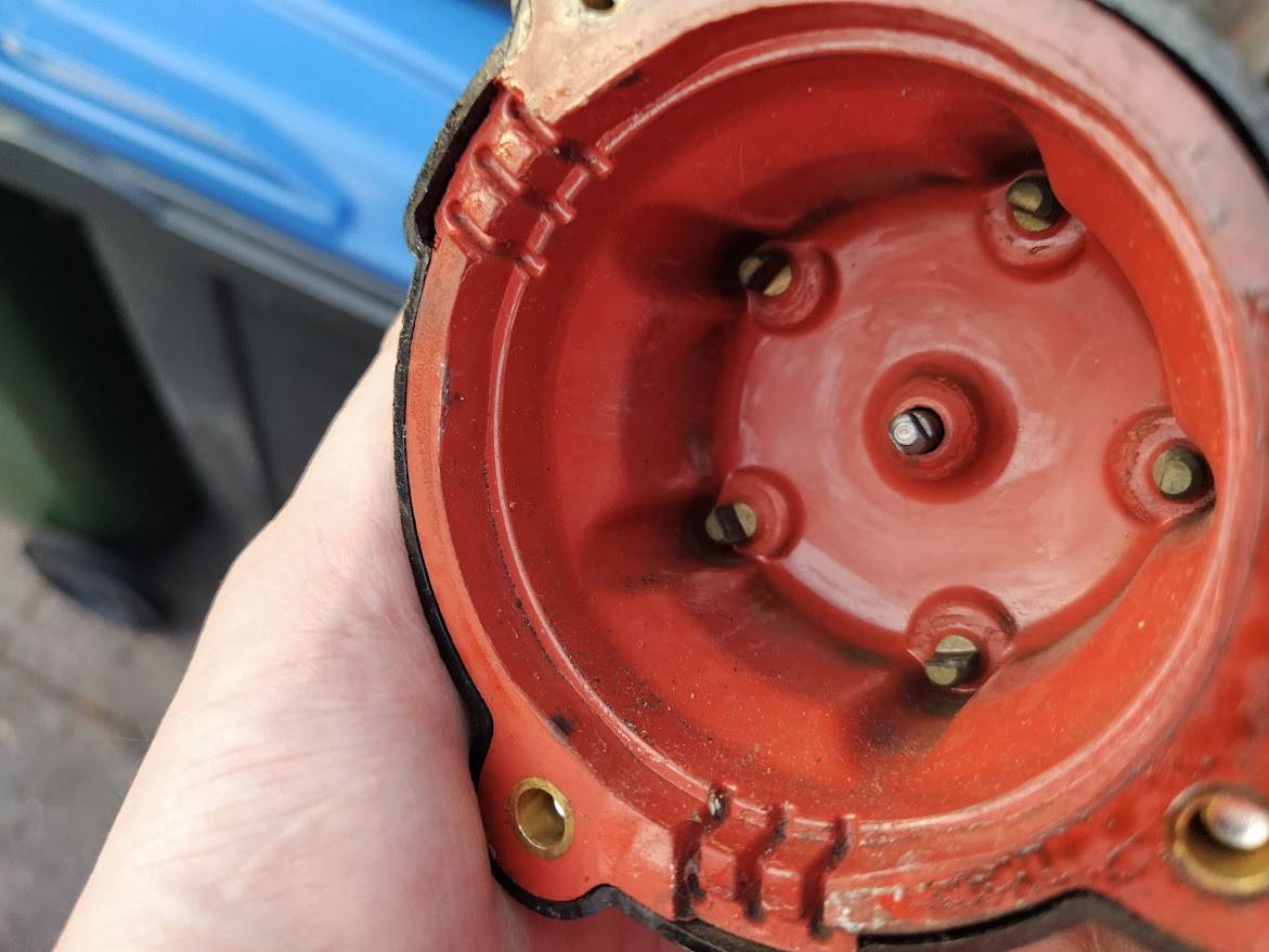

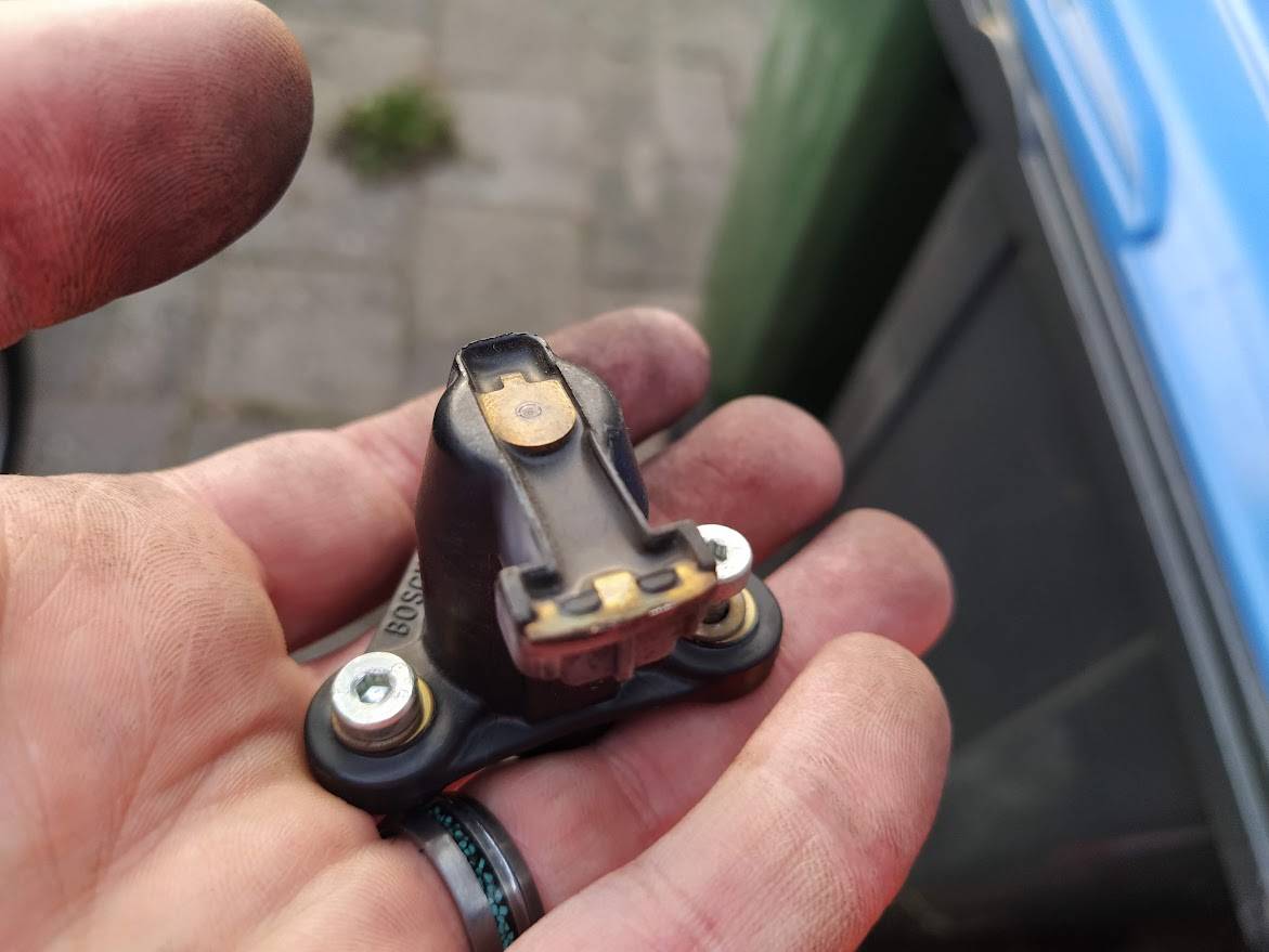

So, yesterday I changed the distributorcap and rotor. They've been on there for more than 80.000 kilometers, so it was time to change the parts. I cussed at my phone because it didn't really focus right, so the pictures are a bit blurry, but you can see it was time to change the parts.
I've read on MVS that the change interval of the distributorcap/rotor is somewhere at 80.000 kilometers (roughly 50.000 miles) and the change interval of the spark plug wires is 160.000 kilometers (100.000 miles). Anyone here care to share their comments on that? I have a Dymo label printer and considering putting a sticker on the distributor cap with the mileage to change the part.

From what I know and remember the service interval for pre CanBus P80 cars (cap/rotor setup up to 1998) is 30k miles. That's what I have been doing for more than 20 years now. 50k miles is too much. Honestly, even 30k is pushing it because the cap and rotor are usually seriously worn. This is just my experience.Ocelot wrote: ↑02 Oct 2023, 05:19 So, yesterday I changed the distributorcap and rotor. They've been on there for more than 80.000 kilometers, so it was time to change the parts. I cussed at my phone because it didn't really focus right, so the pictures are a bit blurry, but you can see it was time to change the parts.
