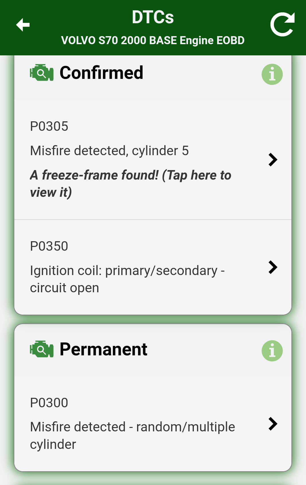

.MoVolvos wrote: ↑31 Oct 2023, 12:10The plastic cover was off so it was a huge mess on the coils. Will unplug all the connectors and clean tomorrow. Still a little drizzly here.bmdubya1198 wrote: ↑30 Oct 2023, 23:26 Definitely start by cleaning up all the oil. It the miss started after the oil cap was left off, it is possible that the oil contaminated the coils/plugs.
Took a drive to the UPS store about 5 minutes away. Started to run rough before getting there. When leaving it ran really rough. Had to stop and then nurse it and with the flasher on to get home. Barely moved from a stop then slowly bucking as it picked up speed.
Two of the coil is out from what I gather. Pulling the wire on two of the coils didn't make a difference in the idle. Swapped position with the good coils and the idle didn't change for the bad ones. Will swap them with the S60 2.5T to see if the issue goes away.

When I removed the first coil from the 07 S60 2.5T, the boot slipped right off as it was a little oily. Well, I didn't know from handling the coils in the S70 that they were 2 pieces. Thought it was a one piece unit. Replaced 2 of the bad coils and while at it decided to hot glue the upper mountMoVolvos wrote: ↑31 Oct 2023, 17:43.MoVolvos wrote: ↑31 Oct 2023, 12:10The plastic cover was off so it was a huge mess on the coils. Will unplug all the connectors and clean tomorrow. Still a little drizzly here.bmdubya1198 wrote: ↑30 Oct 2023, 23:26 Definitely start by cleaning up all the oil. It the miss started after the oil cap was left off, it is possible that the oil contaminated the coils/plugs.
In further driving the car something still didn't feel right. Found a 3rd coil with slight condensation in the boot but the body had a hair line crack. Decided to install remaining 3 coils and the engine noise and vibration are gone. The hot glue gun is just a temporary fix but it could well be a permanent solution or as a sort of insert to a new mount.
So basically 3 coils were on its last leg and perhaps the other two were weak. This explains the "P0300 Misfire detected - random / multiple cylinder". Car engine is now quieter, smoother with a little more pep and no vibration at idle.

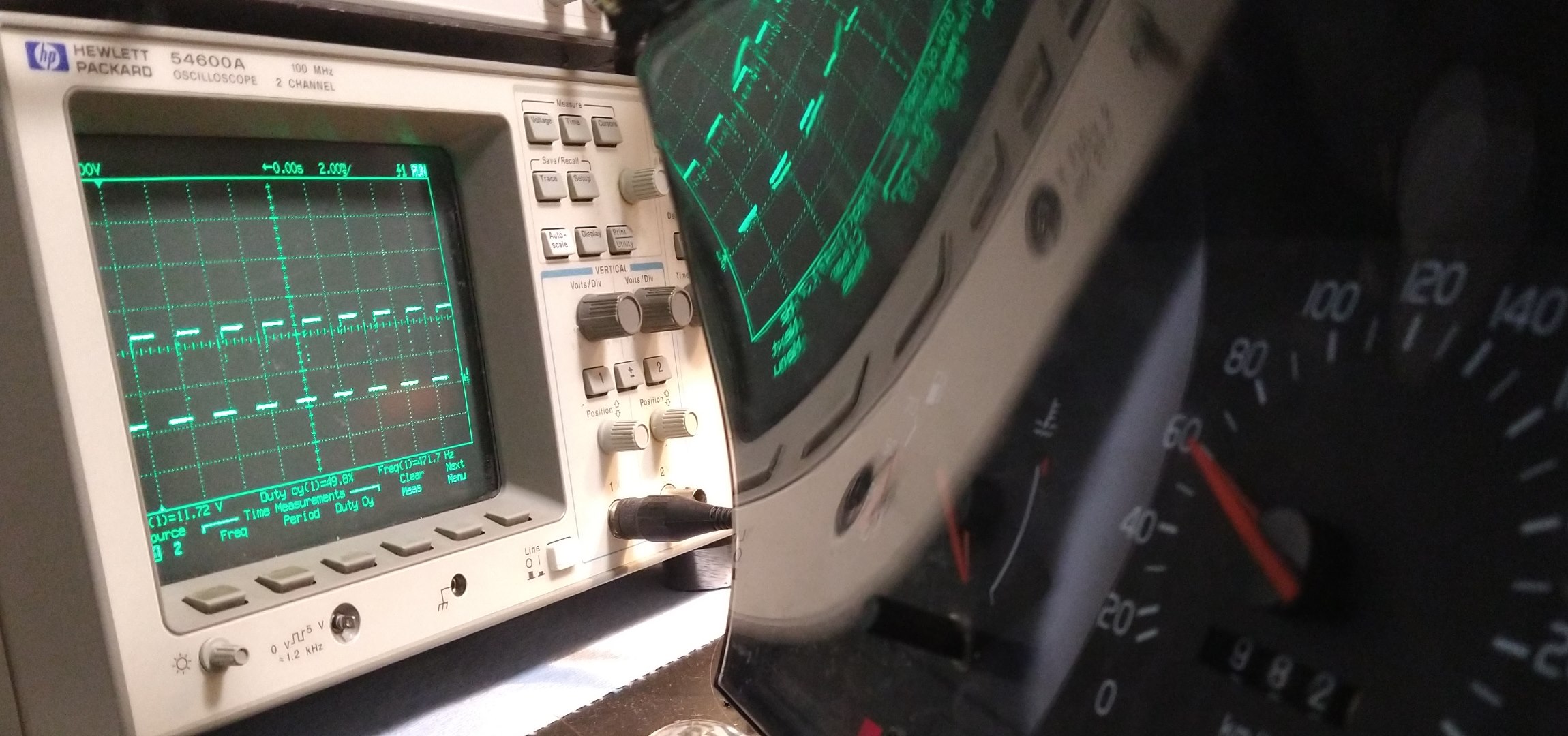

What Speed Signal from ABS module output to dashboard meter speedo input pin signal looks like.
Honestly. Volvo own information is confusing. If you check from ABS pins it shows correctly output being some like
"U= 0 - U Bat Voltage depends on position of front wheel"
But it wont say is it frequency or PWM or Voltage..
On COMBI or meter pin it says its oscillating so.. anyway throwing to trash Volvo own information and just to check and try which one it is..
Its Frequency based and 12V peak to peak (if use multimeter shows some like 6V).
If this helps people diagnosing when ABS module is corroded or something else wrong in their speedo to check if signal is there and is it right.

Yup, it should be a 12v square wave. I think they're just basic hall effect sensors.xanthefin wrote: ↑03 Nov 2023, 19:39 What Speed Signal from ABS looks like.
Its Frequency based and 12V peak to peak. If this helps people diagnosing additionally when ABS module is corroded.
http://xanthe.cc/pic/60kmhvolvo.png

Yes though i did mean not sensor output but what ABS module generates as output to COMBI/ dahsboard / meter speedo as signal as on these there is not invidiual sensors for speed as this signal comes from ABS module generated by it (or maybe it is just passed from front wheel sensor via ABS module to speedo input on meter directly).bmdubya1198 wrote: ↑03 Nov 2023, 21:05Yup, it should be a 12v square wave. I think they're just basic hall effect sensors.xanthefin wrote: ↑03 Nov 2023, 19:39 What Speed Signal from ABS looks like.
Thos invidiual ABS sensors yes mostly.
btw i just read they claim 25793 pulses per km so / 60 i get 429.. maybe someone wants dig deeper ?
