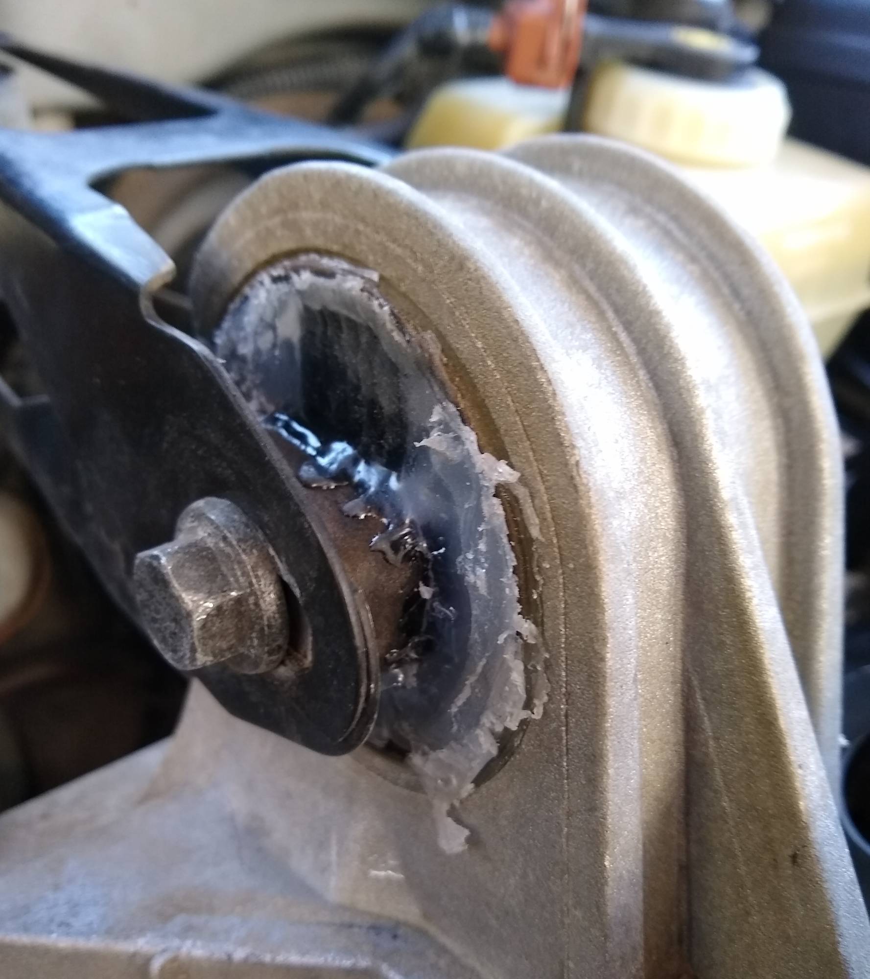

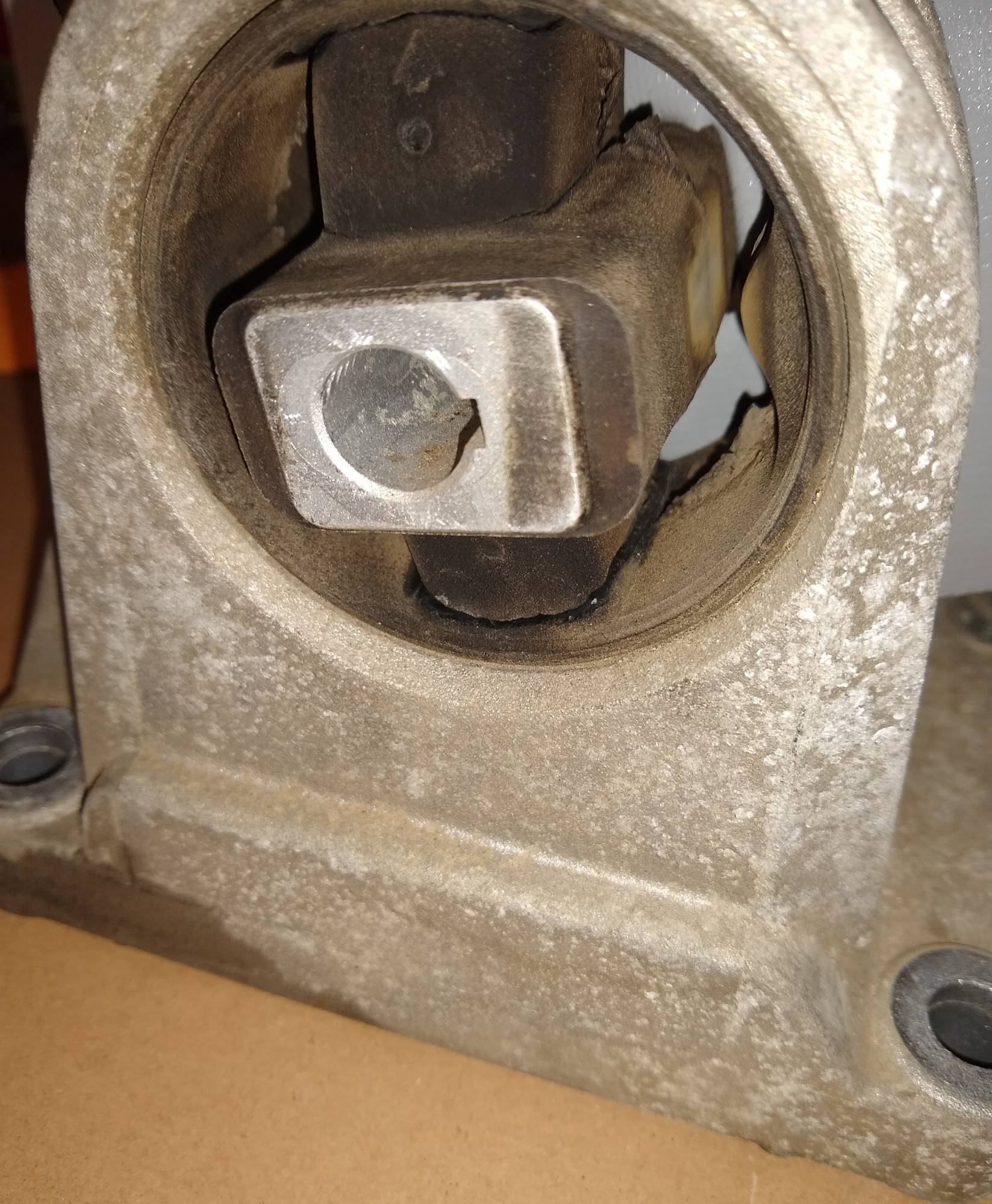

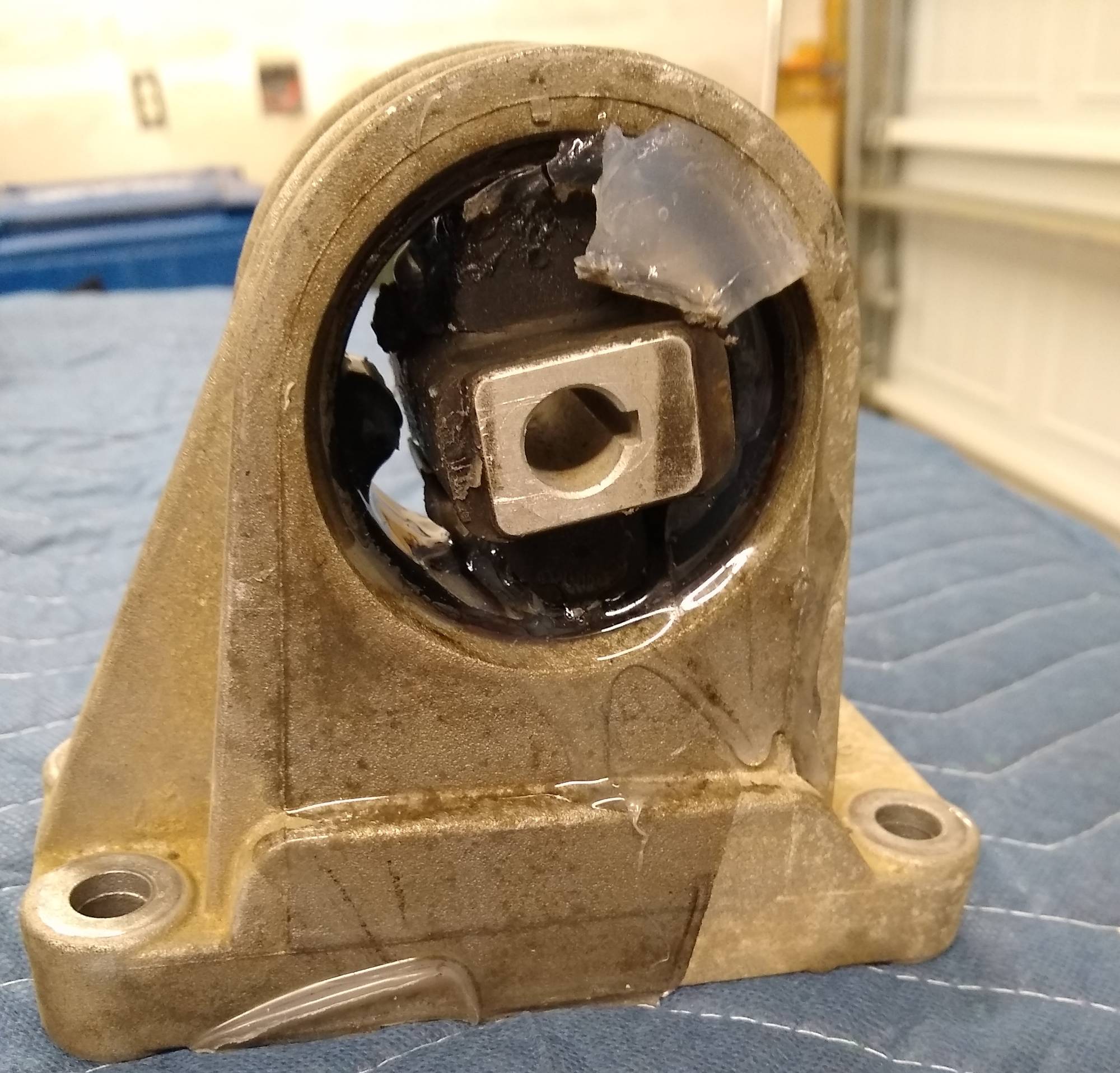

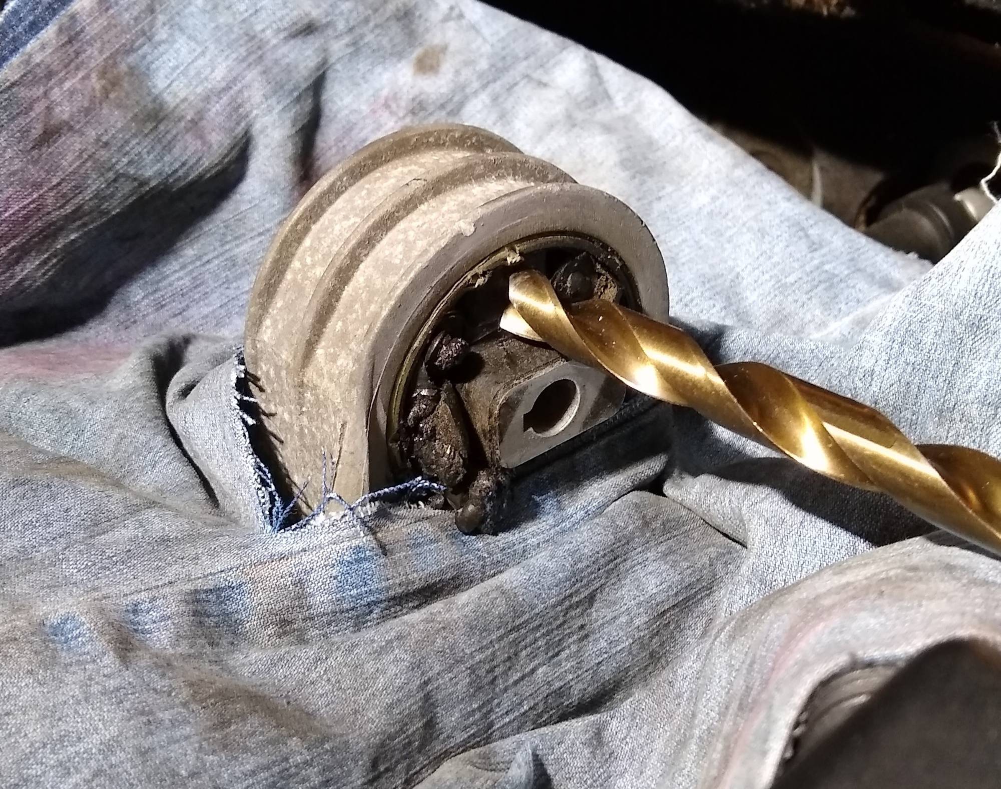

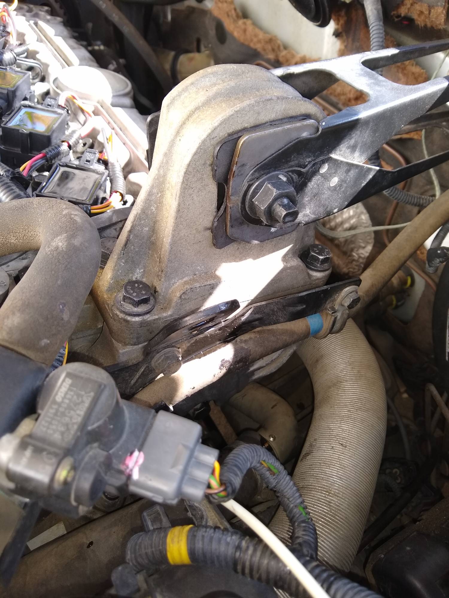

Below is for another post about a clunk in the transmission. I happened to installed the improved designed square upper mount from the S60 into the S70 as the hot glue flowed out and down... Clear wet sheen waterfall of glue down the mount and further with some onto the bell housing
Surprised at how much a difference an upper mount can make in the car. I've only changed 2 inserts previously and both were the round poly from IPD. One was for a 98 S70 T5 the other 03 S80 T6. The S70 was black while the S80 was the blue poly. Both cars experience a little more vibration and sound transmission into the cabin.
As for this current mount its turned into an experiment. From the pic you can see the mount had separated at the top and bottom so it's basically shifting from side to side in the mount. It's also deformed being the original with 150K miles. Vibration shakes the dash, glove box and makes the interior creak and squeak. There were also shifting clunks and bumps as the transmission go through it's paces shifting up and down. Lifting the throttle also produced some minor bump and clunks besides during braking. Thought this was just the S70 showing it's age or perhaps the front engine mount near the passenger wheel nearing collapse.
Decided to fill the mount with hot glue to see what the car would behave like with more of a solid mount. Like the poly the hot glue produced some vibration and sound transmission but the other noises including clunking, jolts in shifts and interior noise were all reduced substantially.
This experiment didn't last long as the hot glue melted and flowed out of the mount with engine compartment temp. Since the S60 is out of commission I referenced both FCP and IPD to confirm the square and round upper mounts are interchangeable for the S70 and S60. Perhaps it's the improved square design but the interior is serene compared with the broken and hot glue setup. Dash no longer rattles, shifts off the line is quick and the car interior, kind of hard to describe but like being in the cloud or pillowy as overall cabin sound is greatly reduced and isolated from the exterior. I'm pretty sure I won't go with the round poly seeing how even a used square design has isolate the interior from noise and vibration and made the driving characteristic so smooth and fluid.

I squeezed the remains of an old tube of caulk into a broken firewall mount that had the center metal bushing completely separated and it seems to be pretty strong while still having some give. Just had to pay attention and keep the bushing centered while I put it down to dry.MoVolvos wrote: ↑09 Nov 2023, 17:24

jsrnsis wrote: ↑10 Nov 2023, 05:13I squeezed the remains of an old tube of caulk into a broken firewall mount that had the center metal bushing completely separated and it seems to be pretty strong while still having some give. Just had to pay attention and keep the bushing centered while I put it down to dry.MoVolvos wrote: ↑09 Nov 2023, 17:24
What did you use? The high temp chaulk I used did not dry all the way through so wasn't hard. I inserted some thick radiator hoses and filled with the high temp chaulk. Winded up oozing a little.
Though the hot glue was sufficiently hard it couldn't with stand the engine heat. Imagine if the glue stick could handle the heat. Two large sticks was sufficient to fill it.
