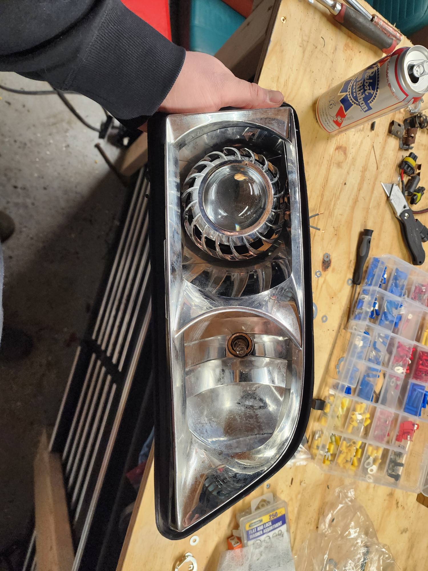

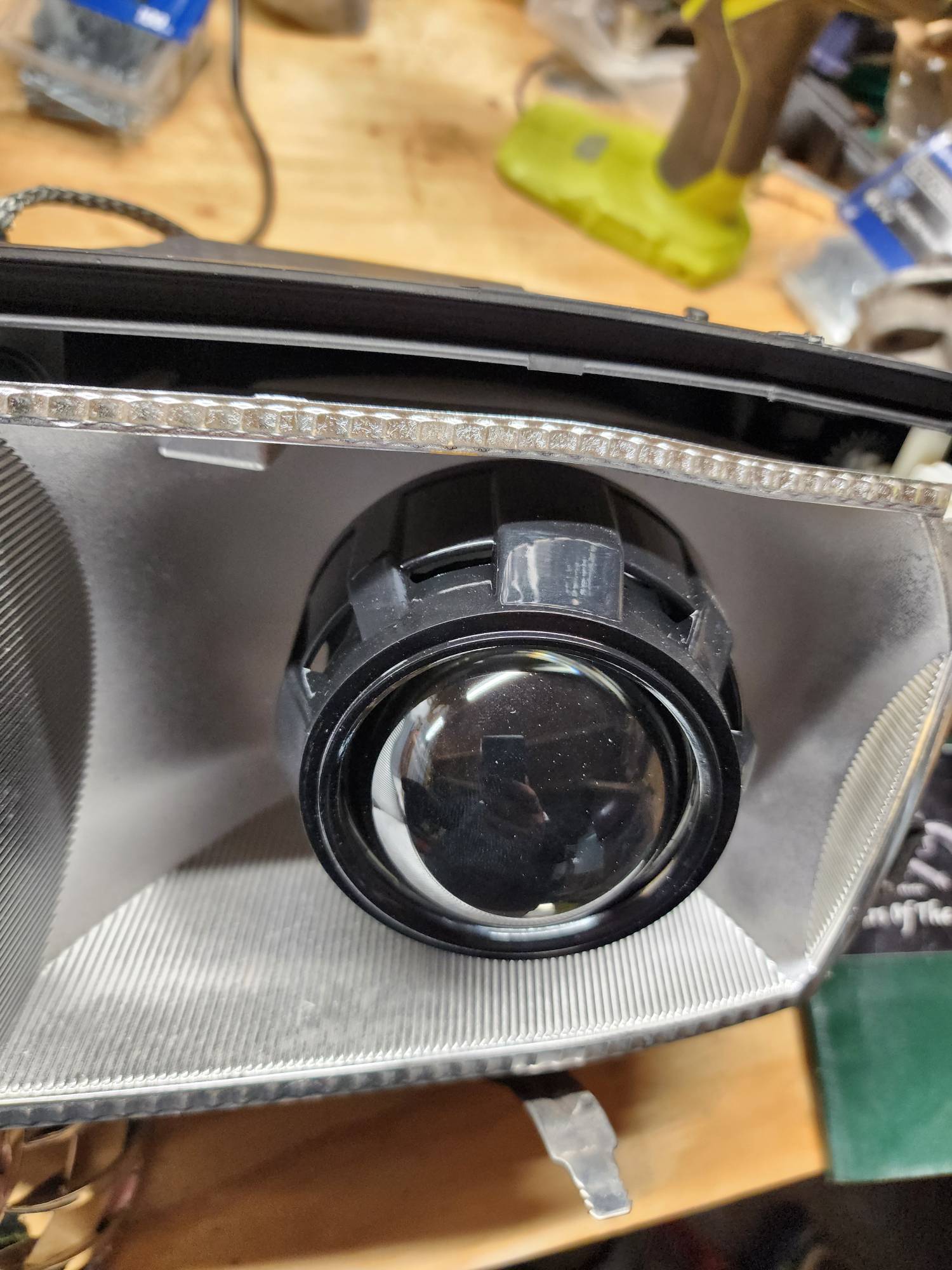

Rebuilt my headlights and used my jewels. Finally hooked up the high beams as well. Once the cars running again, I'll pull it outside and adjust the beams before I put the glass back on.
Any sort of glass polishing techniques would be appreciated lol.

levalexi wrote: 16 Jan 2024, 02:58 Rebuilt my headlights and used my jewels. Finally hooked up the high beams as well. Once the cars running again, I'll pull it outside and adjust the beams before I put the glass back on.
It's my understanding that glass can be polished with Cerium Oxide, but that's about all I know.

If I recall correctly, you can use Brasso, baking soda, or even toothpaste.
