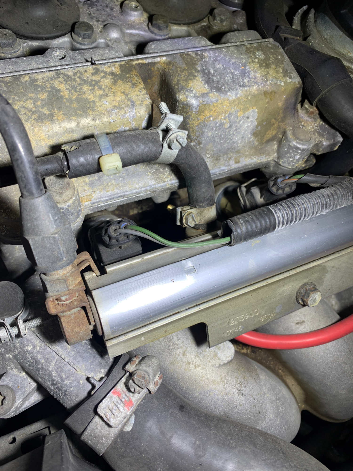

This is the 95, it's been on there a while. Notice the (non-Oetiker) clamp I slid over to near the bend as insurance against a possible kink. And the zip tie (gasp!) I installed in its place!

Good old high pressure zip ties!
