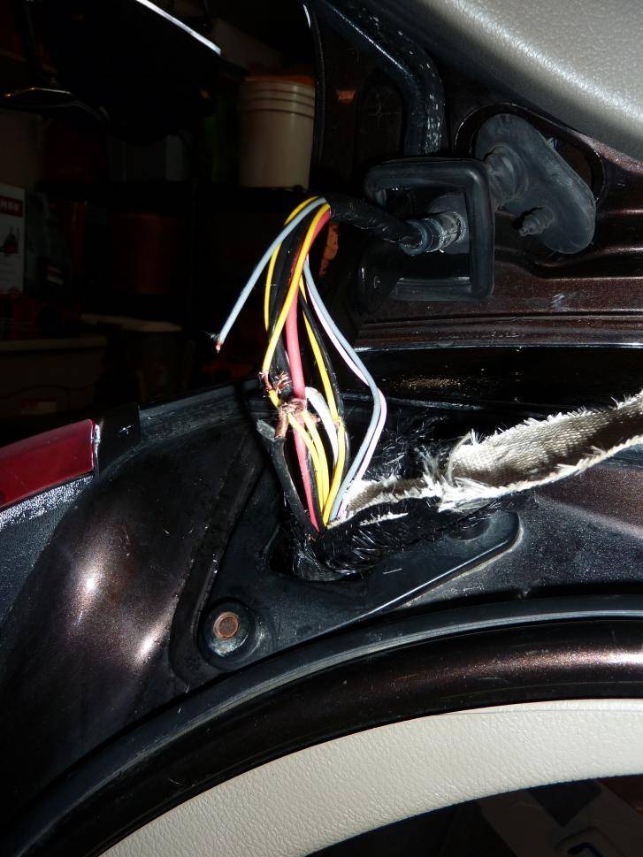

There are two switches in the door lock assemblies, one switch is the locked/unlocked switch and the other is the door closed/opened switched. It sounds like you have a flaky switch or wiring that's opening the door opened/closed switch intermittently when it's shouldn't, which is giving you the door ajar message and this will also set off the alarm if the switch opens up after the anti-theft system (when all the doors are locked) is set. It's not uncommon for the switches in the door assemblies to become flaky, I've replaced 3 of 4 door assemblies over the years for this reason. Sometimes it just takes a rough road to cause one of these switches to open when it shouldn't and other times it can be cracked, broken wiring, such as in the left hinge area of the tailgate, which is a known problem.
In your case it sounds like the driver's door lock is the problem but you're also seeing messages for the rear doors and tailgate, which might indicate a different problem than just a single switch. I'm not sure what the problem is if this problem is coming for multiple doors, it's typically one door or the tailgate and one switch or wiring to one switch that's the problem.

Cracked wiring in the left hinge area of the tailgate that can give you a tailgate open message or set off the alarm intermittently.
