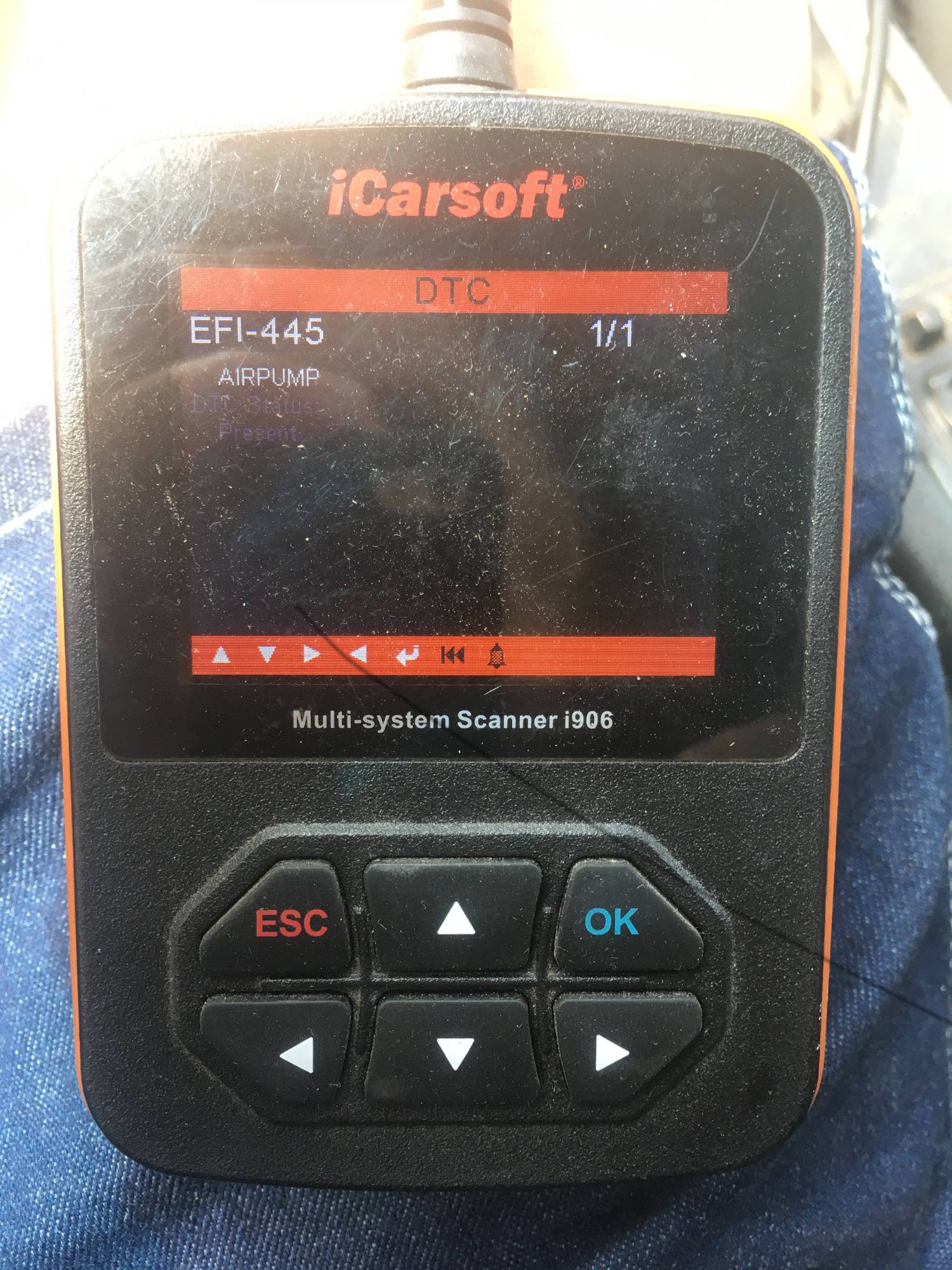

EFI-445 airpump code

SAS system air pump fault code.
http://volvospeed.com/vs_forum/topic/14 ... with-pics/

I've had that P0445 code too, and there are several hoses and valves that can crack or clog and cause it. There are descriptions of various items to check here: viewtopic.php?t=65783

That's an EVAP code, not an SAS (i.e. air pump) code. I'd check all the EVAP hoses first, especially near the canister.

Hmm... interesting.erikv11 wrote: 27 Jul 2022, 08:50 That's an EVAP code, not an SAS (i.e. air pump) code. I'd check all the EVAP hoses first, especially near the canister.
