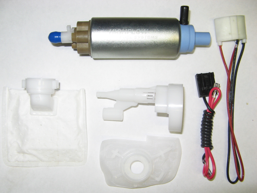

I purchased a pump, from highflow fuel systems (http://highflowfuel.com) though ebay last year, brand new 1 year warranty, it was about $80 with shipping. Highflow part number HFFS-340, it wasn't an exact match (shorter by about 1/2") but I needed a running car and long story short, it runs out of gas with around 2 gallons in the tank. I spoke with highflow on the phone and they sent me a replacement under warrenty. The replacement is basically identical in size and shape to the original walbro GRJ 235 and actually for a Dodge Neon SRT (highflow part number HFFS 377H). I have attached a picture from highflow of the kit they send you, this is their store brand pump, they also carry a walbro brand pump of the same type. I would definitely recommend them, fast shipping and knowledgeable staff, but call them to place an order so they know it's an AWD car and what the original was.

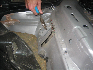

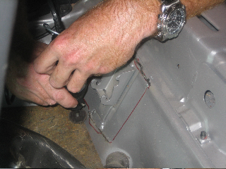

Found it. The fuel pump is located directly underneath the right most passenger seat bottom hinge. I used a Dremel tool and a cutting wheel to cut the panel. I went through 4 cutting wheels. But the Dremel allowed me the precision to go shallow on the cuts. If I would have used a die grinder.... I would have cut the fuel lines. Be careful!

Here are the picture files. Please email me [email protected] if anyone has any questions. It worked great! A few small lessons along the way but overall much better than dropping the rear end.
It looks like you have some kind of fastener to hold the cutout in when you put it back, but it's hard to tell from the pictures. Can you describe that?
