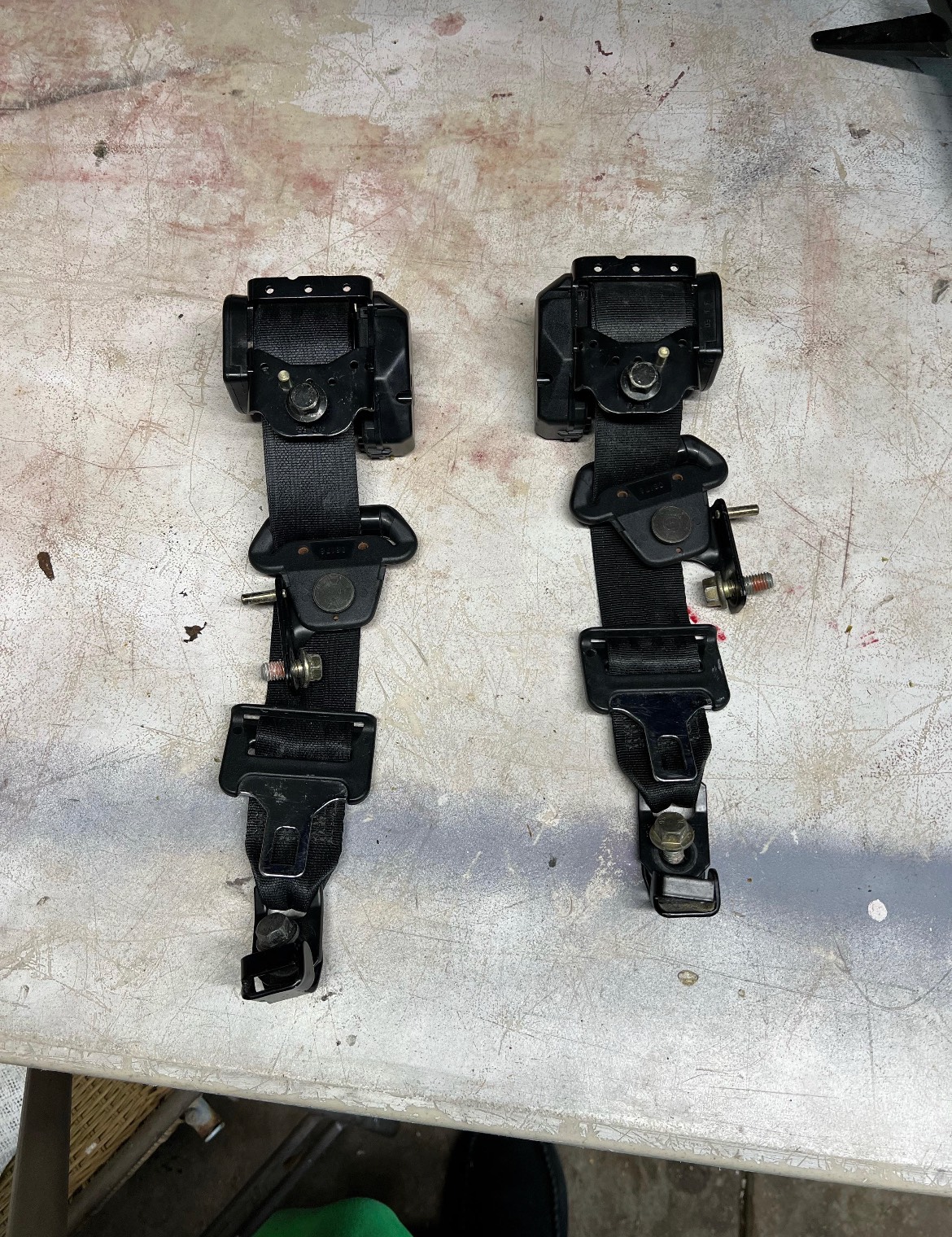

Stuck Seatbelt Assembly
I got the seatbelt assembly for my 3rd row rear facing seats, but the belt is stuck at the top and won’t release. They are currently out the car, I can’t seem to spot a release button or anything. Any help wold be greatly appreciated!

I can't recall if they have an orientation sensor in them to prevent release should the car overturn.
You may have to try and orientate them as they sit in the car to get them to release. If they have been pulled on you may have to see if you can find a way to help them retract a short way to release the mechanism.
