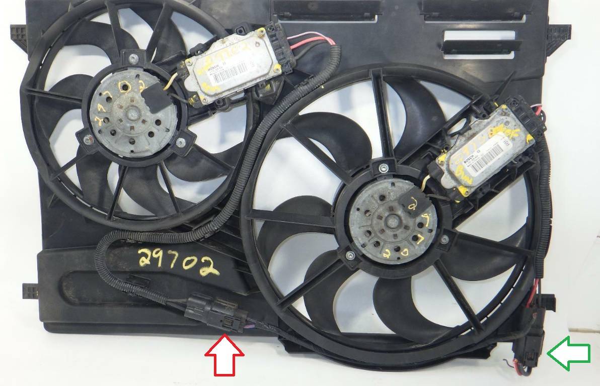

In my 2008 XC70, the original radiator fan set up had 2 fans. Evidently, Volvo now replaces these with a 1-fan system. I just installed the 1-fan system myself, and it is working, but I have an extra fan plug just dangling around not being used... I'm afraid the single fan isn't going to operate at all speeds or something.

The radiator fan wasn't working all the time, and the radiator had a leak in it. I replaced both those, and I read that it was a good idea to change the thermostat, so I did that too.
I ordered OEM parts from FCP Euro. They are the ones that told me the 1-fan system had superseded the old (original) 2-fan system.
So far I've let the car idle for 20 min, turned on the A/C for a good while, and taken it for a 20 mile test drive. All is well. No coolant warnings. Fan is running. A/C works. But again, I just don't know if the single fan has full capability.

GarrettB11

Hi pgill,
Thanks for some info.
I replaced the original dual fan, which had a controller for each fan, with a single fan that has a single controller.
The part number is: VOL-31686806
Part of my concern is that, the original dual fan had 2 plugs---once at each fan controller. Now, I just have a single-fan and am using the plug that had been going to the old large fan, and the other small plug is just sitting there not being used.

Garrett,
The Dual Fan for a 2010 S80 3.2 is 31686808 (this is exactly the fan that I installed in my LR2 it even came in a nice Volvo Box)
The single Fan is in fact 31686806 which is what you have
Both of these fans should have a single controller and a single connector with three conductors
B+ - Battery Plus
B- - Battery Minus
Control wire - a small wire that sends a PWM (Duty Cycle) to the controller.
I did a quick search and I found that Volvo has used a dual fan in a S60 that has two motor controllers and it is possible that someone modified you car's wiring harness to use the fan with dual controllers.
Take a careful look at the wiring to see if has been modified. If it has then they likely just spliced into the three conductors and if that is the case then the extra connection isn't much of a concern.
Post some pictures if you get a chance.
Take care
Paul
PS I did a little more research and here is what I found.
When you removed the Old fan you were suppose to disconnect the cars wiring harness from the Fan's wiring harness at the green arrow.
But instead you likely removed the connection at the red arrow and then you plugged into the new controller and now you have extra wiring.
Just remove the extra wiring and plug directly into the controller.
