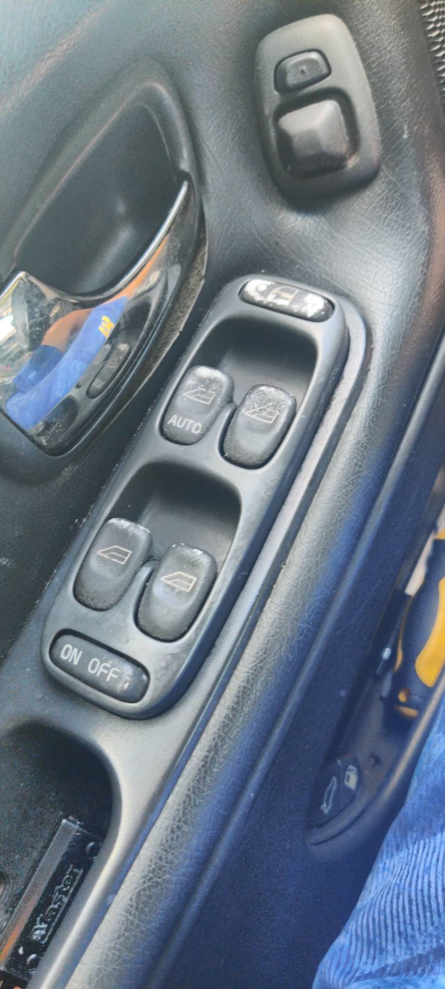

1998 v70 GLT driver window switch pack
surfbug1
- Posts: 195
- Joined: 13 September 2006
- Year and Model: 1998 V70, 2006 S80
- Location: Tysons Corner VA
- Has thanked: 41 times
- Been thanked: 9 times
- IMG_20220922_141256_DRO.jpg (176.2 KiB) Viewed 212 times
- IMG_20220922_141300_DRO.jpg (223.73 KiB) Viewed 212 times

Hello Big Al….google switch Doctor and you will get a decent replacement for about $25-30
I’m running 2 on my cars, but SWMBO GETS VOLVO is the rule in my house

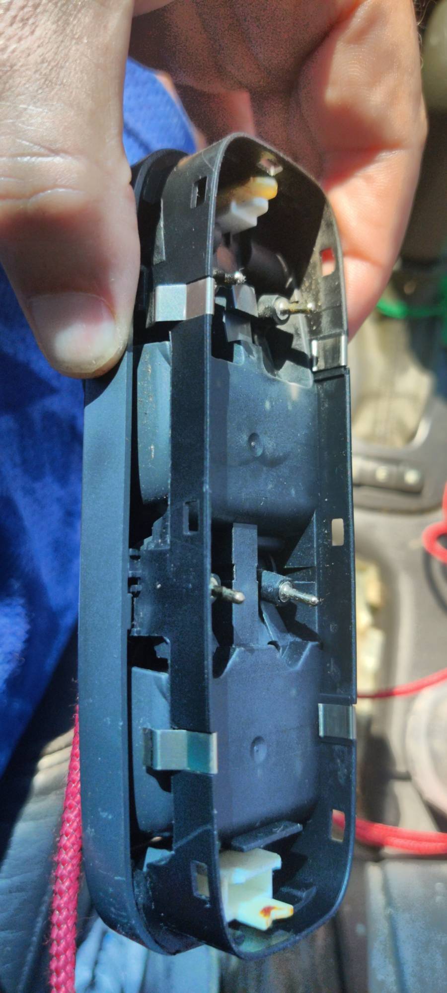

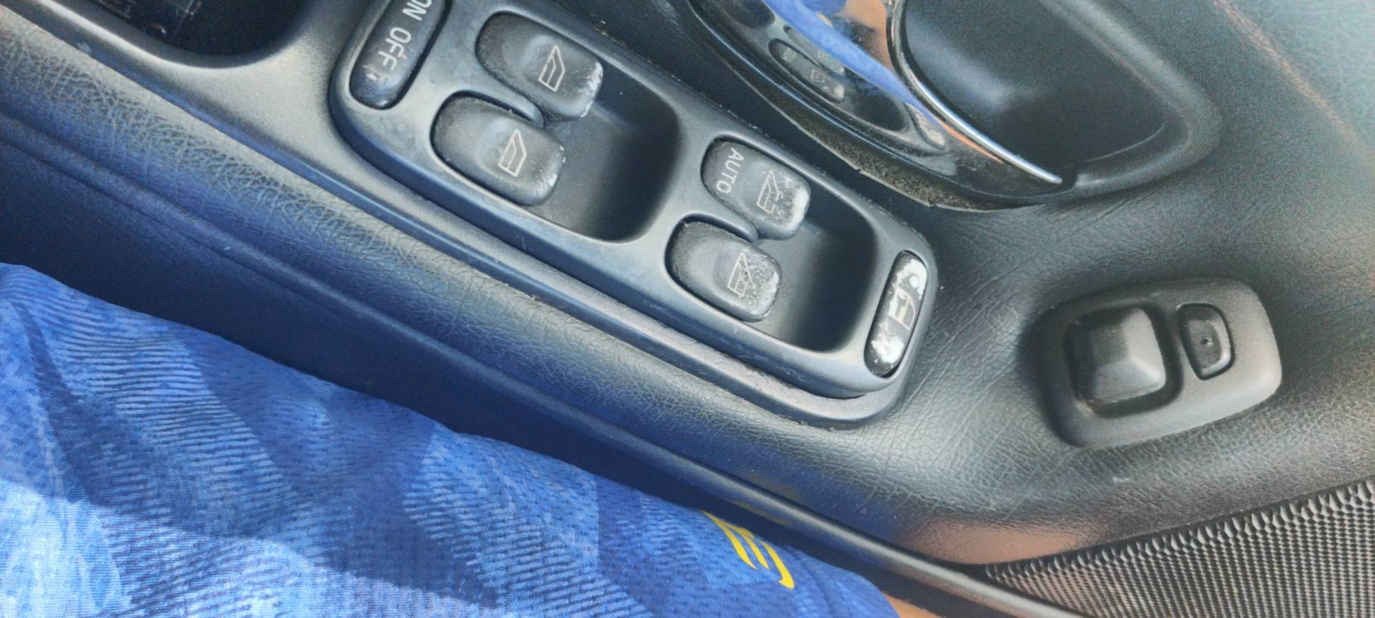

Hey hey! Thanks, I actually got to take mine apart after a Google search.
Very simple to do, just be gentle.
There was all sorts of dust and fuzzys inside.
Scrape off with a small screwdriver, and blast with contact cleaner and WALA-!!!!!
it's working ....
it's working ....
