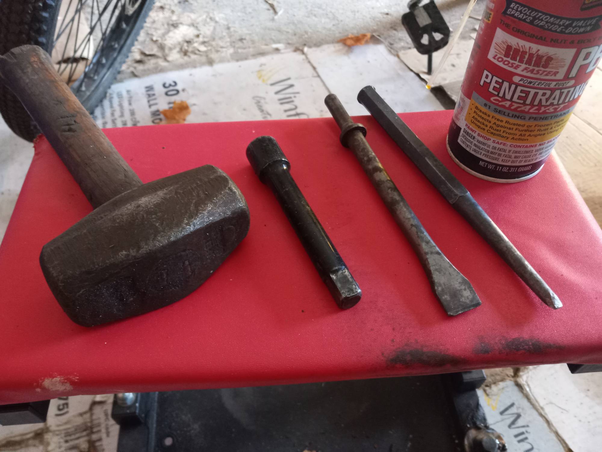

drench the driveshaft with your favourite spray, front and back.AylmerQc wrote: 05 Oct 2022, 16:03 While I struggle with an aforementioned fob issue with my 07 XC70, I thought I'd replace the ABS ring. I can't remove the splined shaft from the knuckle, it just won't budge so I thought I'd take the knuckle and shaft to a machine shop, or garage, but now I'm struggling with the lower ball joint. I've watched videos where they use a brass punch and a bit of prying, after removing the two bolts on the BJ flange but I'm not having any luck. Even loosening the lower BJ nut and using a jack to push up on the BJ threaded bolt doesn't free it from the control arm.
I do have a fork-type ball joint separator tool but it would more than likely damage the boot on the ball joint.
Do other types of separators work on this model car or does it need a specific OEM separator?
Drive the splined shaft out with a 3 lb mini sledge hammer and punch.
A 1/2 inch ratchet wrench extension is ideal as a punch.
then use a chisel and the same 3 lb hammer to drive the balljoint out.
