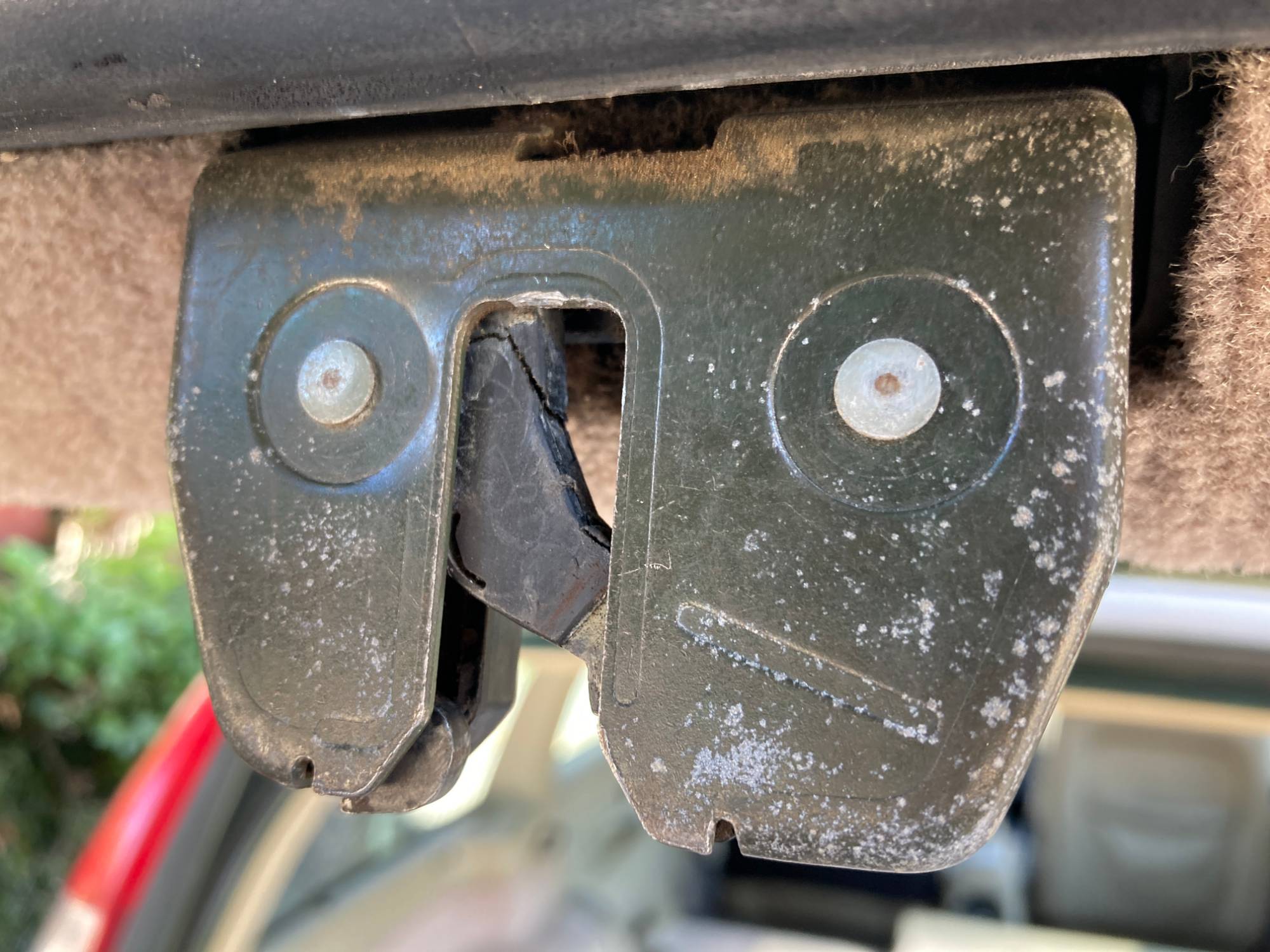

Well, while messing with the tailgate latch in preparation for bungeeing it over a couch in the rear of my trusty '98 wagon, I locked the latch before closing, and then attempted to close the tailgate. The closed latch hit the metal 'catch' on the tailgate floor and got jammed further into its housing, and while I was eventually able to free it, I noticed that some part of it had been broken (little bits of plastic fell off).
Now, while the lock/unlock mechanism is still working fine, enabling me to close the tailgate and lock/unlock it, the tailgate is free to move about 3 inches, even while locked.

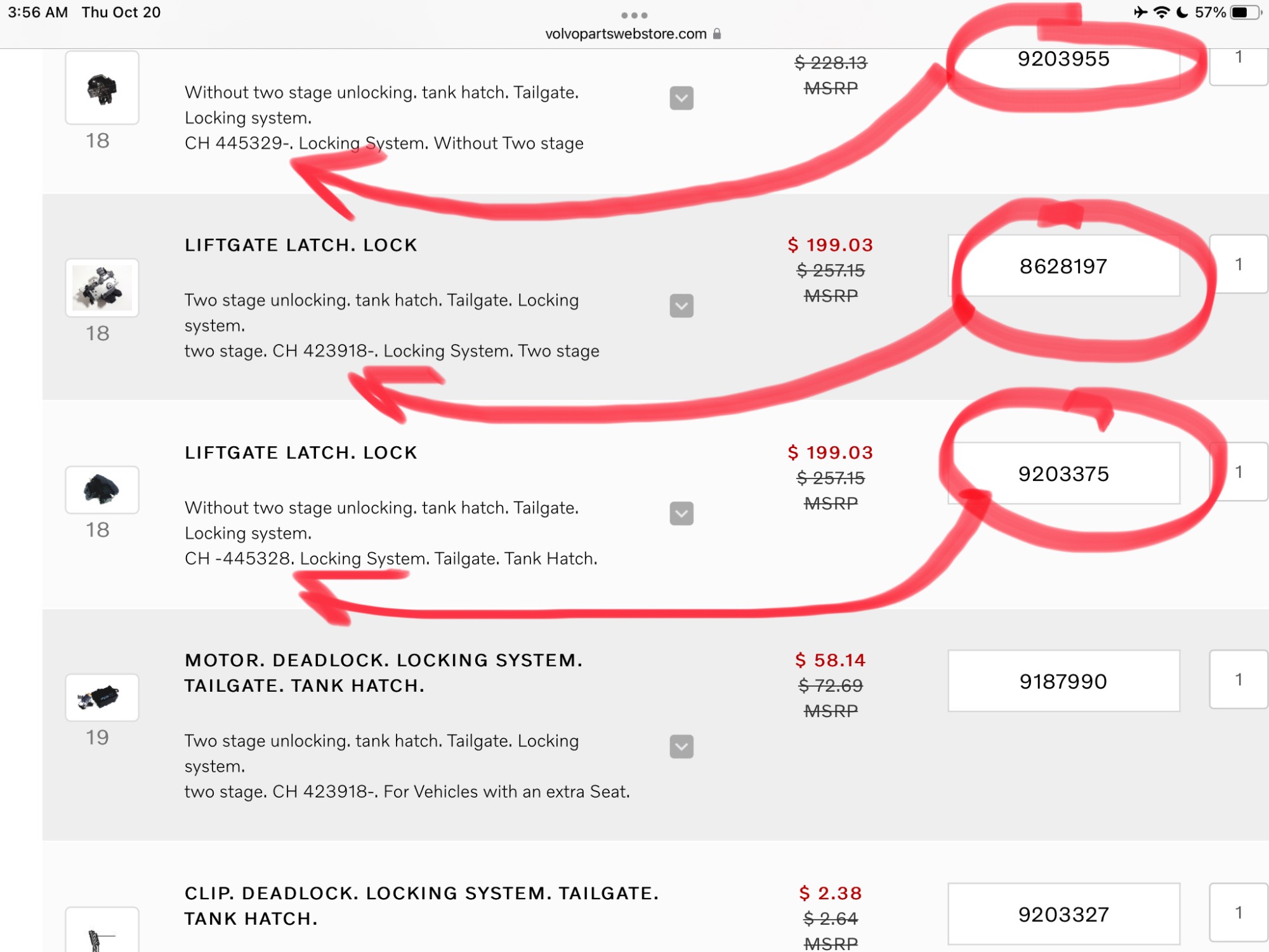

There are two diff latch mechanisms for a 98 V70, it was a split year as per the chassis break on the FCP page. I don't recall the distinction but I've had to swap both kinds ...
- Posts: 36147
Two different styles and a chassis break in 1998…erikv11 wrote: 20 Oct 2022, 00:59 There are two diff latch mechanisms for a 98 V70, it was a split year as per the chassis break on the FCP page. I don't recall the distinction but I've had to swap both kinds ...

OK these comments are validating, thanks all. Sounds like I need to replace the latch, and I should get the part I linked above (2-stage).
I took some photos of the latch and the latch bar. I think the nylon that the latch touches is still intact (it only wraps around part of the bar). Is the whole bar supposed to be wrapped with that nylon? Can't tell if the bits of plastic that broke off came from the latch itself or from the bar.
I checked and the wiggle of the tailgate, when closed/locked, is more like 1-2cm, not 3 inches. Looking at the latch itself, you can see it's somewhat cracked. I'll check out the other threads for information on how to accomplish the swap, fingers crossed it goes smoothly.

Agreed, latch is the issue not the striker plate. I'd get a part number from the latch you have, to know for sure which one you need.
You've got the right idea going forward. The swap is easy, the challenge is getting the tailgate trim off without things splintering into pieces. Especially around the interior handle.

My car was a halifax production 98 v70 so i suspect it was a later year. It also did not have a rear lock/key hole if it helps. Fit instantly with the newer model one. It did look different from my old latch but mounting, power, everything else fit correctly. The locking indicator arms were different and i had to use the ones from the donor car. If you grab it out of a donor, grab the lock arm indicators as well.
