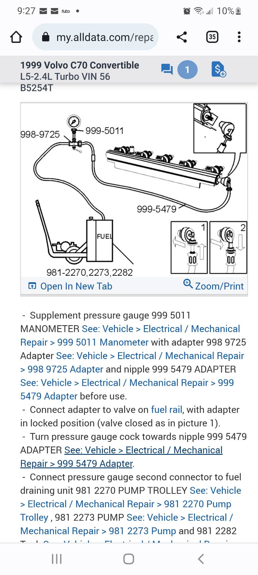

Hi hoping you can help I was called out to look at a 99 c70 turbo and it won't stay running have to floor the gas to get it to ignite runs rough. Customer said it was fine and then randomly stalled. Schrader valve at rail spits fuel but when I put a guage on it I didn't get any pressure Wich I didn't understand there's a process involving pumps and tanks on alldata to check fuel pressure. Plugs are new. Ets light is on engine temp sensor is open , replaced sensor circuit still open. Just learning you need an expensive tool to test ecu pins , wondering where you would go from here 220k miles. Car looks meticulously kept underneath.

Hey Neil sorry new to the forum and didn't realize I had posted twice I review your answer on the other post and here is my train of thought. I plan on trying to jump the relay but when I depressed the valve on the rail a steady stream of fuel comes out. Alldata has a process involving pumps and a trolley and adapters and I'm wondering if that's why I'm not getting an accurate reading my kit had an adapter that screwed right onto the Schrader so I just tried it that way and got 0 . I will post the process alldata has below. Also is there a sure way to diagnose the etm? I also plan on testing the engine temp sensor voltage with a multi meter at where the harness connects to the sensor and I believe I should get 5v? If I don't how far can I trace the wire ? As I understand it's wrapped up and extremely hard to access and the only way to test the ecu pinout is with a breakout box. If the engine temp sensor is not getting any power I was thinking maybe a problem with relay number 1 the fuel system not fuel pump relay 103. As I understand if this is out ecm will not get power ? And injectors will not spray into cylinders.
