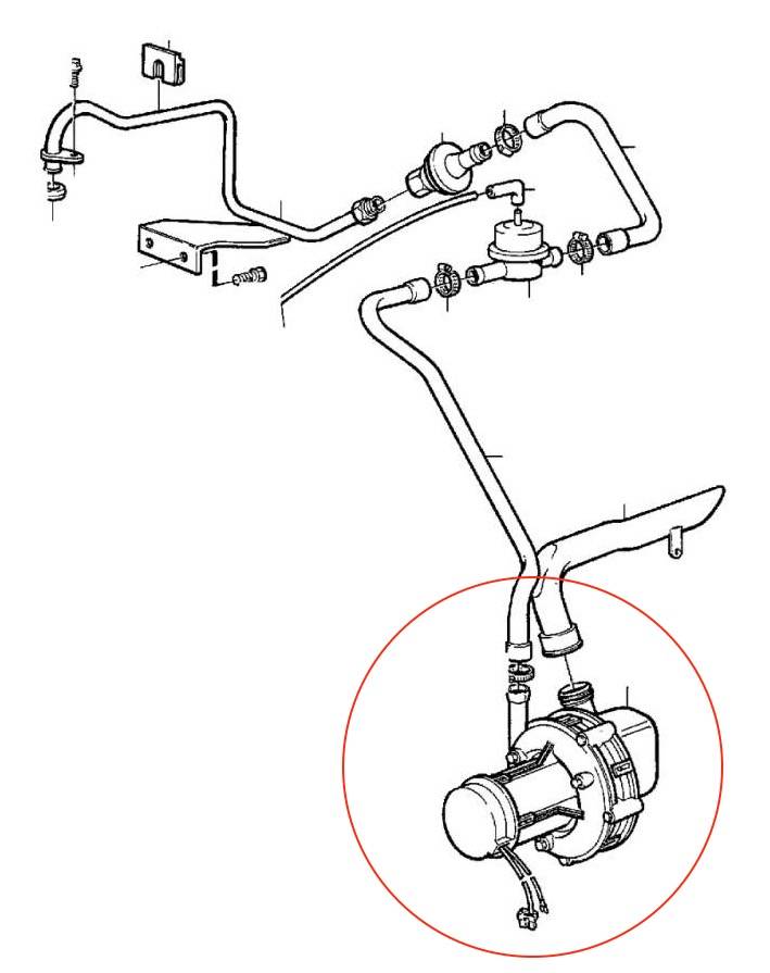

Hy,
Can someone tell me where this part is under the hood ? In the battery area ?
Exhaust emision control.jpg (51.58 KiB) Viewed 273 times

If you have it, it is under the battery tray. It is on turbos, but assume the same for NA motors.

Looks like an air pump for SAS system but Jetronic management and '95 doesn't have SAS system.
