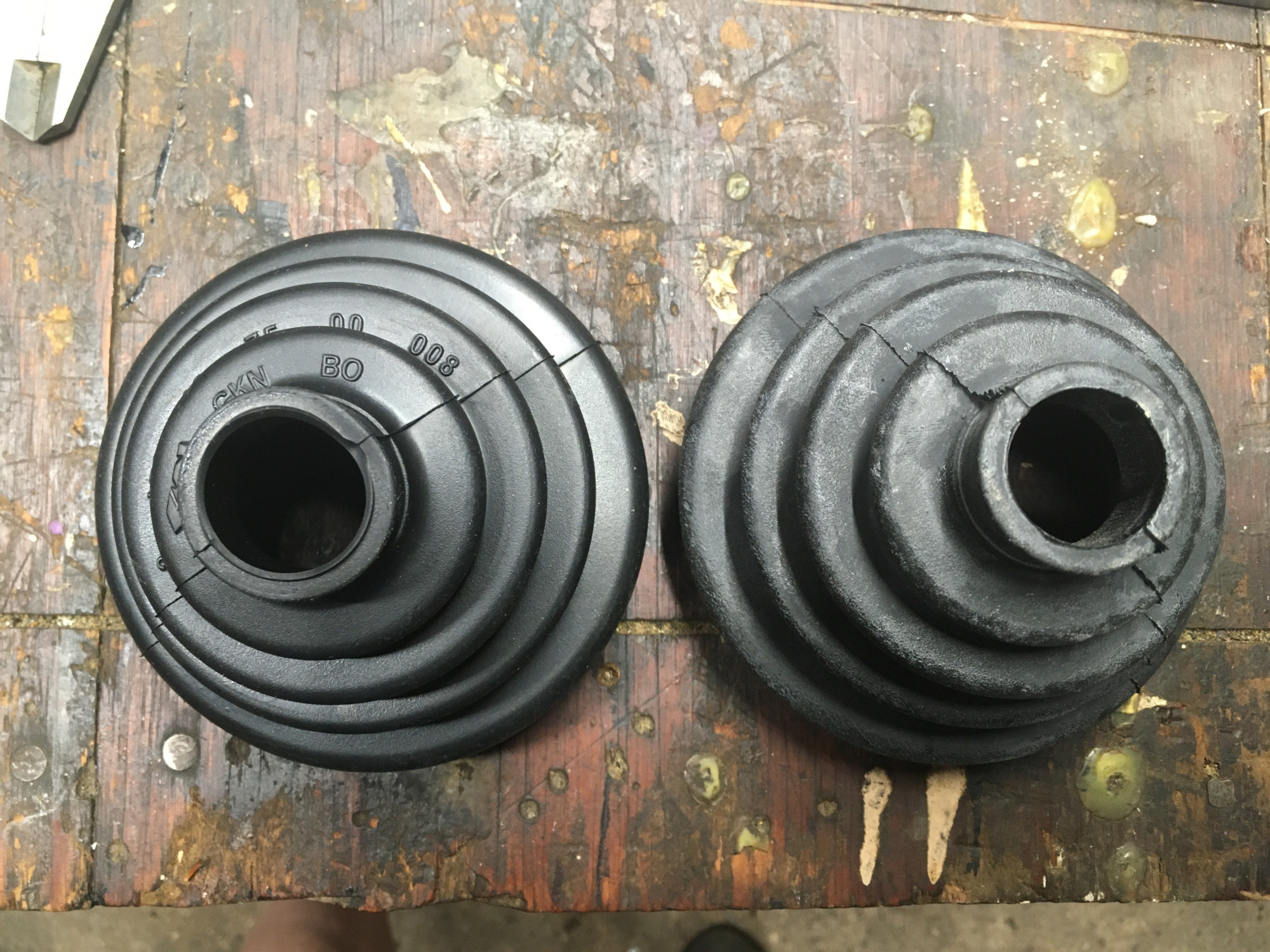

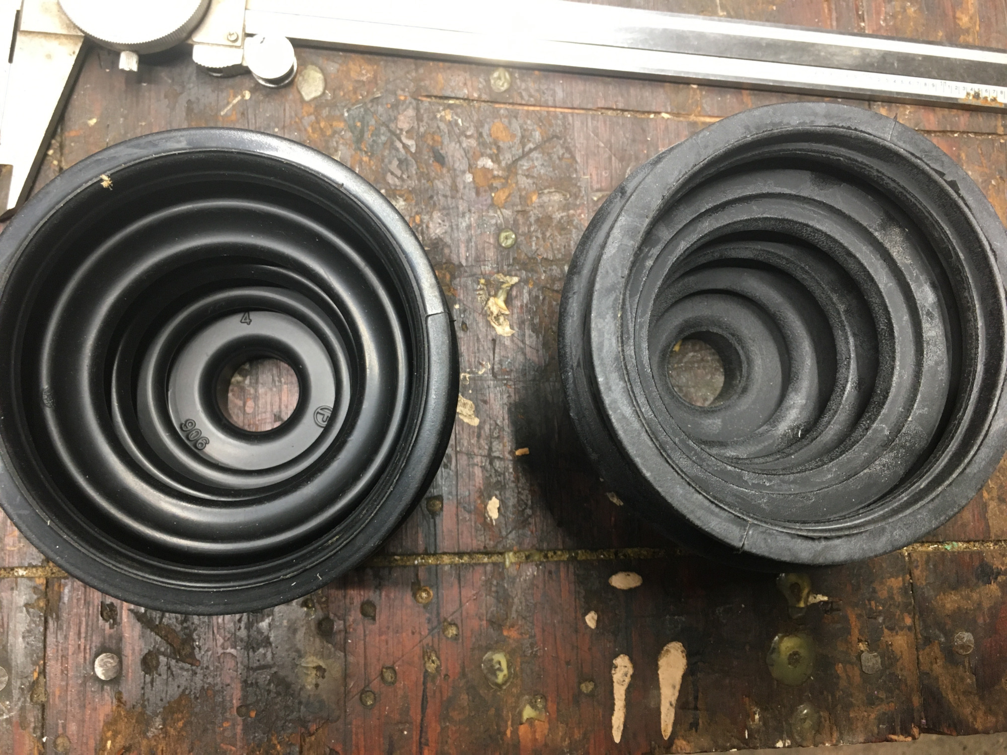

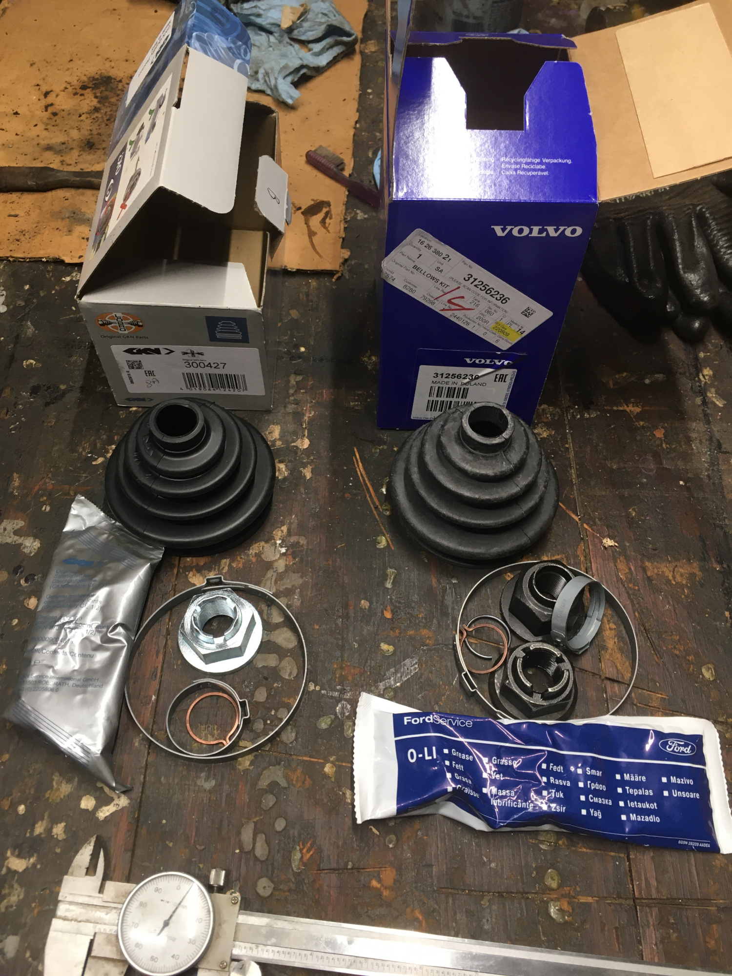

That's about how long the GKN brand boots usually last on my 850. I always keep a spare on the shelf. Currently I have a genuine Volvo one on hand as well which I bought out of curiosity, but it looks exactly the same for 4x the price. Subzero temperatures really take a toll on them. Sadly it doesn't seem possible to buy the ones the cars shipped with originally.
