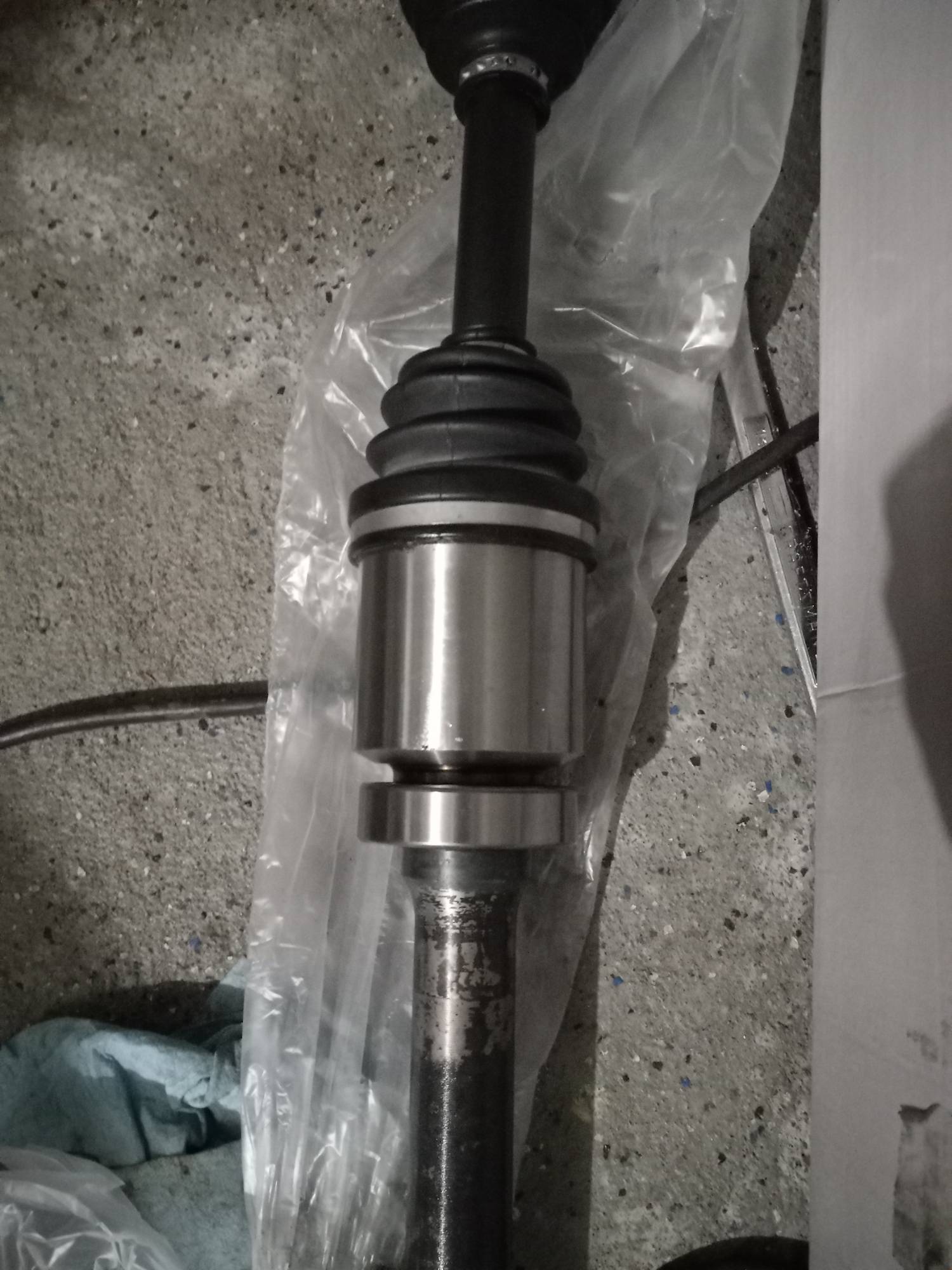

I already drove this thing several thousand miles with ripped boot so rebuilding axle is very questionable. And, already bought new axle from RockAuto (FCP wants $500 for new axle). My backup plan was to do a half-shaft replacement. However, it turns out that the new axle has a different style cv-joint outer casing (I don't know correct term), so new boot won't fit on old inner axle.

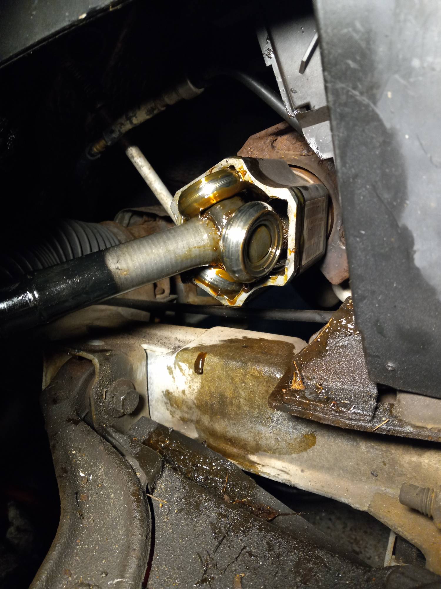

I decided to take the half shift off figuring it would be a good step forward for most ooptions. So, I cut the inner boot banding and tried to pull. It pulled a bit and got stuck. So, i tried to pull harder figuring either outer shaft or whole shaft would pop out. Well neither happened, outer shaft joint bound ip somewhere. So, i cut the inner boot off to take a look. Please see picture ... is this expected on P80s?? I have done P2s and toyotas, never had this issue. Also attached picture of new axle.

Looks like the inner CV joint is separating from the cup. I don't think it's suppose to do that without removing a clip first. Robert has a good video for how to take the axle apart. I "rebuilt" my outer boots with the axles still in the car. Should be fine to rebuild as long as the bearing aren't scored up.
Get between the axle and transmission with 2 apposing prybars. The 90degree heads work best. Apply force carefully to not crack the transmission case. They can be a royal PITA to get out. Probably should grab an axle seal and replace that while it's out. Don't want to regret not doing that (ask me how I know).

The tripod style will slide right out of the three groove cup, that’s normal. You have the other outer CV clear of the wheel bearing housing, right? Give the shaft a tap to get it clear of the half of the carrier bearing shell to make sure it isn’t sticking there. That’s happened to me.

I found an interesting youtube video about someone having the same problem getting tripod out of inner cup. He says that P80s have tabs at edge of cup that need ground off to remove tripod. I haven't seen that in the forum yet. It sounds like you are saying that you forced it past these tabs.

I have never ground tabs off to slide the tripod out. Have not ever heard that.
New boots on a cleaned and repacked axle beats Rock auto crap that lasts 6-12 months

I drove all winter on a torn boot and it cleaned up just fine. Would trust the Volvo axles way more than anything else.

Have you done enough of them (ie. say, more than once) to know that forcing them out won't damage bearings? If you have, I'll yank them out ignoring the tabs.abscate wrote: 02 Feb 2023, 04:21 I have never ground tabs off to slide the tripod out. Have not ever heard that.
Regarding rockauto crap that you/Whatamidoing note, I don't disagree with that. But I know that PO already replaced axles 60kmi ago. Don't have any idea what I am starting with (plus the extended driving on ripped boots) so thought that new might be less hassle (and I doubt that I will put more than 10k on this car) ... however, if I knew that my new axle cup would be different, I wouldn't have started down this approach. If I do replace using this 'crap' (already bought), I'll try to take current one apart anyhow and save it if it looks salvageable.
