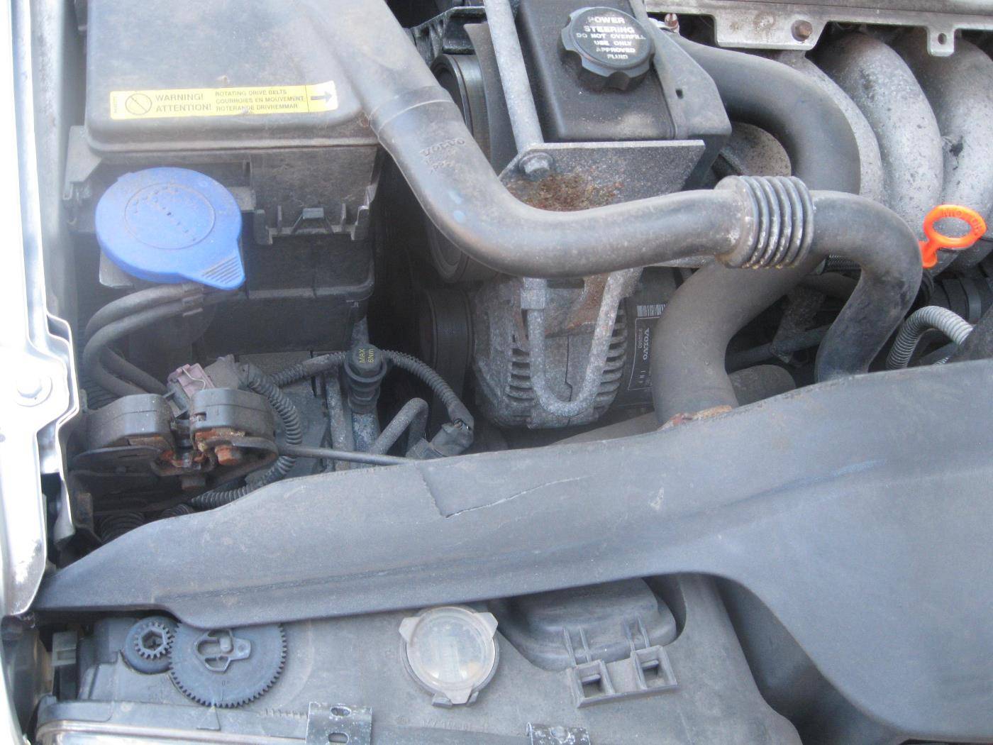

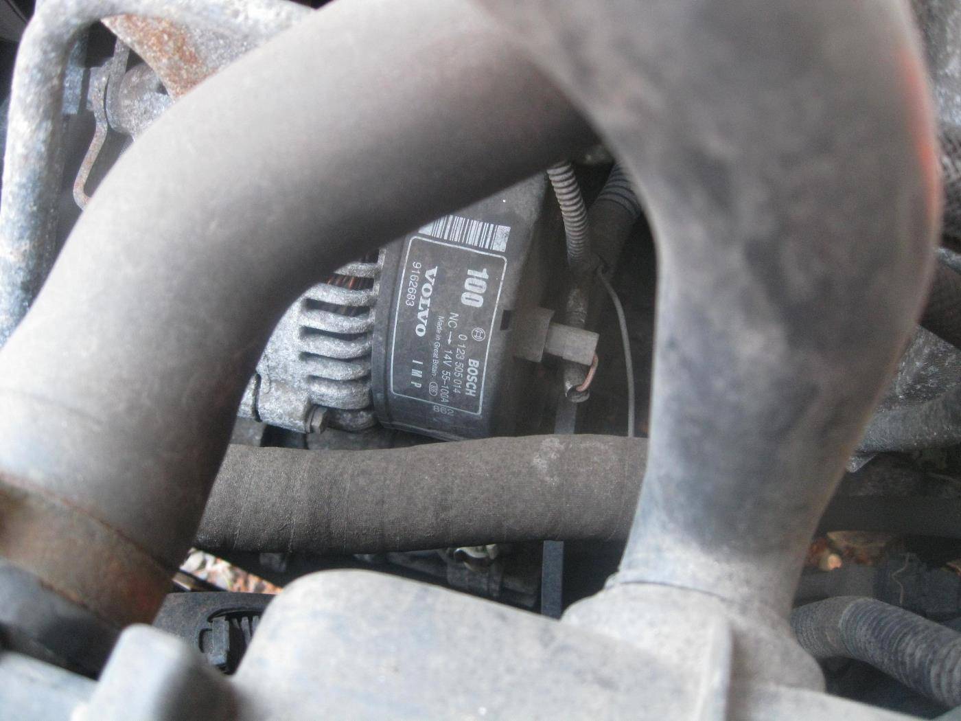

Hey i'll check mine too. Maybe i have a semi bad wire (higher resistance than normal).
I had several alternators go on my old Hyundai. After replacing the ground connection has to be tight.
I really think they should use four wire power and sense. Maybe they are afraid if the sense wires get broken the alternator will fry the battery, but with all the other gadgets i would think they could have a fail safe and indicator light for that.
If i had my way i would install such a setup, but i cant seem to get to my alternator. It's really buried (see pics).
Dont know what all the terminals are for either.
