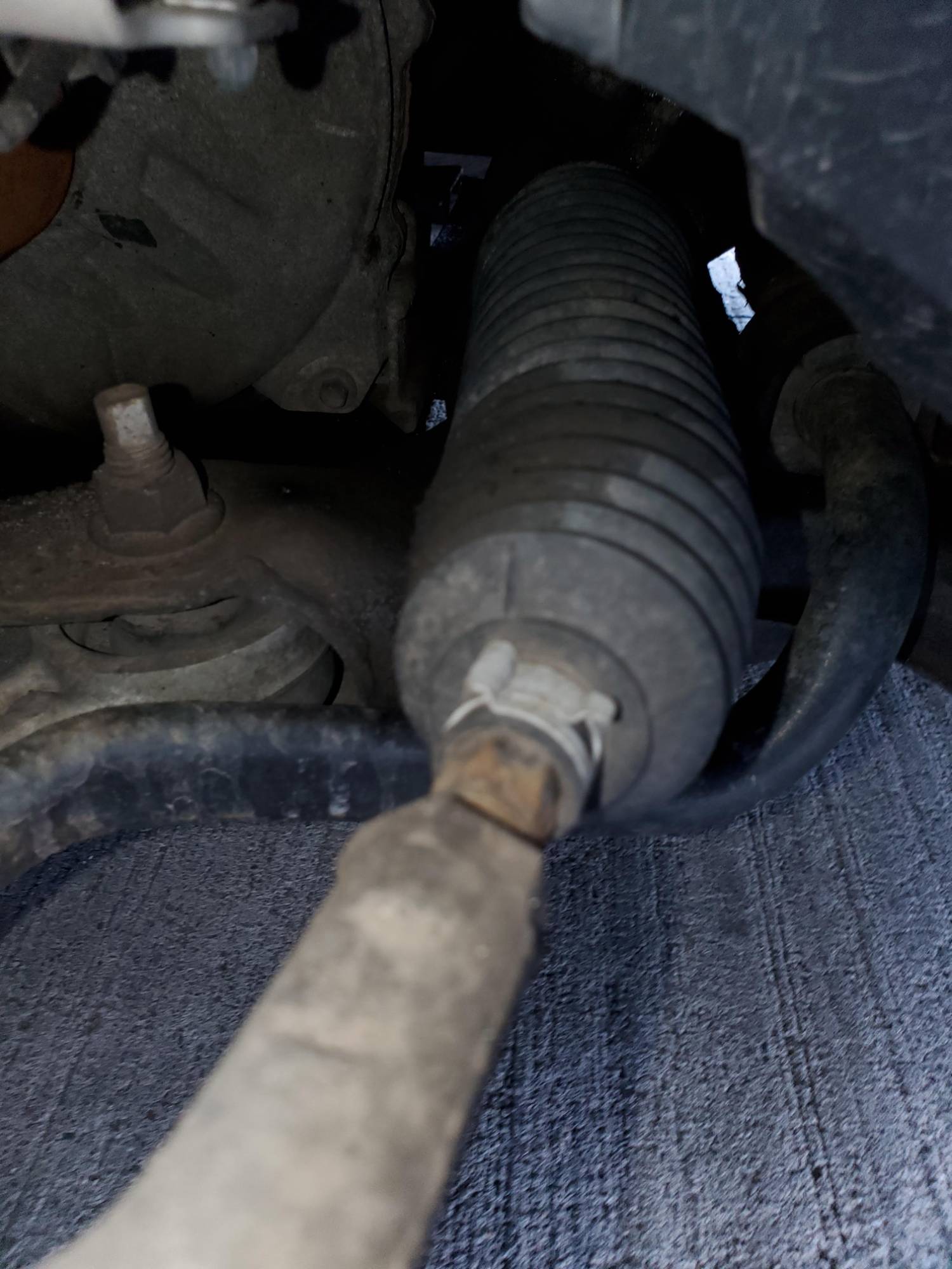

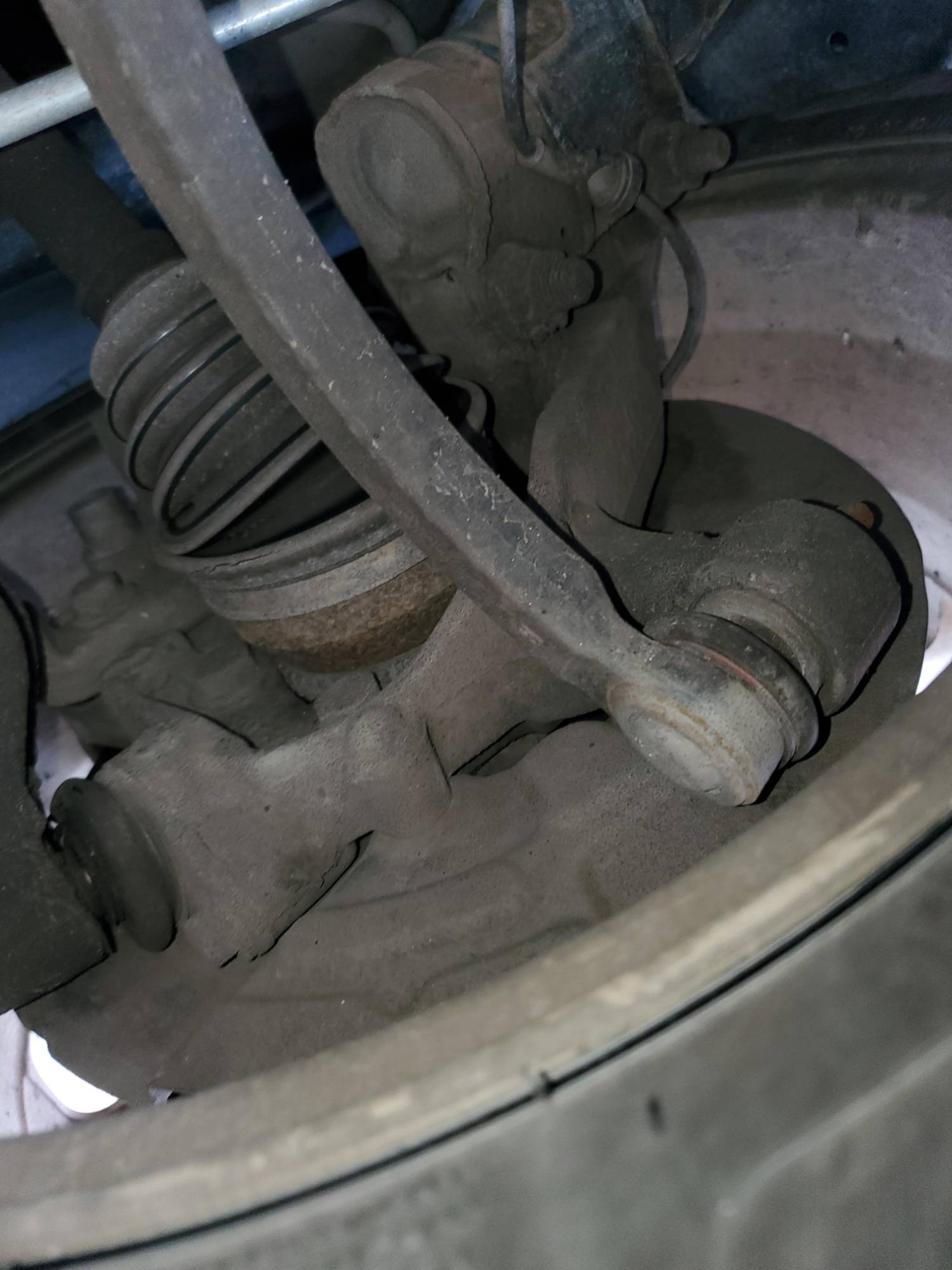

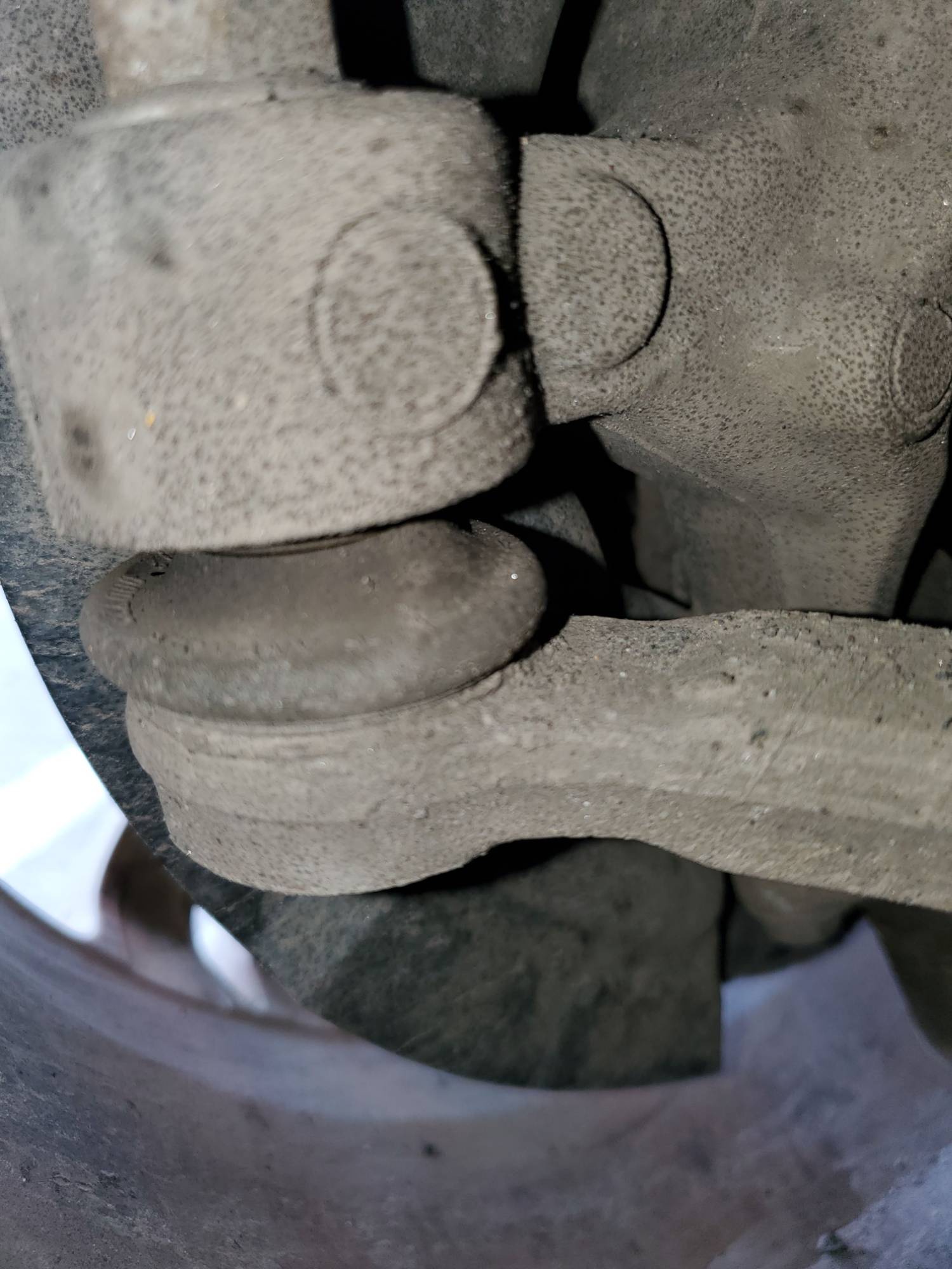

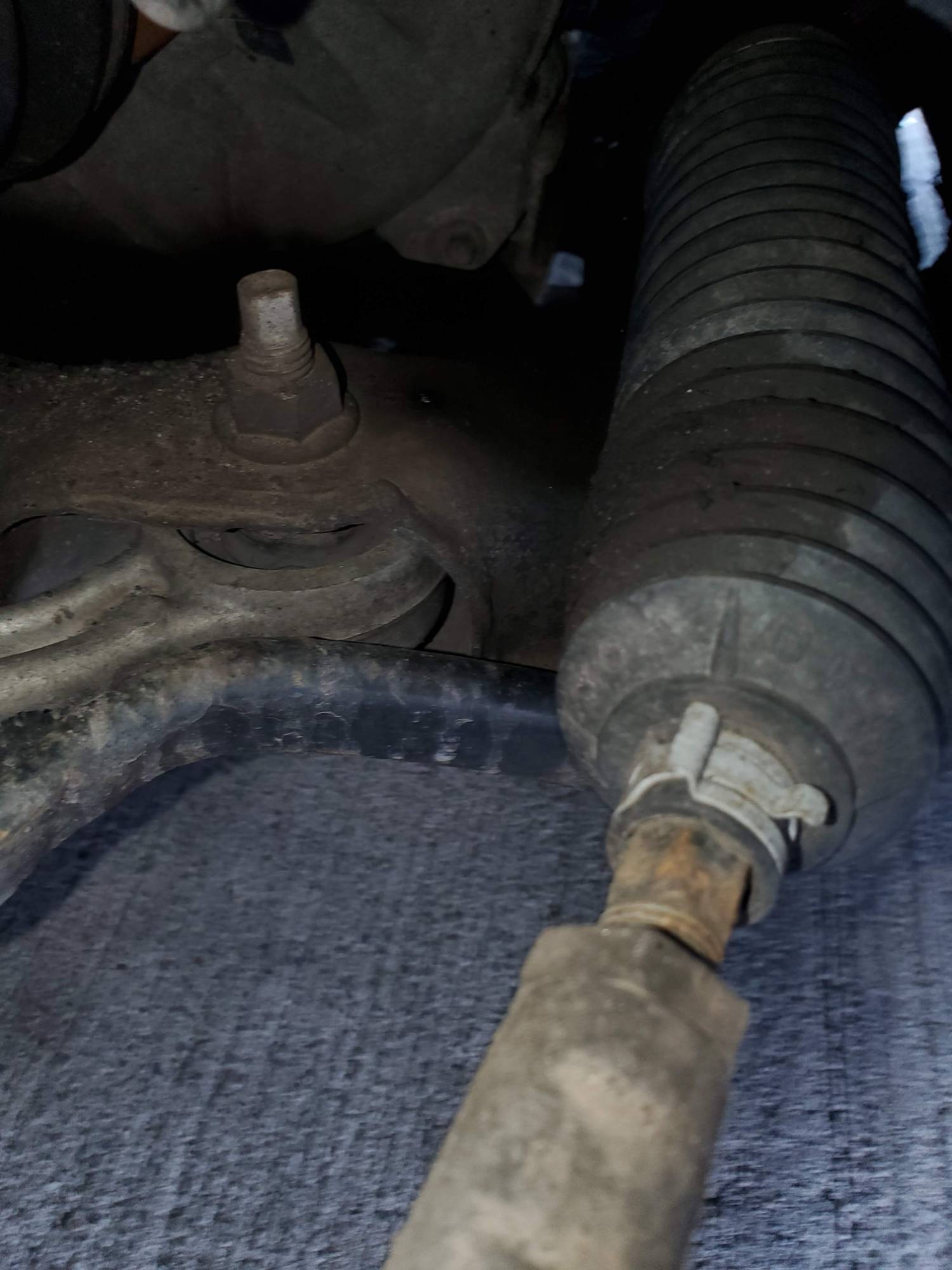

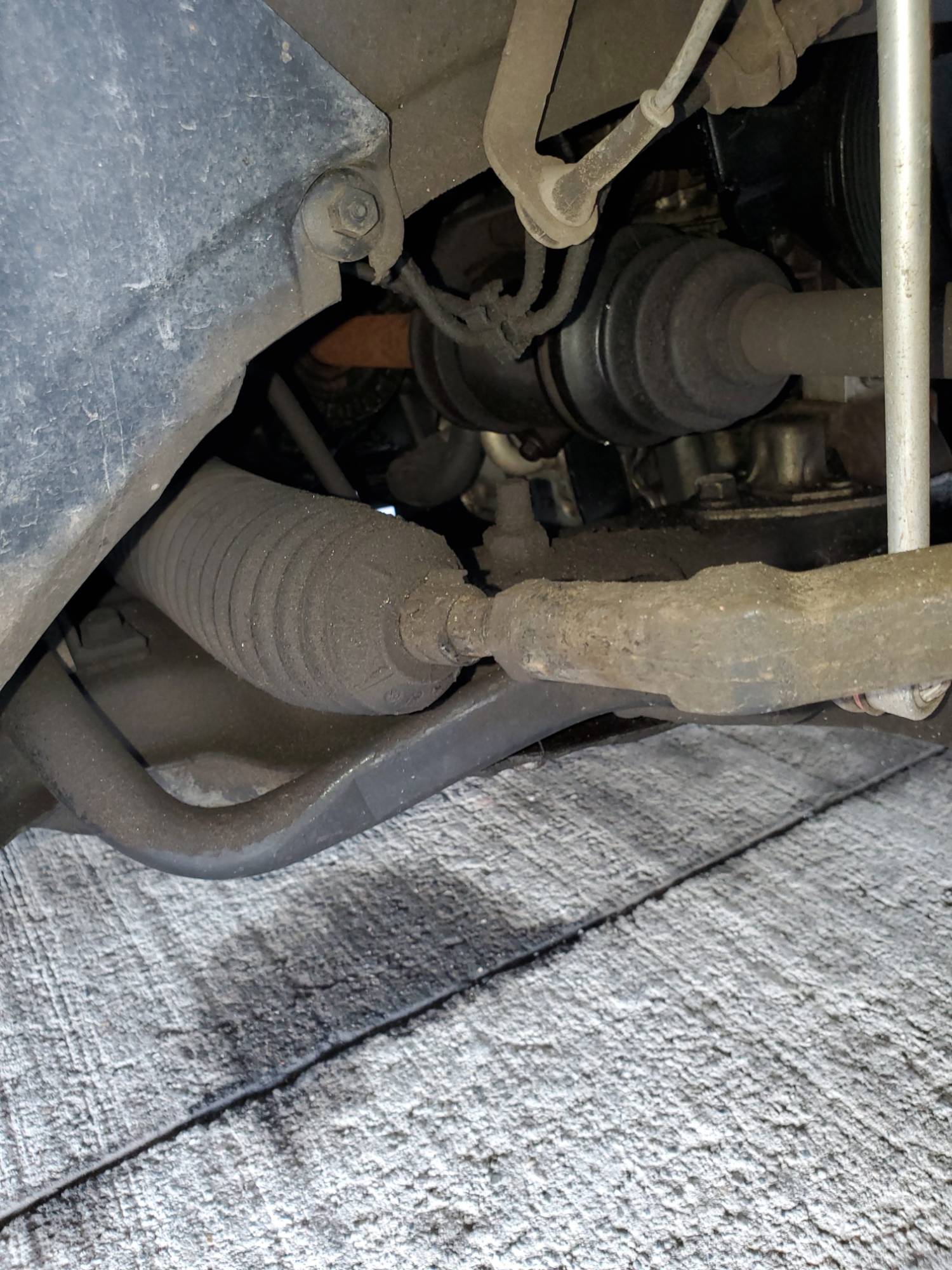

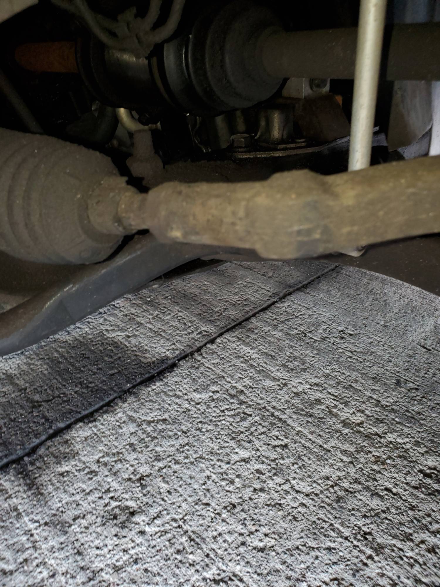

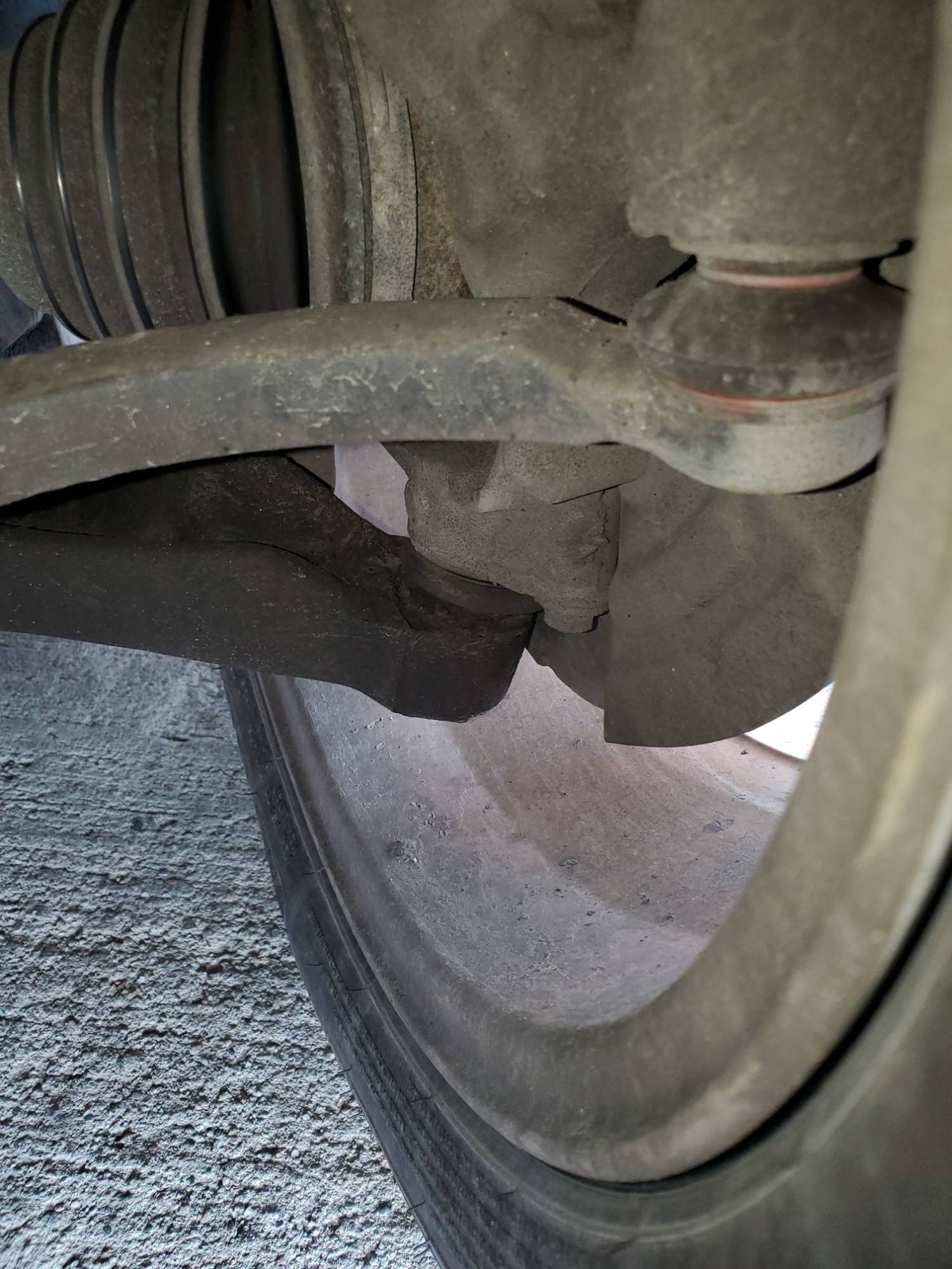

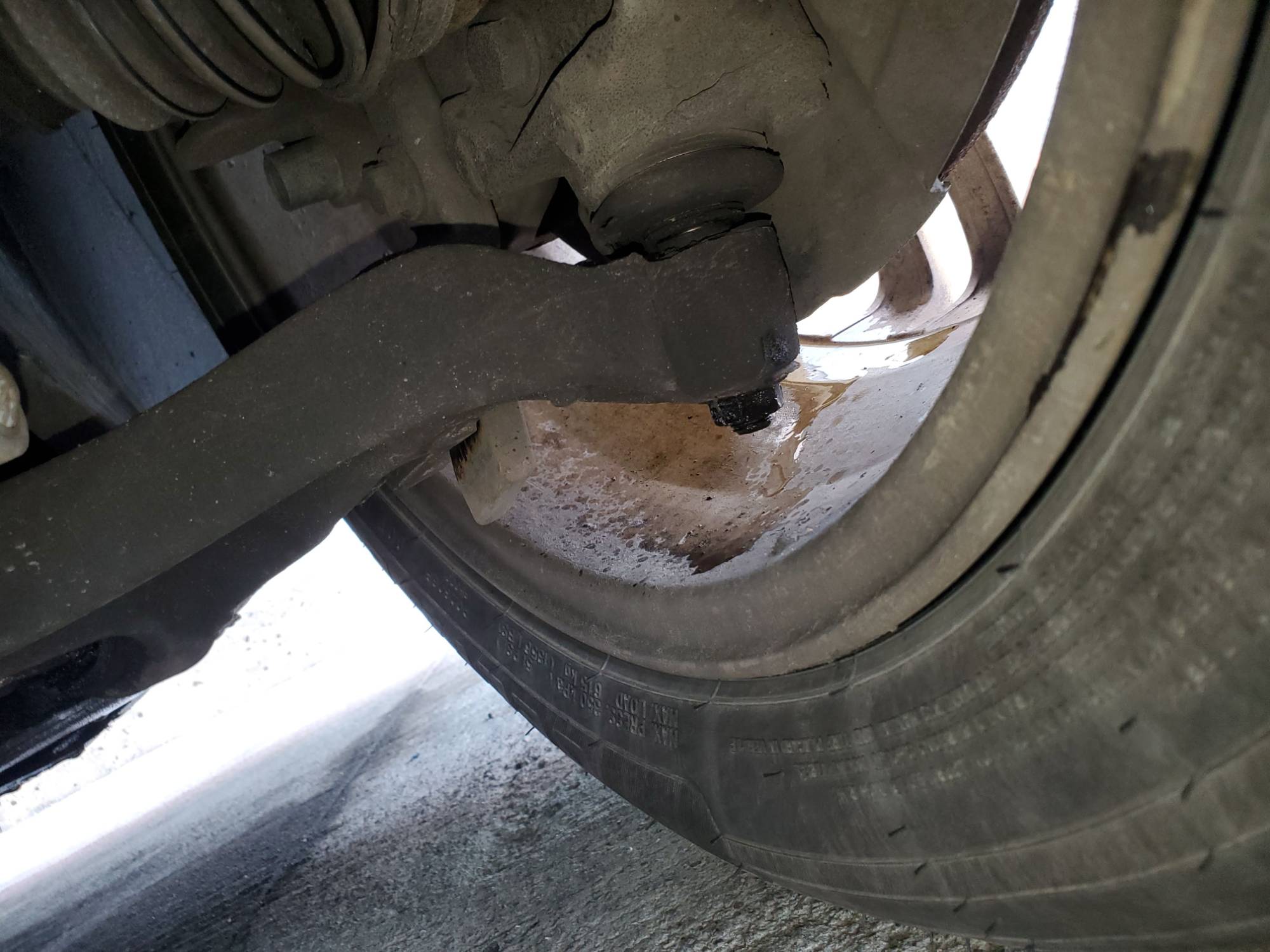

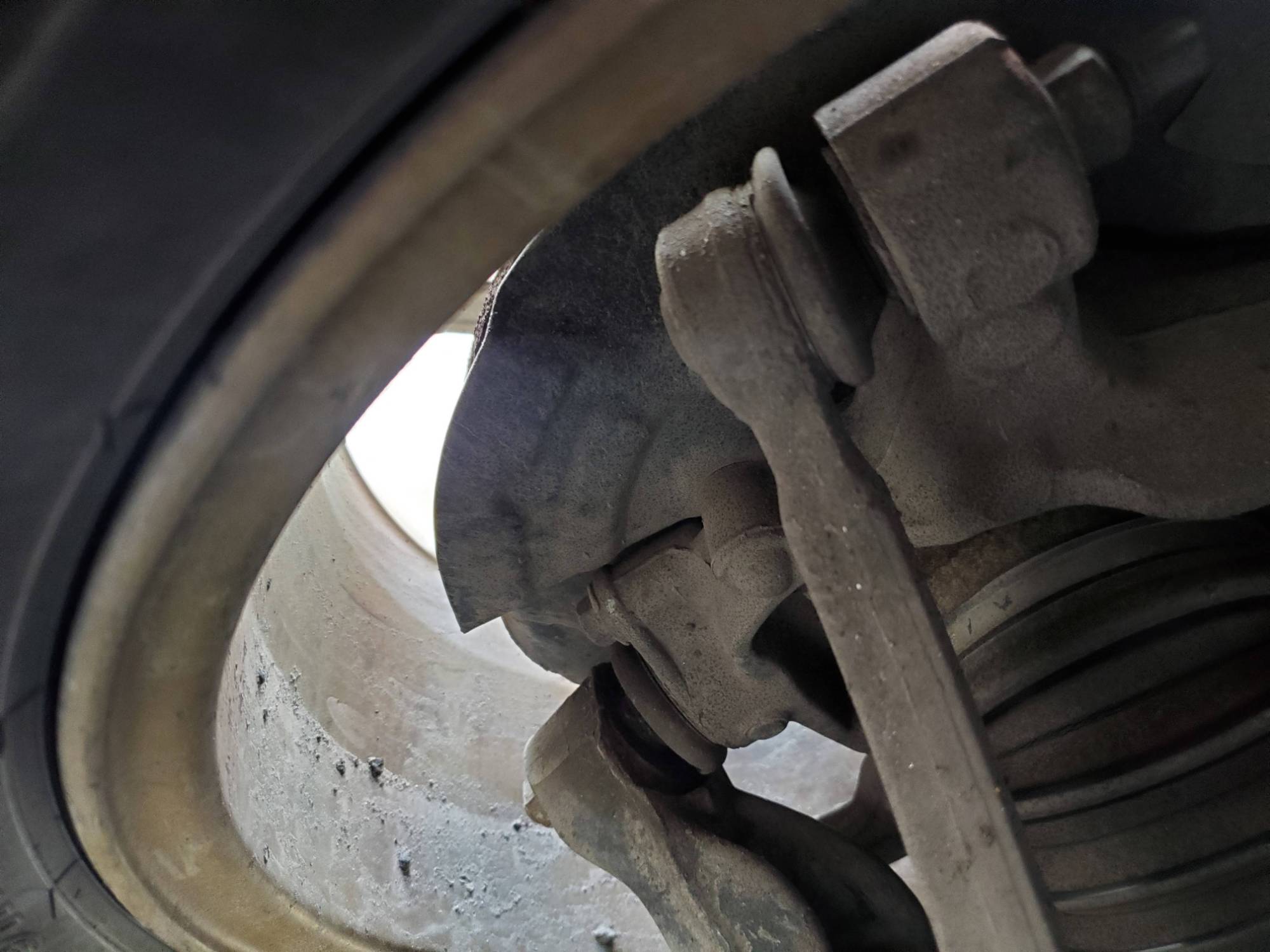

Thank you so much everybody. Here are some pictures I took. I'm sorry if the focus is off on some of them. I'll take some better pictures if you guys don't like these ones.
