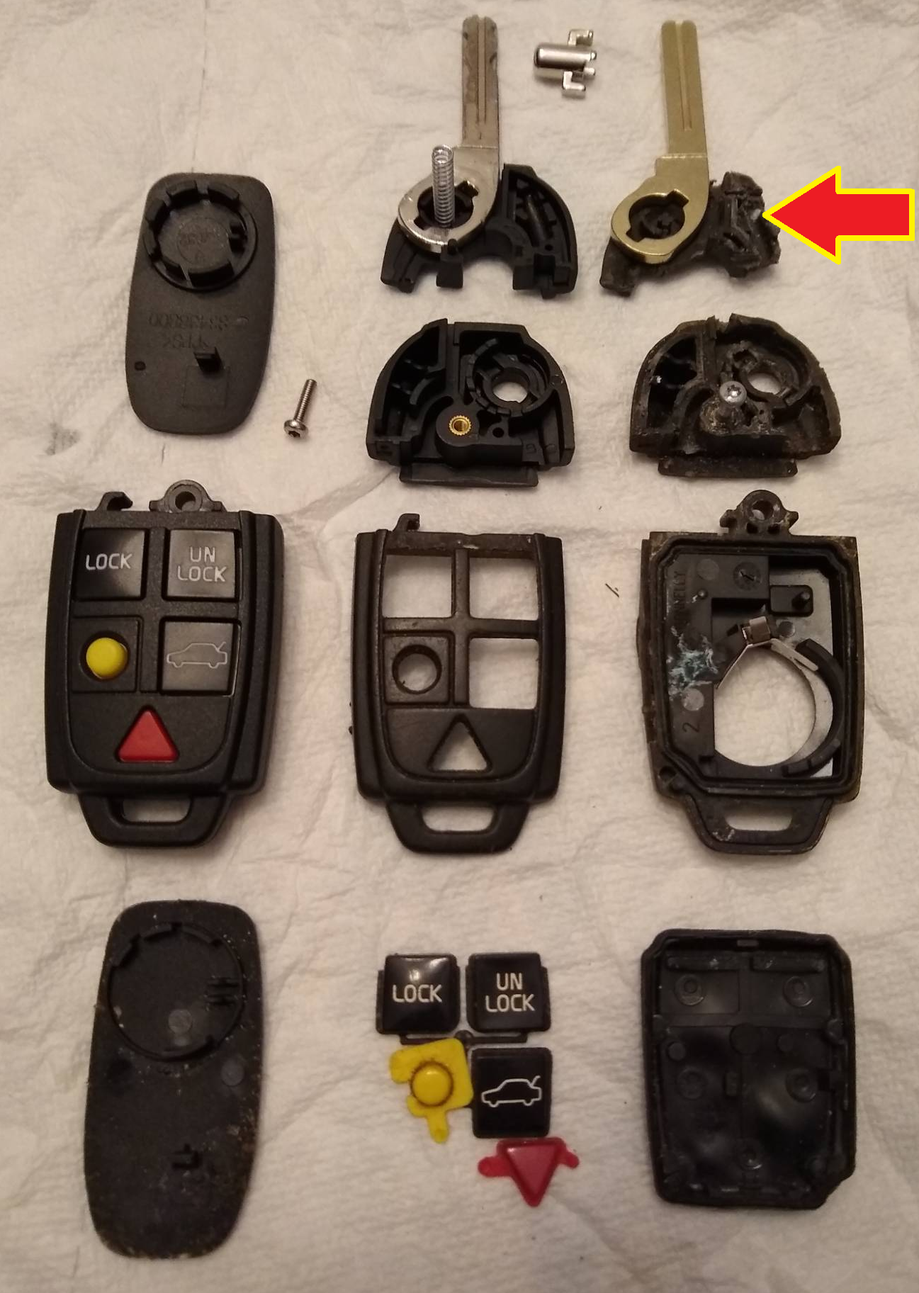

I'm wondering if the guts can be swapped into the new key shell like that of my 2007 S60 2.5T? Arrow indicates where the old glass trandponder was located. Have to be careful when cuting it out. Can also use sandpaper initially to sand away large portions of the plastic, in hind sight

As in this thread- viewtopic.php?p=144896 , assumes you have a functional switchblade key and can swap out the transponder to a new shell.

.ggleavitt wrote: 22 Feb 2023, 09:55 As in this thread- viewtopic.php?p=144896 , assumes you have a functional switchblade key and can swap out the transponder to a new shell.
Thanks, much nicer and more detailed write up!
