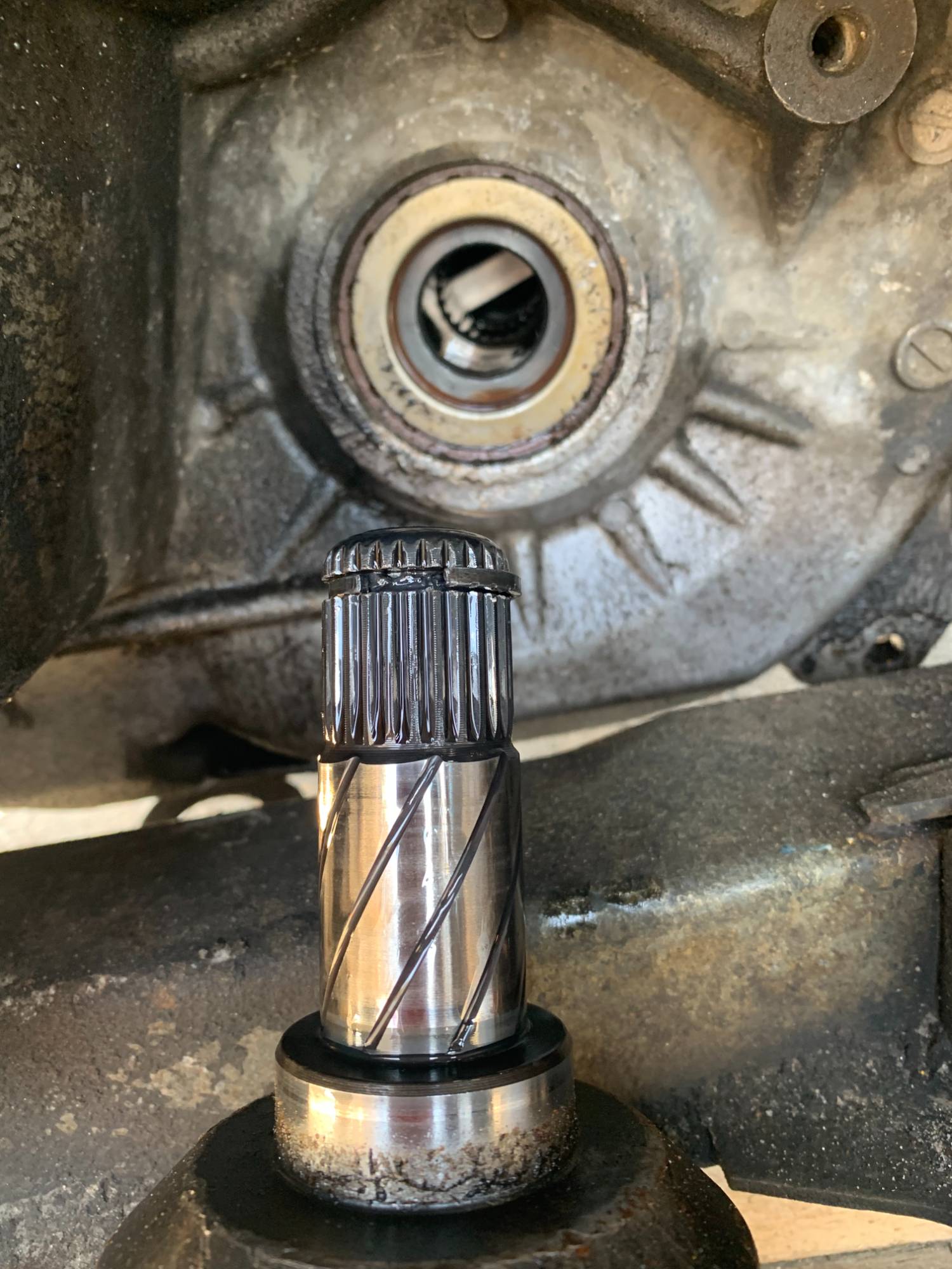

I ended up having to remove the tire, loosen and remove the control arms bolts, and remove the axle nut. The axle was tough to extract but eventually got it out. There did not seem to be anything wrong with the circlip, but when I reinstalled the axle, it would only go in so far. There is still a gap between the transmission housing and the large circular part of the axle that is below the threads. It does not seem to want to go in any further. Makes me wonder if the seal is too far in the housing or that the seal needs to be replaced (installed this new seal about 3 years ago)....Any thoughts?
I'll post some pictures.

Is this an original Volvo axle or aftermarket? If aftermarket it is likely the issue with the shape of the circlip to hold the axle in the transmission as I suggested before. You may be able to force it in as long as you hope to never have to remove it again! Otherwise get a Volvo circlip for the axle.
Unless you nicked the axle seal, it is probably ok. Check for damage around the seating area of the seal.

These pic files are way to large, but I am a bit challenged in figuring out how to make them smaller!

The width of the gap in 2nd pic is about the same as it was before removing the axle.

- Posts: 36148
That gap looks ok.
